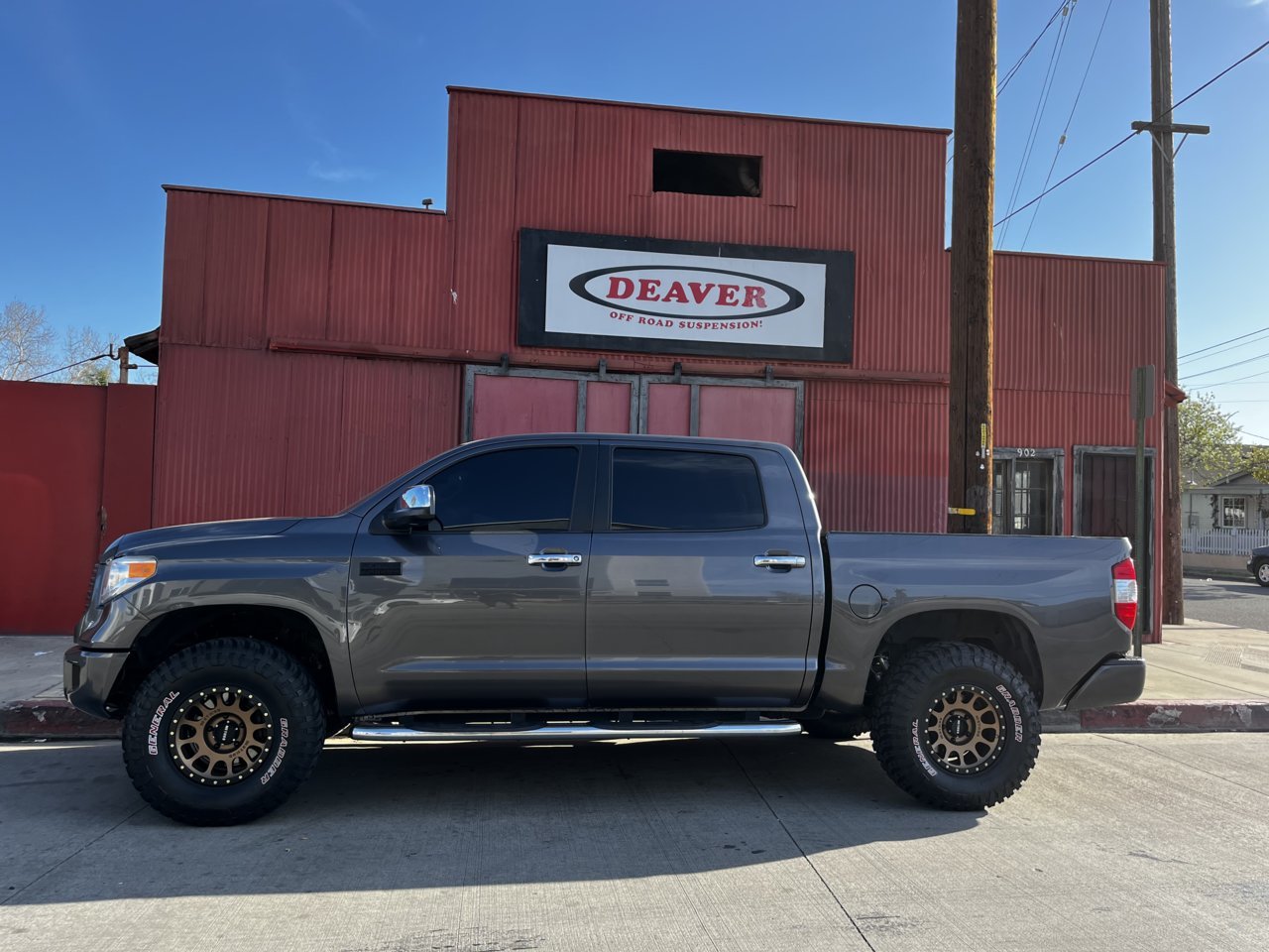

    So today I had K37 deaver springs put on my crewmax. There has been much debate over the threads I have read especially some that stated that the k37s actually lowered their rear end. I spoke with Jim at deaver and he recommended that I run the K37 but modified because I couldn’t afford to lower due to having 35 tires just installed. I also bought the Total Chaos shackles to pair with the springs And Bilstein 5100 1.5 lift w/reservoirs. I was told because I’m not hauling 500+ lbs a day in my bed this was the preferred springs to get (occasionally tow a trailer to go camping a few times a year) they installed and modified my springs so they sat perfectly with my Bilstein 5100 on the top setting in the front. So far the ride is great and I even went through a little dirt whoop section to try it out. So far no issues and no rubbing/squeaking of anything. Here’s a photo for the rest of you thinking of running something similar.

    Some say my U748s will sit that low…. They’re still nearly +4” from stock, and I have a canopy, bedslide, Dometic fridge, and a tote that weighs about 50# in the bed 100% of the time…. They’ll settle, but taking a long time! Yours looks great. Wonder where they’ll eventually sit.

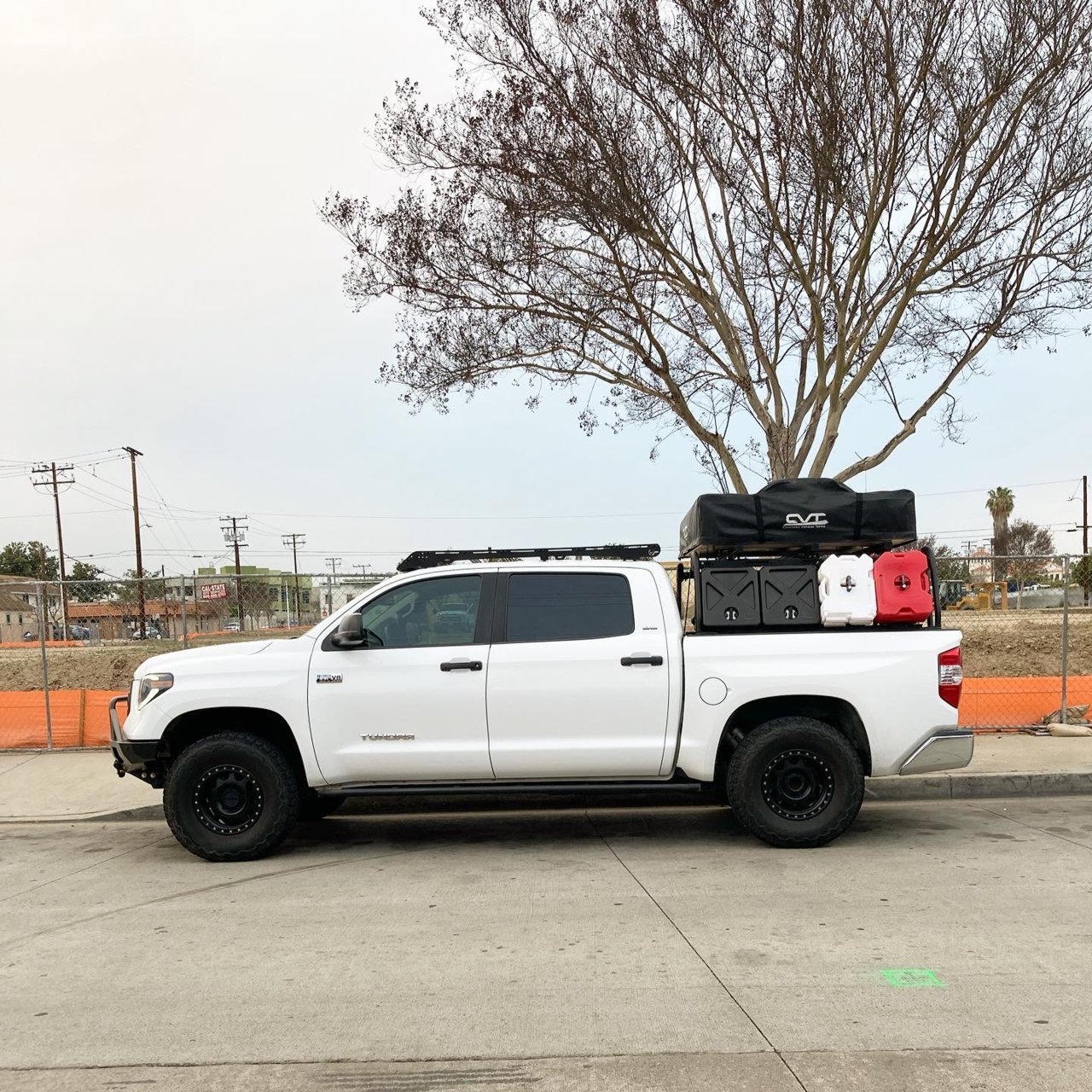

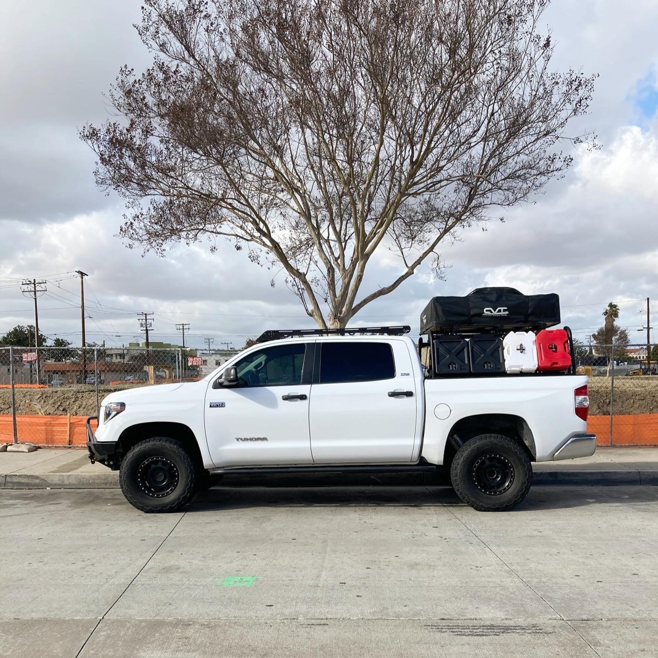

    Here is a before and after for reference. This was before my bumper install
    4B703819-5FE9-480E-8CE0-EF72D9C93AD3.jpg 3D9F2EC2-2A8D-445B-A485-C186DB9C6883.jpg 5CA76674-B302-4CED-BB5D-52DC293EFD39.jpg
