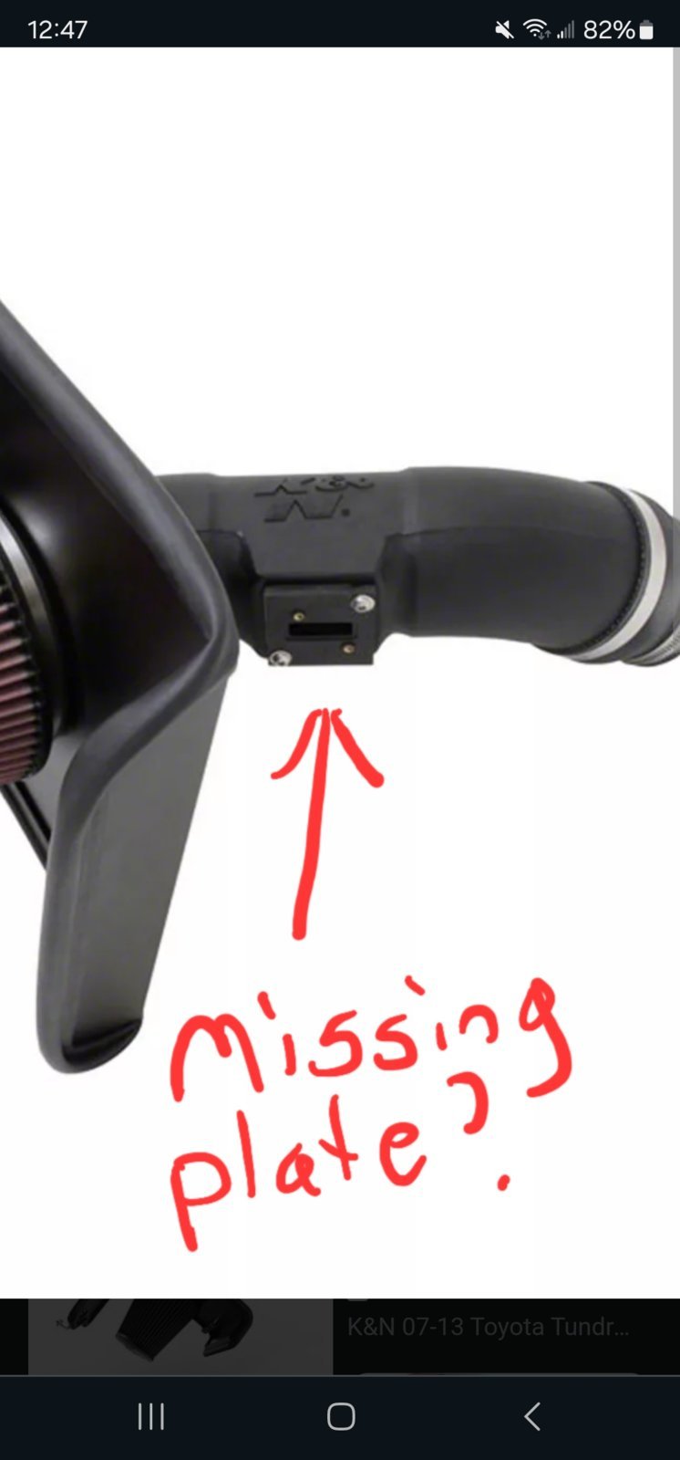

    I recently purchased a 17 Platinum. Truck is in amazing condition accept for this lovely engineering job that was done on the K&N. Can someone please tell me what is missing and where to get the part?

    One of 2 things is wrong. It is either the MAF sensor is wrong or that is the wrong K&N kit. The sensor is supposed to align and mount where the 2 brass screw inserts are.

    I believe this will give you the part numbers that you need, but not sure if they will sell you them separately. I would be very wary of running your truck that way long term. The MAF's can get pretty sensitive and cause some issues.
    https://kandn.com/instructions/63-9036_inst.pdf

    Might be a missing mount plate.

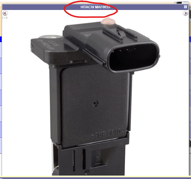

    He has the wrong kit. MAF is the correct part number

    I called K&N. It was $7 adaptor that is missing. adaptor + screws + shipping = $13
    Thank you all for your input.
