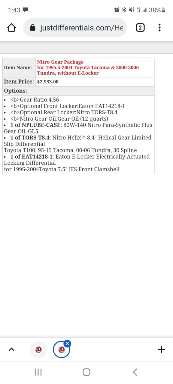

    Hey guys,
    'Bout to make an order from these guys, just reaching out if anyone has/knows of active coupon codes at the moment.

    Just hitting their home page, in the lower left corner there's a link for 5% off if you give them your email.
    Outside of that, I'm not finding anything worthwhile from my usual sources.

    Sweeeeeeet. Hit them up and ask about solid collar upgrades. Its cheap, stronger, and your install guy will thank you.
    Usually kits come with a collapsing collar. If your guy gets the shims dead right first try thats okay, but if he is off at all he has to recalculate when the collar crushes. Solid collars let them have a constant to work with. :thumbsup:
    You're gonna like 4.56

    Awesome thankyou for taking the time to check
    Awesome thanks for the recommendation! I guess I'll just call them than to make sure to get that part as well
