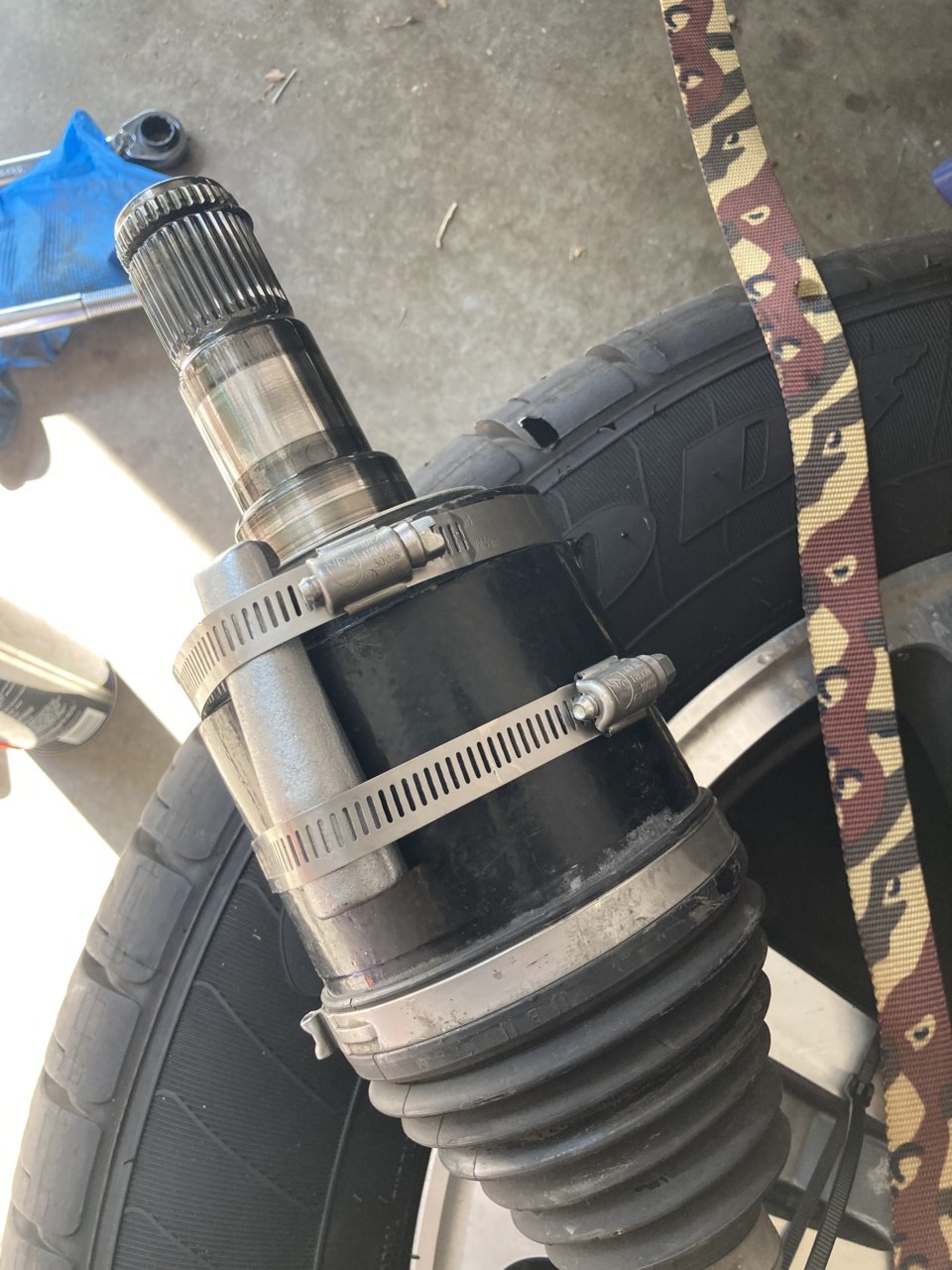

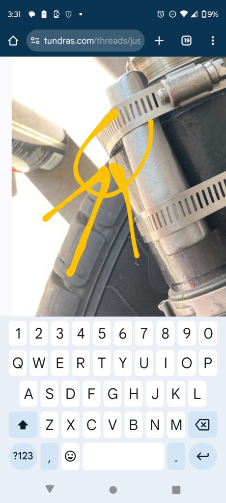

    I don't think 4WD should be engaged when removing the CV. Also, a 5lb slide hammer is your friend to remove the CV. The CV has the perfect lip to fit a hose clamp around the CV and lock down a hook attachment.

    The hose clamps look like a very good idea. I'm getting ready to complete the ECGS bushing install / needle bearing delete on the driver side, so I actually just bought a slide hammer - I think I'll try this trick - thanks!

    Wish I could take credit for the idea, but I saw a Tacoma owner use that trick for removing his.
    I pounded and pried my CV for what felt like an eternity, then went and got this slide hammer and hose clamps. Had it off in like 5 hits with the slide hammer. I was laughing hysterically after and my wife thought I lost my mind (I did, stuck CVs do that to you).
