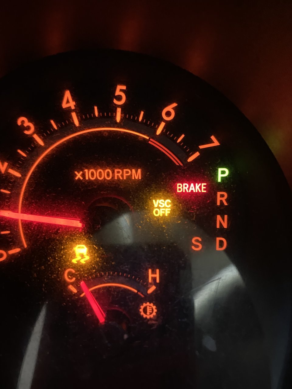

    1CA4D99E-CD29-4C9C-9A5E-1A0CE155459C.jpg These ones as well

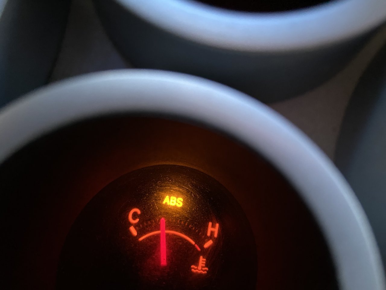

    9DAFF9DE-EF7E-4B85-8BC1-B1A4221F86FF.jpg Also

    well if the 4hi is on (sure you aren't actually in 4hi mode) it will kick the VSC and TRAC lights on. the ABS may be a different story. Did it work fine till this morning or was it like this picking it up front getting the lift done?

    It was like this when I picked it up from the shop now they’re saying it is the ABS sensor

    No it’s still in 2wheel setting and when I put it in 4wheel lo it starts peeping

    They might have damaged the ABS sensor or more likely the wiring, which can cause all or most of those lights to be triggered. The ABS sensor and wires are right there where they had to work to install the lift. Hopefully it is an easy fix.

    Second this. This happened to me with my 4runner.
    Run codes - if it says left or right abs failed startup I would bet its a damaged abs wire.

    I wouldn’t wait. Your truck has ABS disabled and they messed up. I would go to the shop and make them fix it
