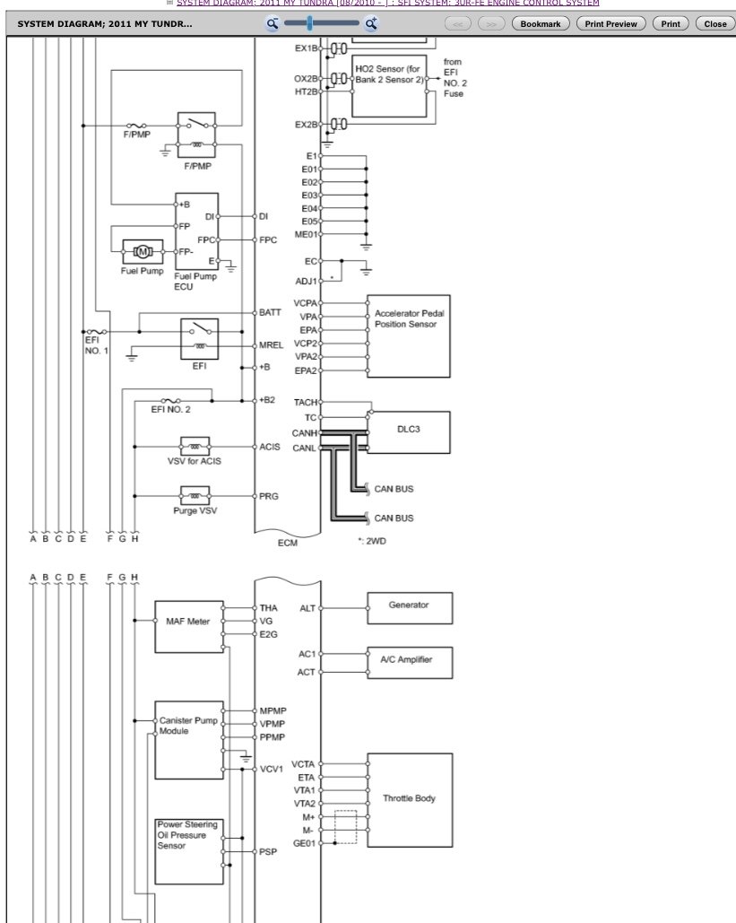

    I’ve just completed a engine install on my 2011 tundra. I pre oiled and cranked briefly. Installed plugs and attempted to start. Cranked but no start. Disconnected one fuel rail, cranked but no fuel. Did not hear fuel pump run either.
    Did not have this problem before the engine change.
    I will start looking at this challenge tomorrow, all suggestions welcome.

    Does any one have a site to direct me to a wiring diagram for the 2011 tundra?
    Thank you to all for each suggestion.

    I can help with wiring tell me what you need and I will see if it’s available

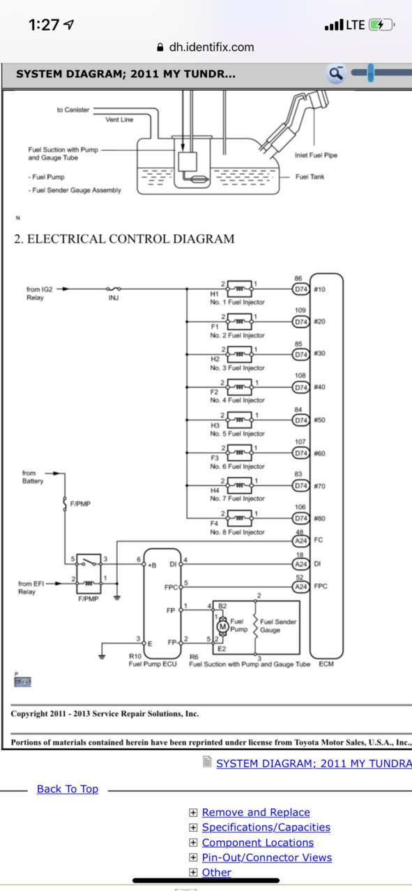

    Check the fuel pump relay. If it’s turning on then it’s something between the relay and the pump. If it isn’t, then it’s something before the ecu, or at the ecu.
    You can jump the fuel pump relay and see if it pumps fuel to eliminate wiring issues between the two.

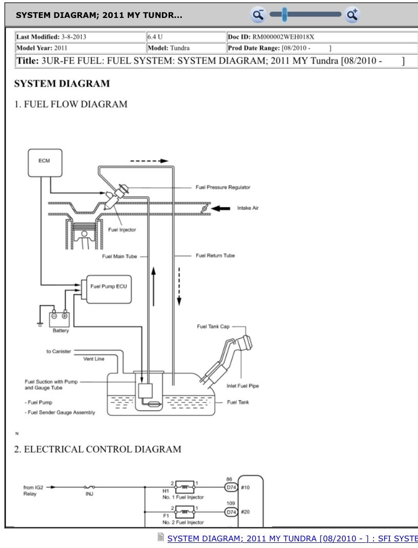

    After dropping the tank and power applied to pump, found pump to to be operational. Reinstalled tank found pump operates only when engine is being cranked. Does not run when in run or on mode.
