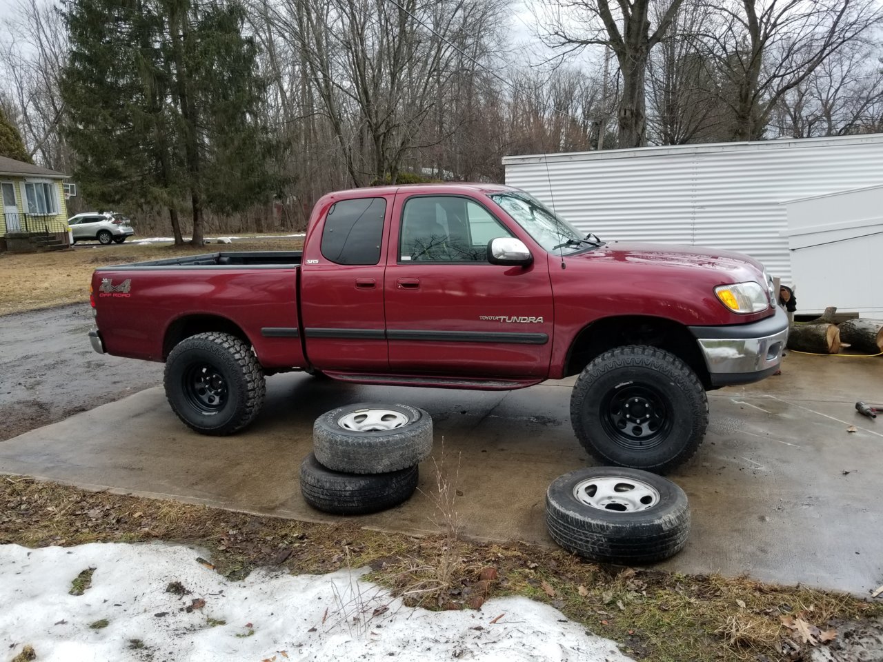

    V6 4x4 3" spacers front 2" block Put the front in and test drive fine. Installed blocks and now squeals under light acceleration only. From reading here I didnt think I needed a diff drop? Or just that slight lift was enough to finish off my carrier? 20200111_135459.jpg

    You might have to do a diff drop, cv axle angle can get too steep

    One piece drive shaft might help?

    160k , just bought it so age of carrier and u joints unknown. They are cheap enough. Guess it's back to the parts store lol
