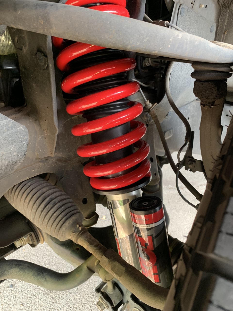

    Truck is dirty but here you go92477262-10AA-439A-96ED-DF6E7E905E39.jpgF0C3CC17-98CB-4DA6-8E05-5DBFEAA1A794.jpg

    Same height after install as the spacers that you took out?

    I didn’t do any measuring but it did drop about an inch.

    Amazing.... To be clear this lifts a stock truck about "2 in on the front...right? And the rear you found what level;same or a bit higher than stock?

    Yes front is approx 2” higher. The rear stayed the same since I only changed the shocks.
