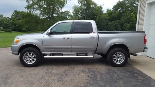

    The 2006 Darrell Waltrip Edition came with 18 x 9 BBS wheels, P275/55R18 tire size.2006-toyota-tundra-crew-cab-darrell-waltrip-edition-1.jpg

    Well that gives me hope. A 275/65r18 would probably work. Its just tough because I would need to get adapters for it and cant really test fit them.
