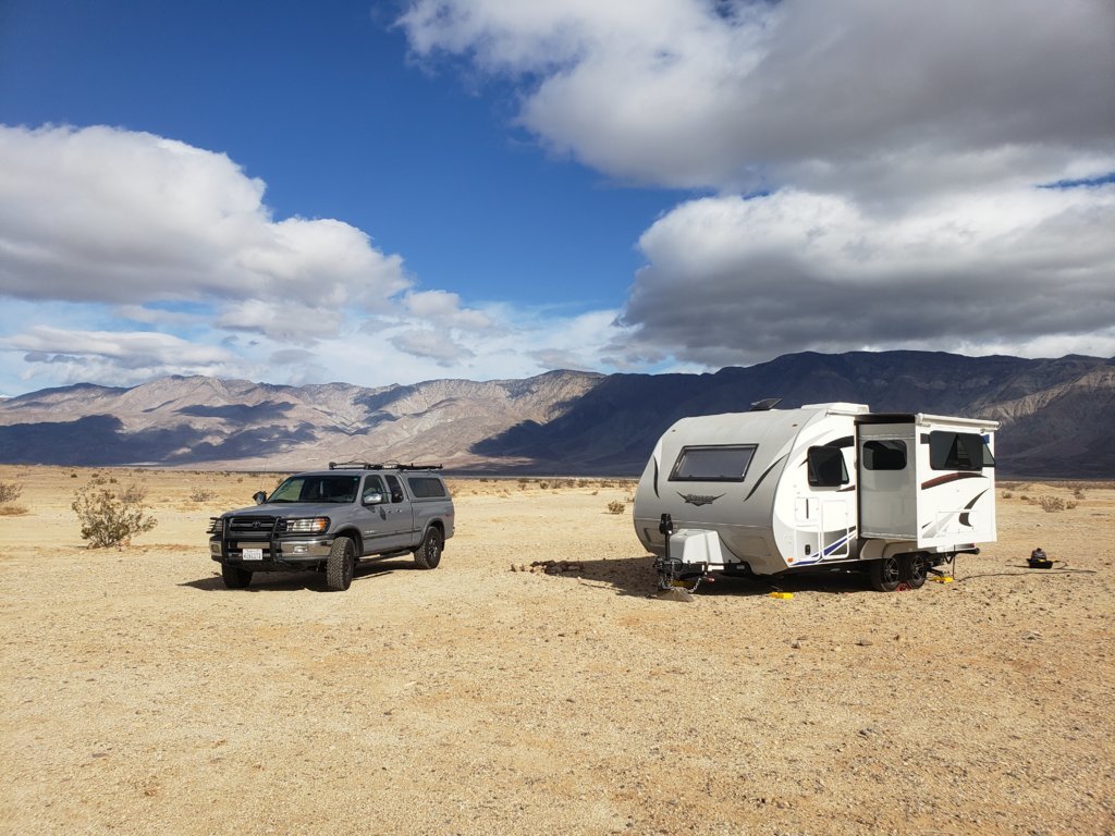

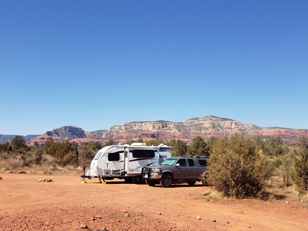

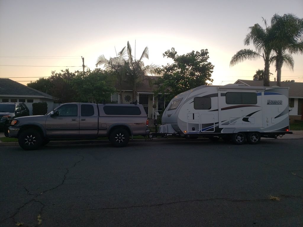

    Ruh Roh.
    Well there's the source of one of the problems!
    O/D off (button on the end of the shifter, and yes it's in the manual) and keep RPM's up around 3K-3,200.
    When towing with my '00 1st gen w/4.7 I drove more by the tach than the speedometer.
    WDH will make the 2 objects hooked together and sometimes bouncing in opposite directions feel more like one cohesive unit.
    Not the fastest up a long grade, but I towed my 5,500 lb. travel trailer with the 4.7 for 6 years and it did everything I asked of it.
