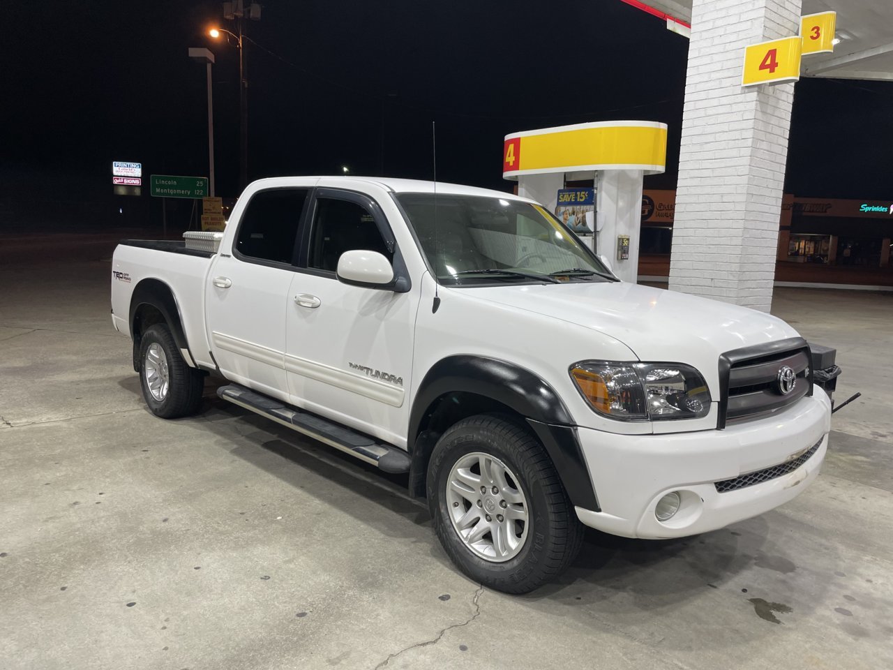

    Found a listing for this last night and went to get it. 2005 Toyota Tundra Limited Double Cab TRD 4x4 with one owner and 99,000 miles. It was kept in great shape and the price was $15k. The truck sat for about a year but they kept the oil changed and cranked it every so often. I have a couple questions:
    • Maintenance - I am expecting to do a tune-up on this truck since I don't know what has been done in the past. Thinking timing belt, water pump, idler pulleys, hoses, serpentine belt etc. Anything else I should be thinking about?
    • Cosmetic - The previous owner painted the white fender flares black and I don't care for the look. Should I try to buy new ones or order some original white paint and repaint them? I also think I want to level the truck and get a little big bigger tires but nothing crazy.
    Any thoughts or other suggestions? Will post a picture below. Thanks!

    Pics of the truck

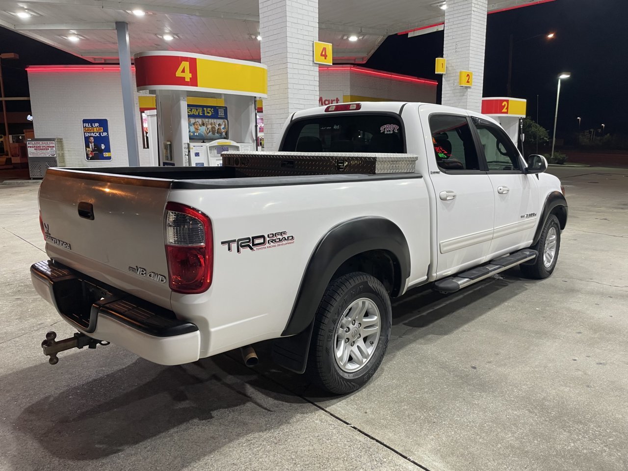

    Pic 2

    Welcome aboard, it sounds like you got yourself a nice find! That fender job from the previous owner is... something.
    I would definitely hit everything you mentioned for maintenance. You'll want to do the lower ball joints and replace with OEM, those are nasty and can screw up other parts too when they fail.

    Nice looking truck
    I think you are heading down the right path on the maintenance items - then you will know exactly where you stand with the truck - add a fresh oil/filter change
    I agree, I so not care for the black fender flairs either, some may but just not my thing either. I would get some original color match paint and paint them if it was me.

    Bruh, u need some 0 offset rims to go with those fender flares

    Plan to do CV boots if you level it. I'm with you on the flares. I like the white on white trucks. Maybe check your trans cooler line where it connects to the radiator and do a search for "pink milkshake" for pointers there. It seems fairly common the inner portion of that trans line fails and you get coolant and transmission fluid mixing. Not good.

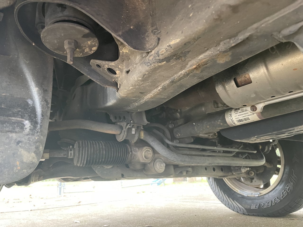

    Agreed on the timing belt. I didn't drive it to work today for that very reason. I drove it home and don't want to move it until I lay eyes on the belt itself.
    I crawled underneath the truck last night and couldn't find dirt much less rust. The truck was just as clean in the engine bay and underneath as the inside was. This truck is an Alabama truck since it was purchased in 2005. Garage kept. I'll drop some pics later.
    The previous owner did paint them, they are glossy.
    Thanks a bunch for that info, I was able to locate records from the dealer. Mostly oil changes, tire rotations, and something to do with an airbag. Nothing about timing belts

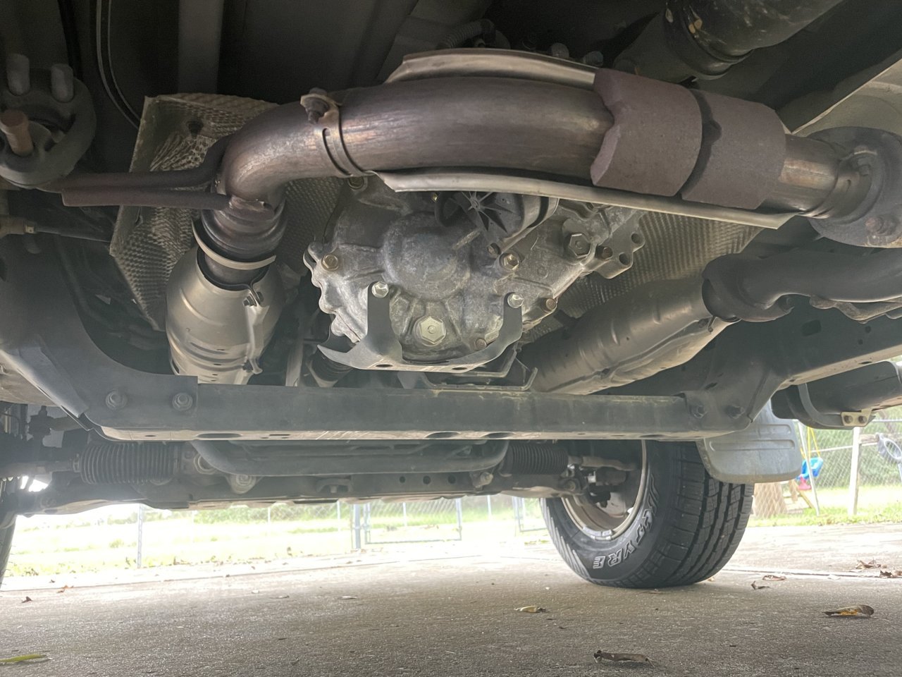

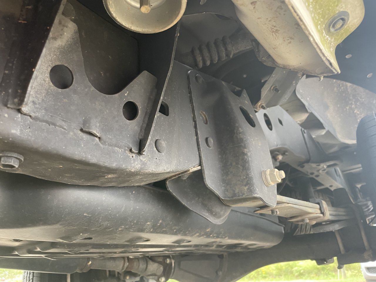

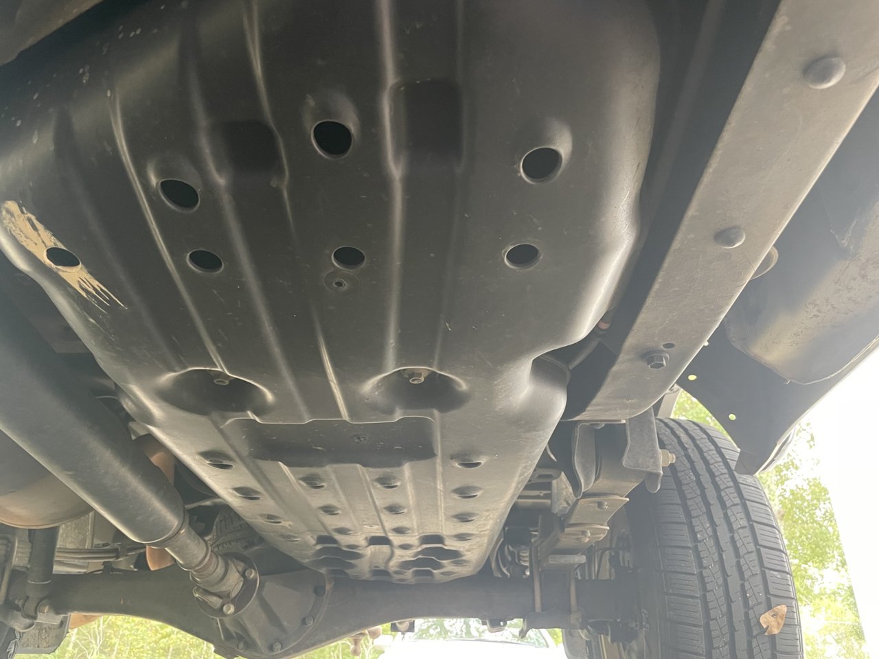

    Pics of underneath

    shit is mint

    Oh hell yeah, that damn thang is golden. Big win right there. All the right options and the right price. Everything else is purely cosmetic if the 4WD works!

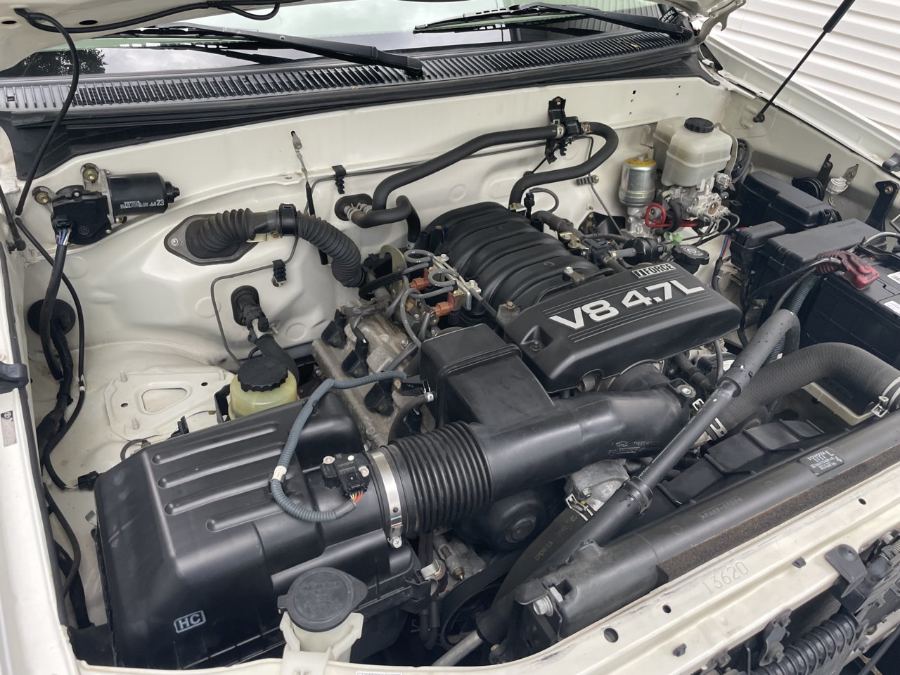

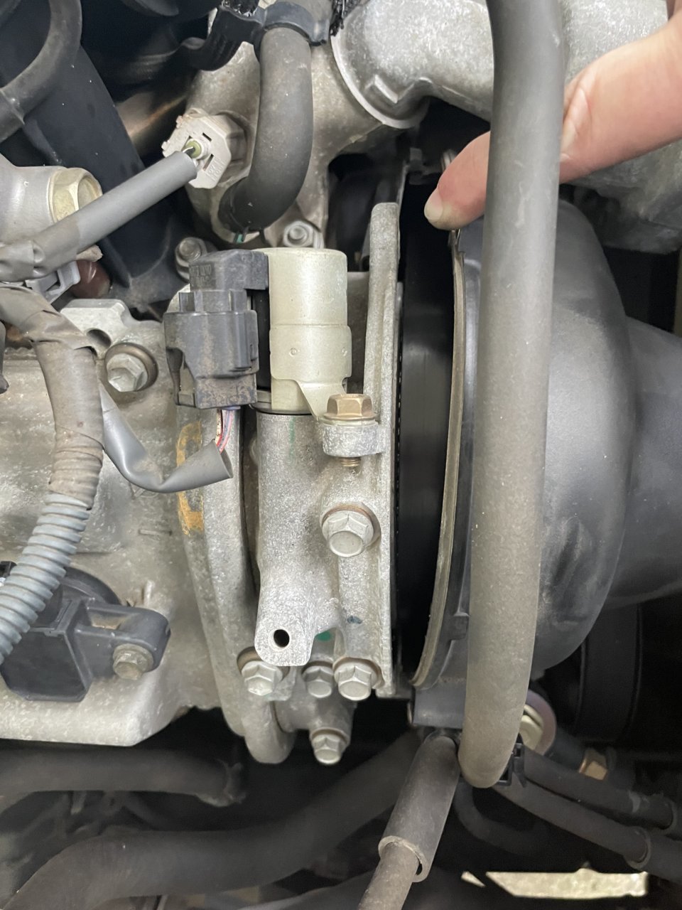

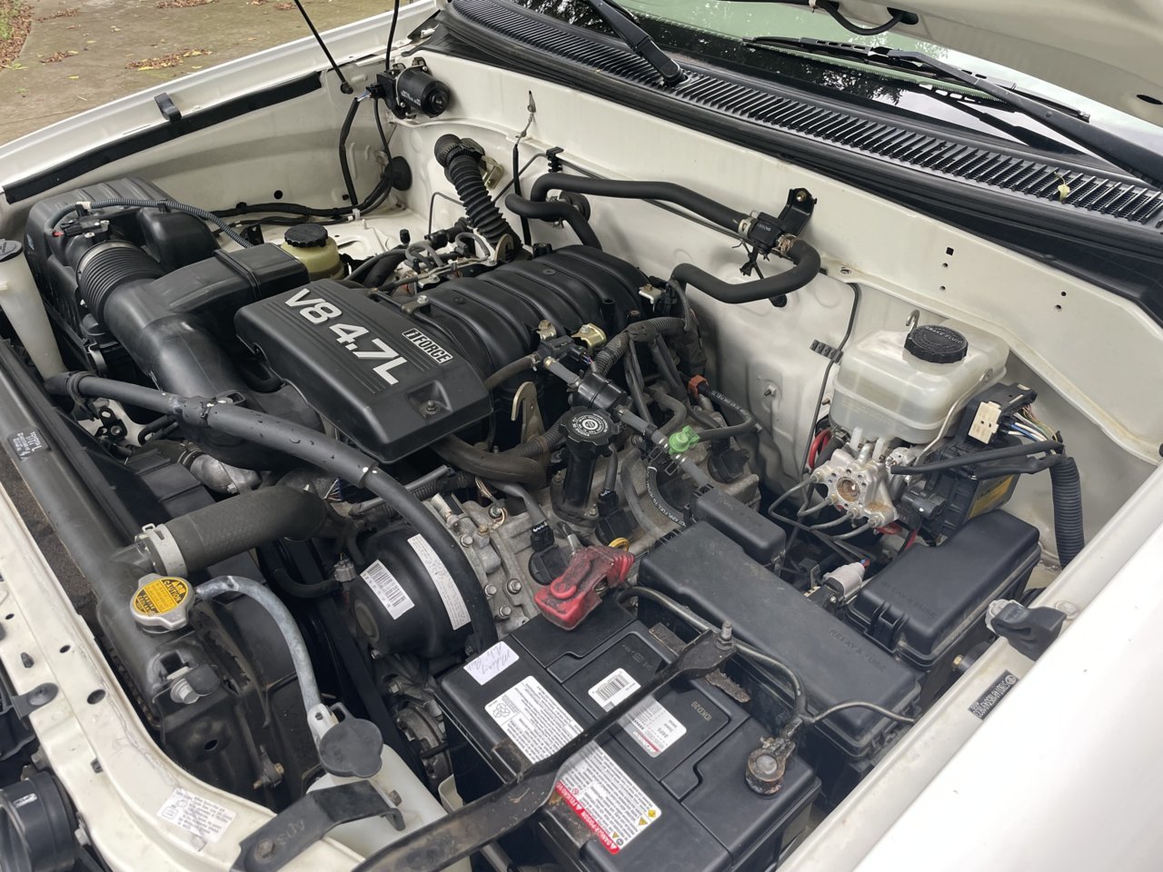

    Pics of engine bay and timing belt
    belt

    Looks good. Better than mine. But will comment, looks like you may have the 'nightmare' master cylinder. And I see there's no ABS squid above the passenger wheel well. Or wait ... what's that big controller box on the side of the MC?

    Nice truck. Fender flares are hideous though. Best to get them painted to match.

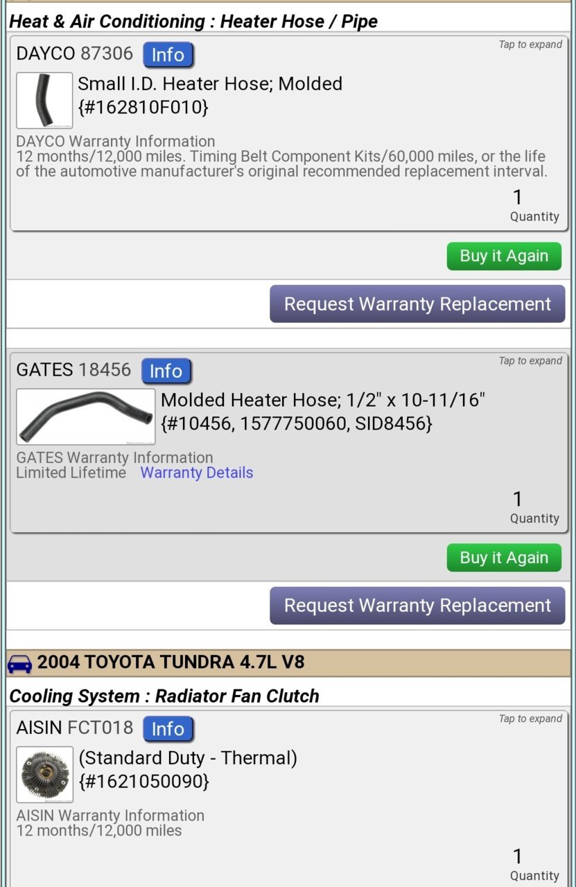

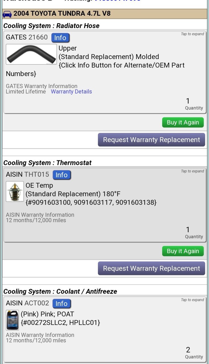

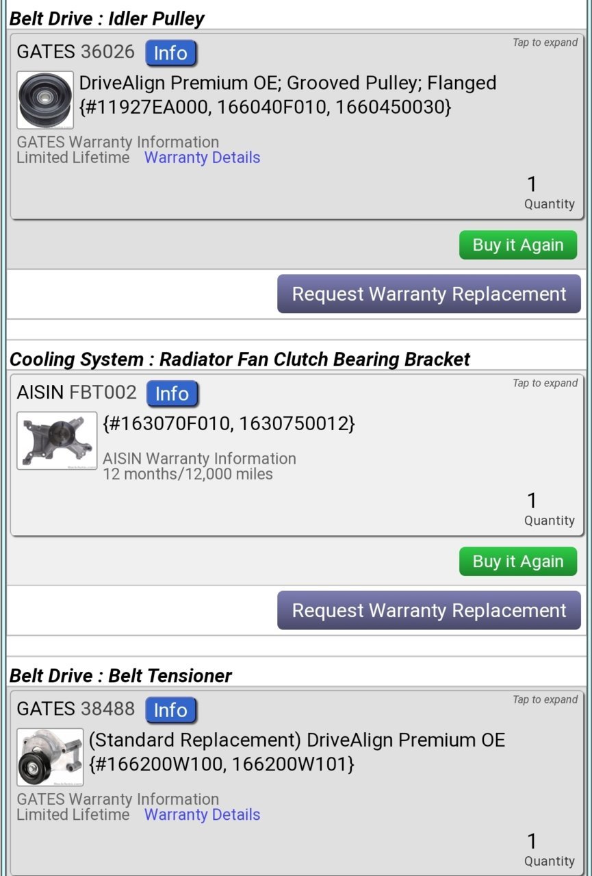

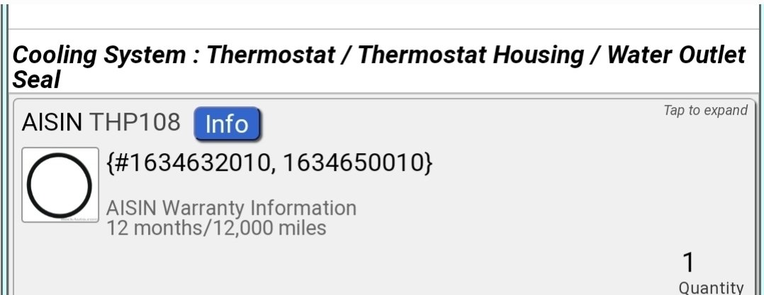

    Nice truck congrats hope to see your future mods. I just finished replacing the timing belt, water pump and couple more goodies snice I was in there. Also changed the rad for a Champion Core 3-Row.

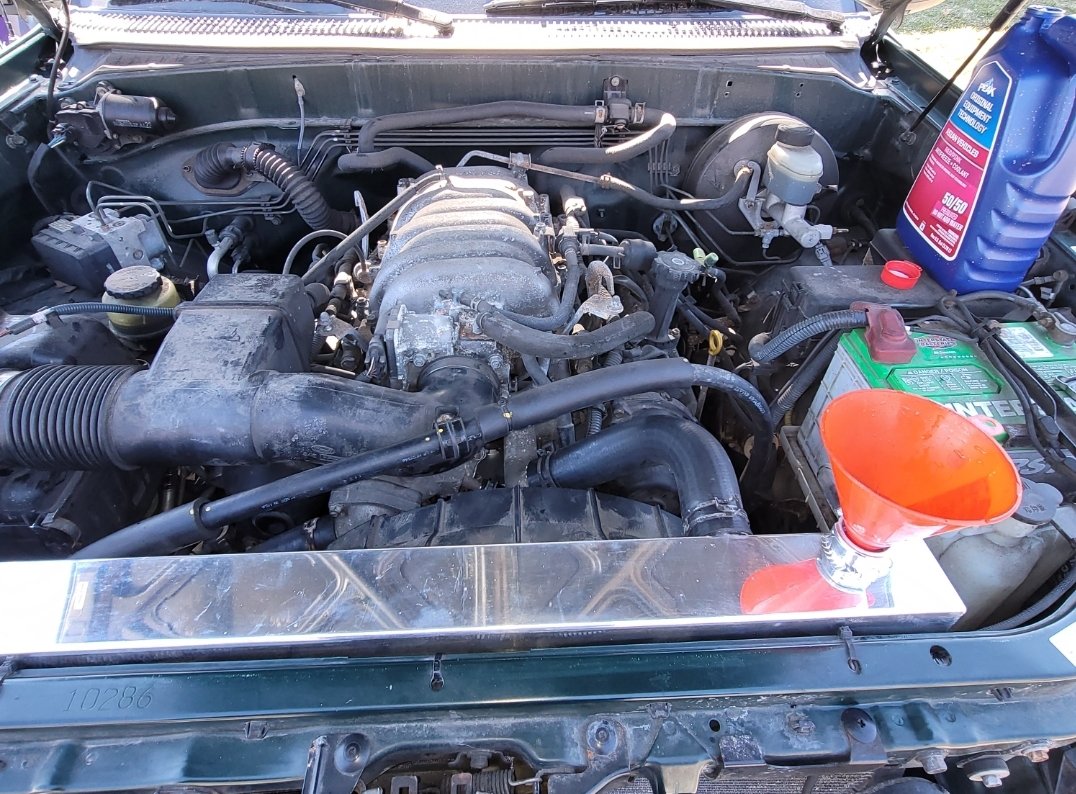

    Fitment is great the only part that sucks it that the rad holder hooks don't line up. But all the bolt holes line up perfectly. Alot better then the plastic oem rad.
    PS. Dot mind that dirty engine bay

    What is the nightmare MC? The box above the passenger wheel well isn’t present on mine but unsure what that is. I’ll see what the box on the driver side by the MC is tomorrow.
    I’m glad to report the 4WD does work. Getting my homework done for the timing belt+ maintenance.

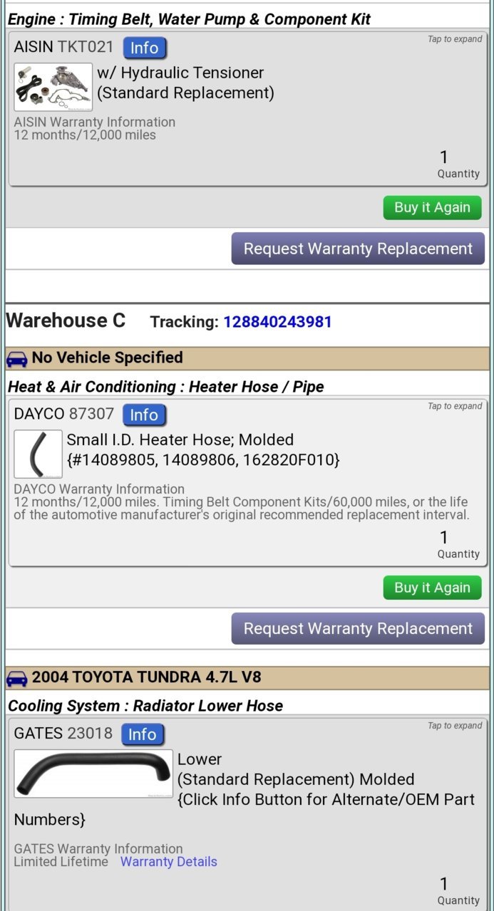

    I posted all the parts for the timing belt and also water pump. The box above the passenger wheel is the abs module which looks like you don't have. You can see it in my picture with the rad.

    Thanks for sharing those parts. I do see that in your pic. Was ABS an option on a 2005 Tundra?

    Yea should have been have you pulled your spec sheet?
  30. Oct 5, 2021 at 7:55 PM
    #30
    Dave8699
    Dave8699 Trackrat
    Oct 3, 2021
    #68852
    636
    David
    NJ
    04 Tundra AC, 2014 Tundra 1794 Crew Max
    Whole truck Raptor liner in olive green, leer camper cap, 5100 with OME, Wheelers AAL and Firestone Air bags.
    I believe you abs module is attached to the MC. Maybe someone know more about the 05.
    Abs Is hydraulic brake booster
