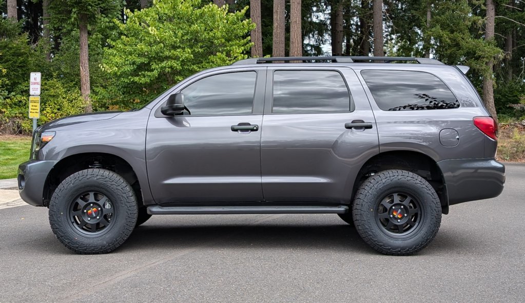

    Here's my 275/70/18's on 18x9 +18 rims
    My lift is Bilstein 6112's up front set at the first notch which is about 2.1" and Dobinson 1.75" springs and their standard yellow shocks (I want the IMS!)
    I did not do UCA's and have been just fine.
    This is with the 6112's set at the 2nd notch but the downhill of my driveway makes it look okay, but it was just a little high so I set it to the 1st notch.

    Also considering 6112’s. So what does it look like now at the first notch and 2.1”?

    S. Equoia likes this.

    That looks really nice and level. Thanks for the pic!

  10. Aug 31, 2024 at 12:53 PM

    Is this with the 295/70/r18's? And is the front still on the first notch 2.1?
    Looks great just what I'm looking for. Just picked up a sequoia and it needs this look.
    Is this all I would need? And did you put in the drop down differential kit?
