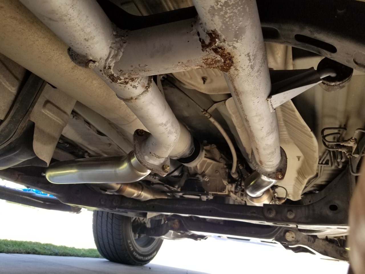

    Great write up! Are you having any heat spots inside or anything melting outside? also curious about this boot in the photo? Any heat damage?

    The angle wasn't the greatest on that pic. Here are updated pics. They have been great with no issues.
