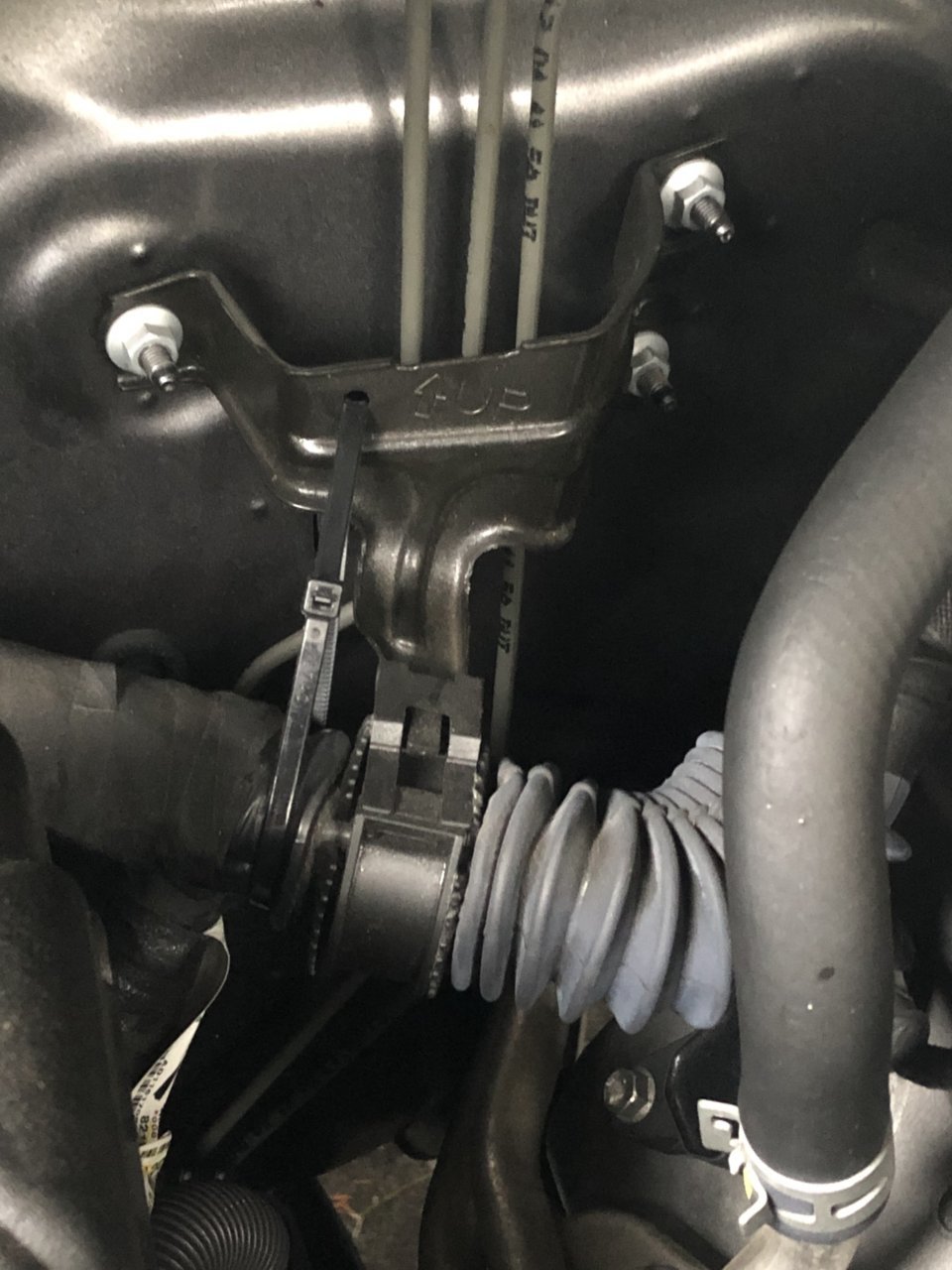

    This might be a long shot, but my truck was making a clunking noise similar to what you discribed after upgrading my suspension. I read about the wiring harness on the firewall making a clunking noise. Even though the noise sounded way more than that, I tried putting a zip tie around it. Completely fixed the noise, might be worth a shot.
    bigzrs01[OP] and Toytec Lifts like this.
