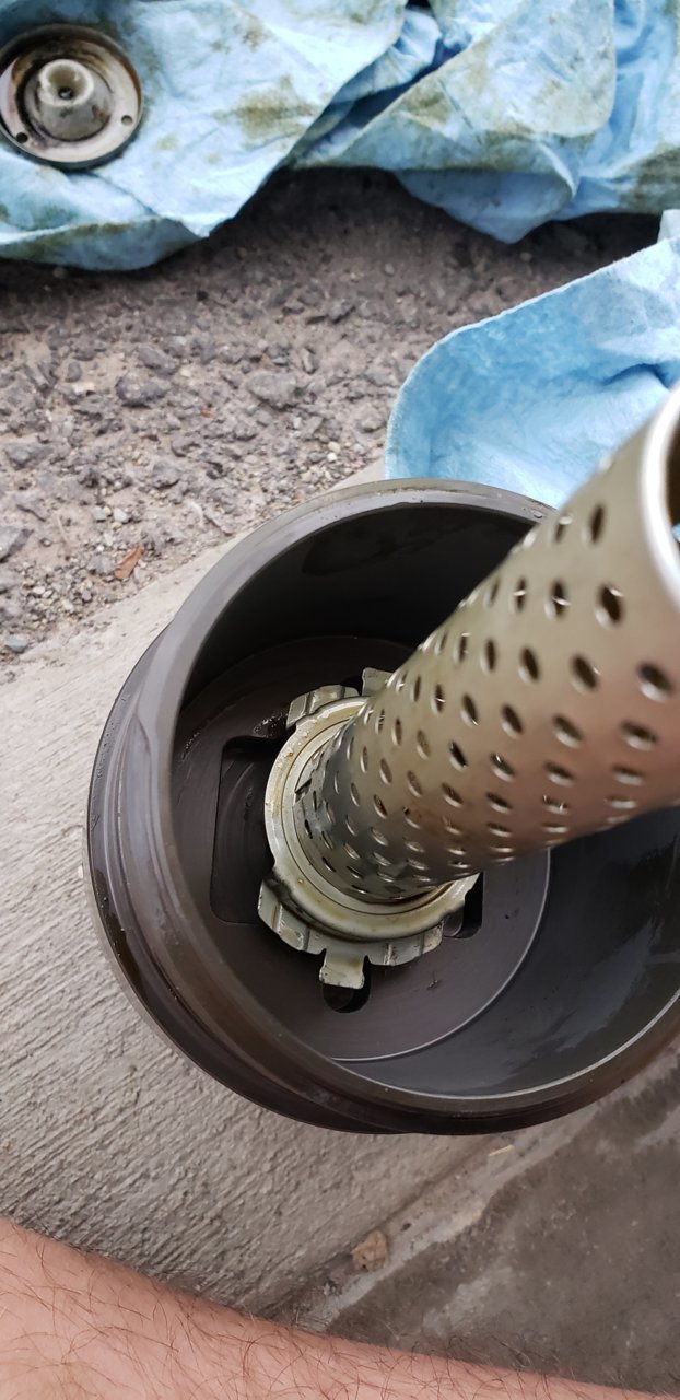

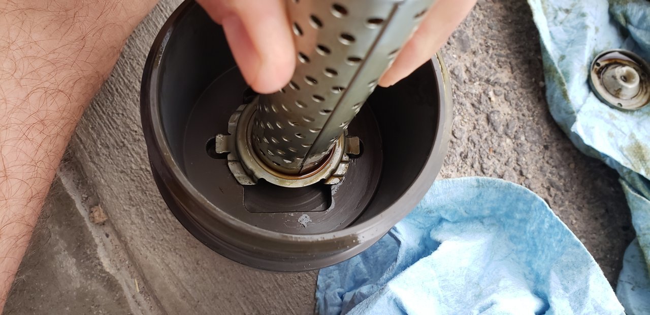

    Been trying to get this damn thing to work for the last hour. Am I doing something wrong?? I cant get both ends in the slots for the life of me 20190723_181328.jpg 20190723_181339.jpg

    Looks like your supposed to turn it 90° and then spin it into place.

    Got it figured out. You have to bend the lock tabs up and it will spin right in. It is a really tight fit in there but she fits.

    No Worries! I took a break and tried it again. It kinda just fell out of the stock one . Once I tried to put it back together I figured it out.
    Its a nice piece I can attest to that. We'll see how it does. Hope it doesn't leak.
