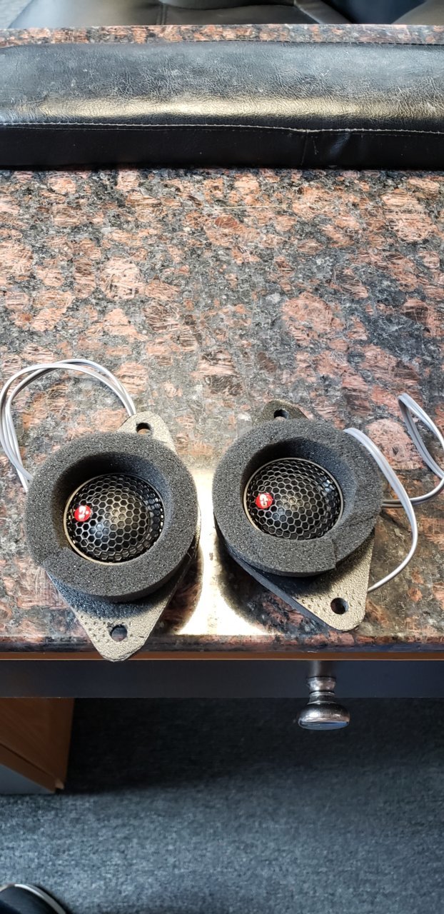

    Im running a 5 ch amp on my jbl sequoia. The front speaker are component with external crossover. So i run channel 1 and 2 for front, combine all the rear left speakers to channel 3 and all right speakers to channel 4. Channel 5 is running the subwoofer (12inch infinity REF1200S downfiring enclosure).
    Center speaker is disconnected. Corner speakers are replaced with the tweeter from the component set.
