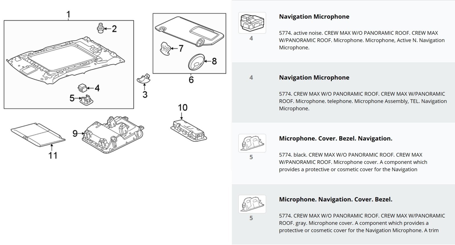

    As I understand it, they are both mics ... One for the Navigation System and the other for connected Telephones. Still researching however ...

    Mics above your head are for 2 functions, voice and ANC (noise Cancelling).

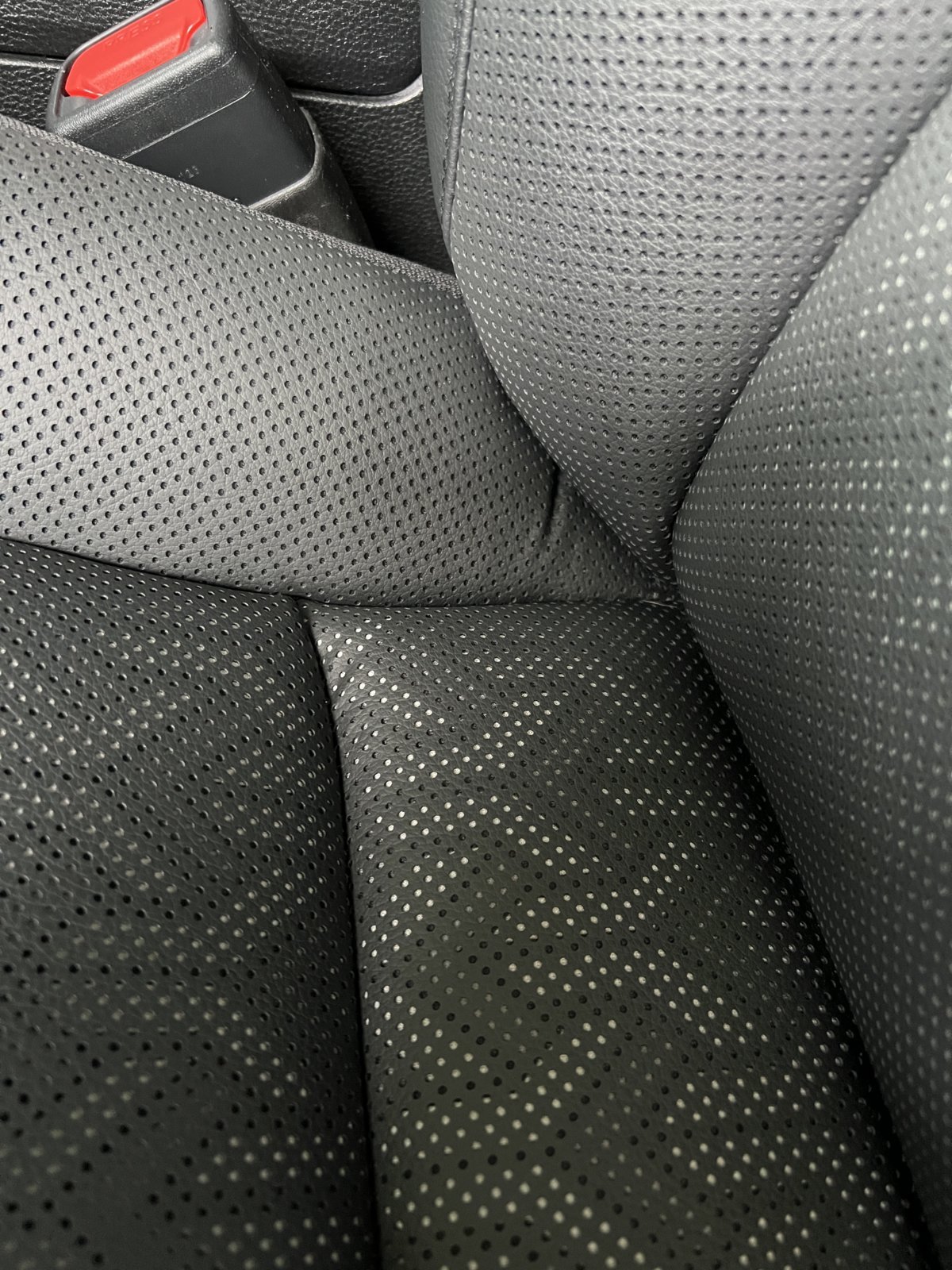

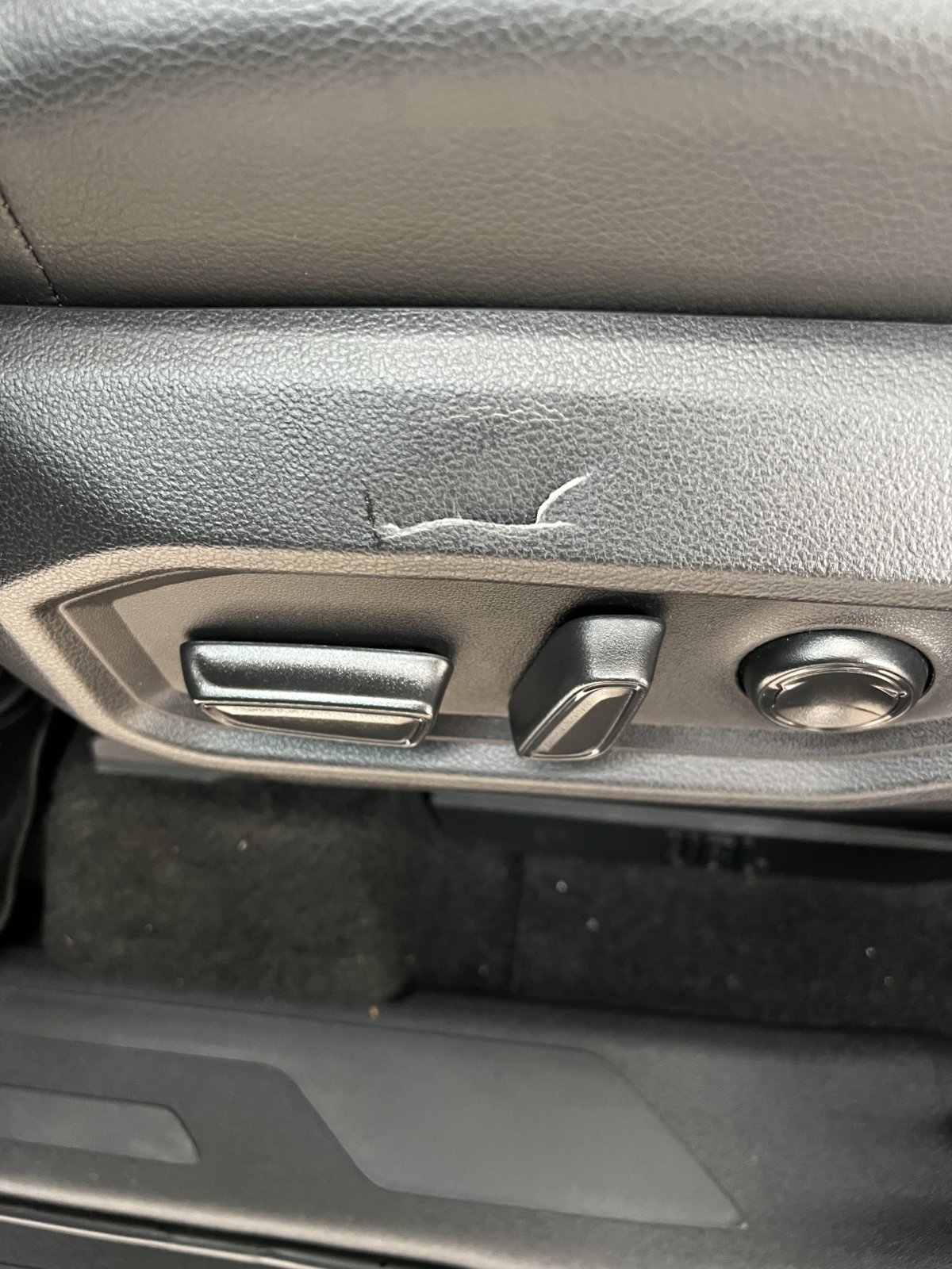

    I had an appointment yesterday (Saturday) with the dealership regarding issues: (JBL) speakers no sound coming through the back 5 speakers (including wolfer), etc. I bought the truck with aprox 17,625K miles (bumper- bumper 36K or 3 years). 1. They are replacing the broken plastic piece (driver's side) by the seat controls. 2. They found settings in the MULTIMEDIA to power the sound to all 12 speakers- it made a significant difference but I expected a more power from 12 speakers. Nonetheless, it sounds better than it did- I am happy. 3. They told me that I would have to call TOYOTA's customer service to get them to enter my computer to DELETE the previous owner's names and personal info- they apparently had no way of doing that at the dealership- odd. 4. I had read that some dealerships had replaced the middle console due to rattling... which some had complained about on the 2022's. Mine was ok- maybe a little bit of play when the lid is down but nothing distracting or that was making noise. TOYOTA said they would have to replace the entire console... and that that was impossible. 5. There are apparently two recalls outstanding on this truck of which Toyota- as of yet- has not resolved. I am only familiar with 1 of the 2 recalls; the first is a gas line (?) that leaks and that is a fire hazard (the second I am not familiar with the details). This dealer told me that since the 2022's had come out that they only had ONE situation that caused a problem. Apparently the owner had found gas leaking on the concrete and had the truck towed to the dealership for repair. 6.The oil was new but a little low so they were kind enough to top it off for me. The plastic piece was ordered so for that I will have to return for install. I will call Toyota on the "delete the previous owner's information" thing and get that taken care of. 7. There is also a crease in the passenger seat that I had Toyota take a look at thinking it was a possible tear that had begun from the previous owner; however, they told me that actually it was the way in which the seams were fitting. They recommended to take pictures and send them to Toyota so that I could plant the seed that if the upholstery tears- post the warranty- they already knew of my concern.
    I wanted to give the outcome to my concerns I had risen on my original thread- thank you for everyone's input.
    Have a great Sunday and God Bless!Plastic broken_ driver's side.jpg CREASE (driver's side).jpg

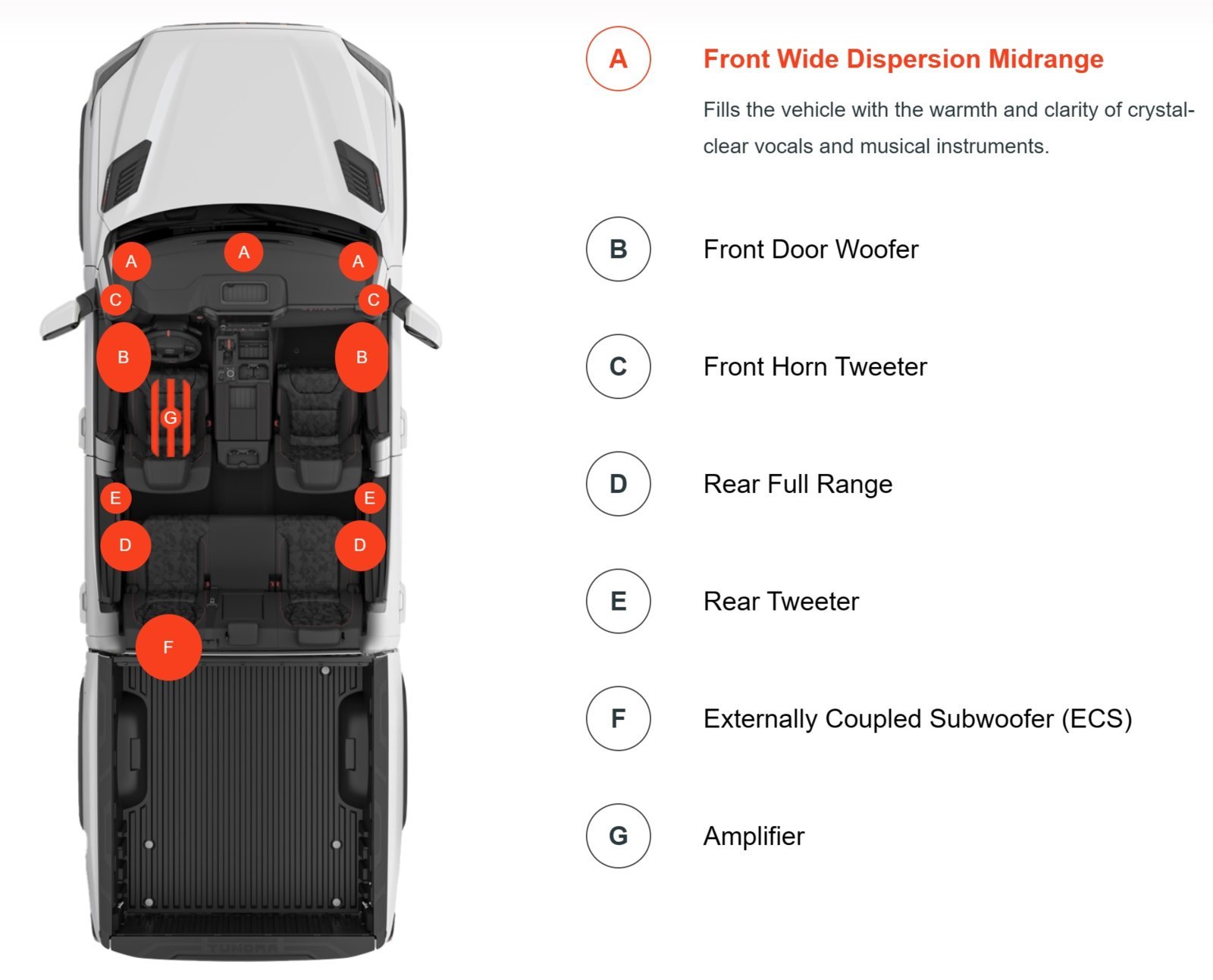

    On the 2nd item, there's plenty of power available via the JBL head-end; it's the speakers that are subbar. I faced the same situation with my 2018 Tacoma with the JBL system; I popped the door panels and found that the speakers were junk. I replaced them with high-end JBL speakers and a Fosgate sub from Crutchfield, and it made a world of difference. The JBL speakers in the Gen 3 Tundra appear to be a bit better but are still subpar in my view. On the 3rd item, your dealer is wrong ... I faced the same situation with my 2023 Tundra two weeks ago. I found this video, sent it to my dealer sales rep, and within 10 minutes the system was reset to factory defaults ...

    The speakers are all paper and the “sub” isn’t even in an enclosure. The whole JBL and premium sound system is a joke.
    You’re better off scraping all of it and building something from ground up if SQ is what you’re after.

    After several months of wait... the part finally came in and my driverside seat is fixed!
