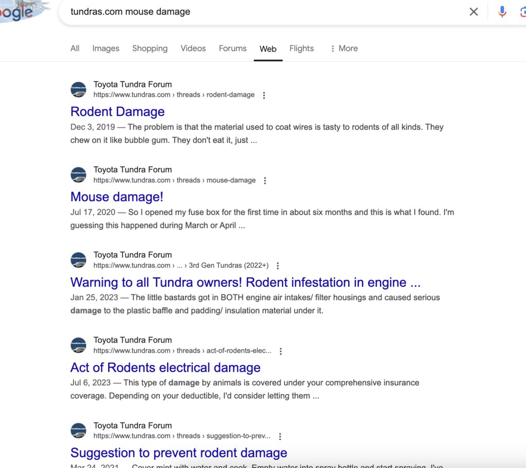

    Hey Steven,
    I know in my '21, the mice come in from the cabin filter and go all over my truck cab. The poop and chewed things are the proof. Since closing off some of the entrances, there isn't any mice that come in the cabin.
    You, by your experience, understand electronics ten million times better than I do. I just know that I have heard of people local to me, who have had to buy entire new electrical harnesses after mice have eaten them in their 2nd/2.5 gen Tundras. I too would think after this many issues, someone would have checked the entire thing, rather than keep throwing parts at it. But, I have learned the hard way, to never assume the dealer "went the extra step" to diagnose anything.
    So, take what I say with a grain of salt, but also, look at the amount of results from a quick google search of this forum. There might be someone who has experienced a similar issue on some of these threads.
    Good luck with this.
