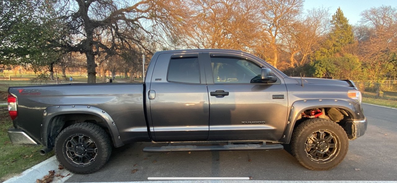

    I was debating on making different threads for each product and experience, but I might as well make it all one thing. So, this is gonna be a mix of my experience with these two brands/products, and my truck “build”. Both UCA and CO was ordered at about 21:00 (9:00pm) central time on 11/14/2022. Since this is after hours, the orders will be processed tomorrow. I’ll put down all the updates and other various info after this. Feel free to ask any questions. Let’s hope this goes as smoothly as possible:fingerscrossed:

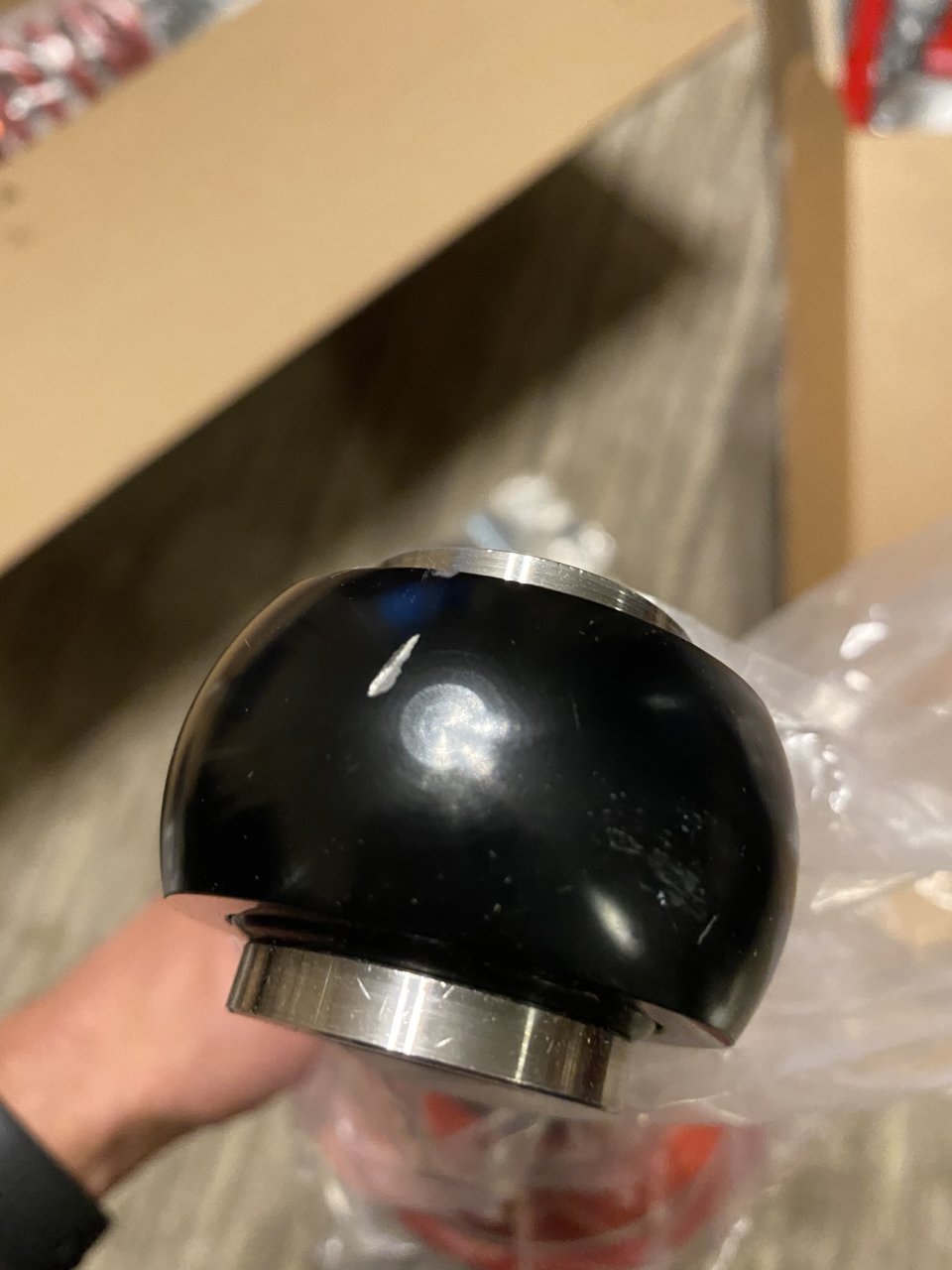

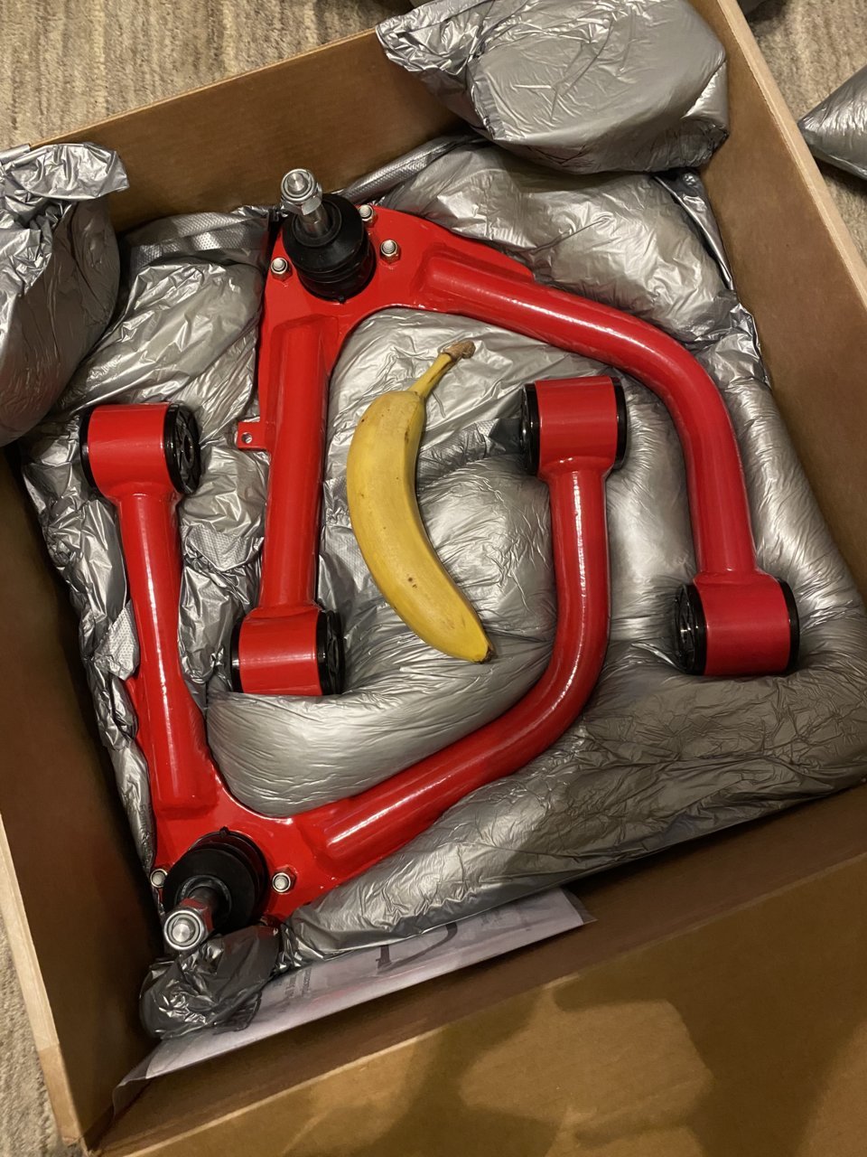

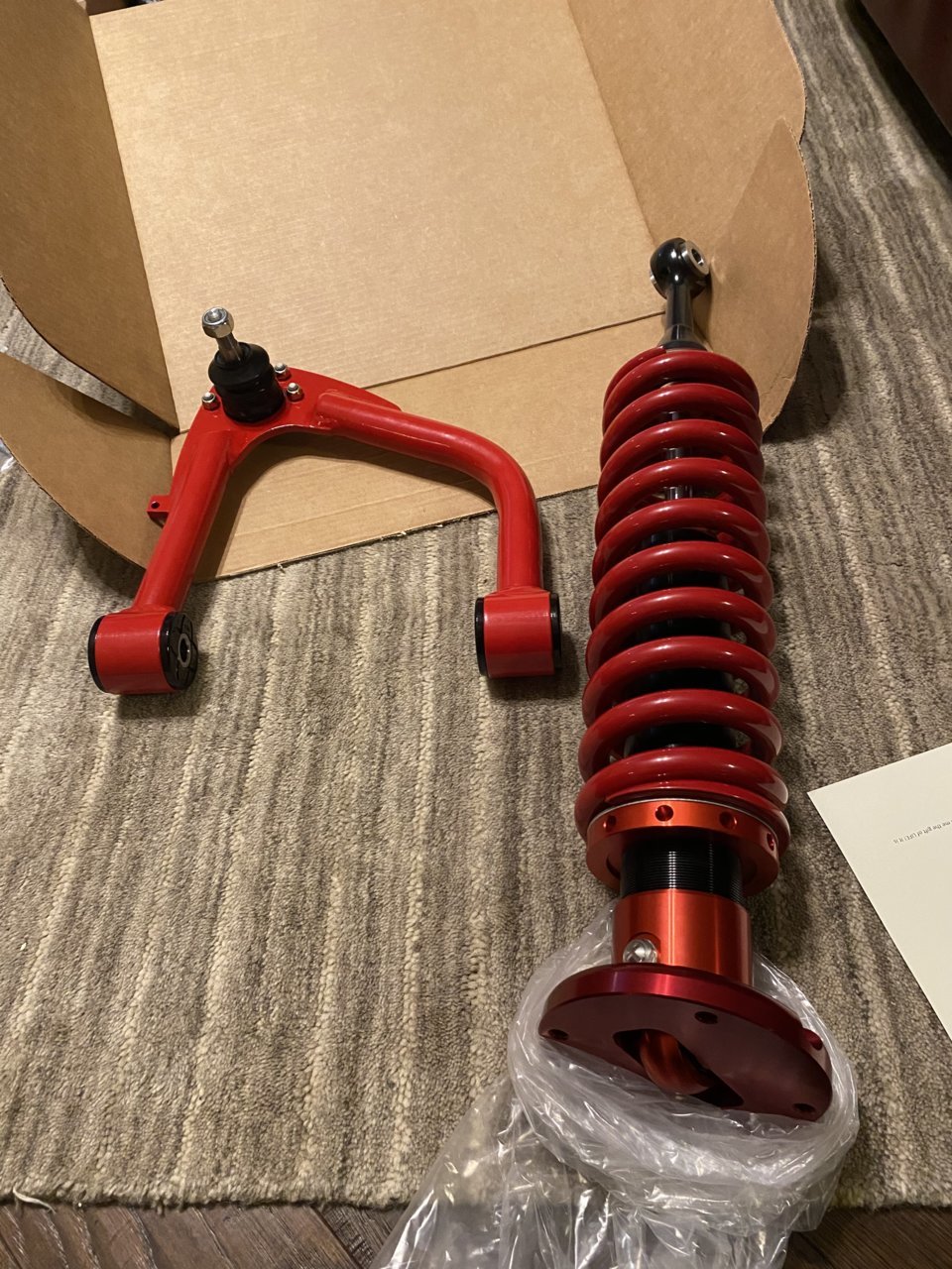

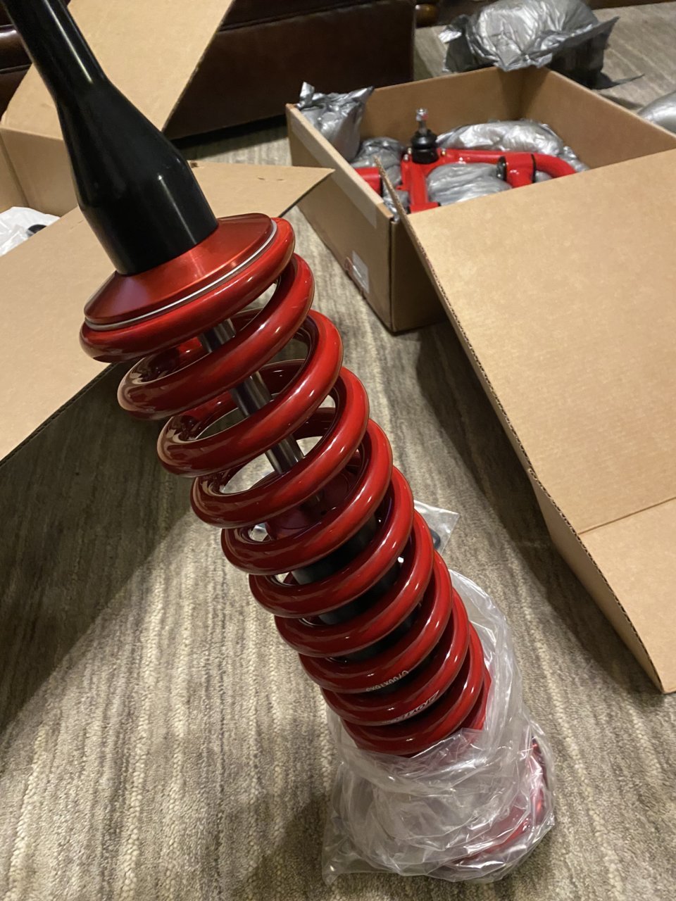

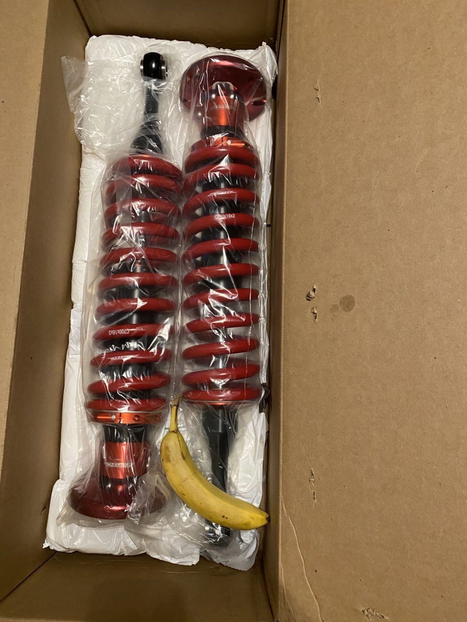

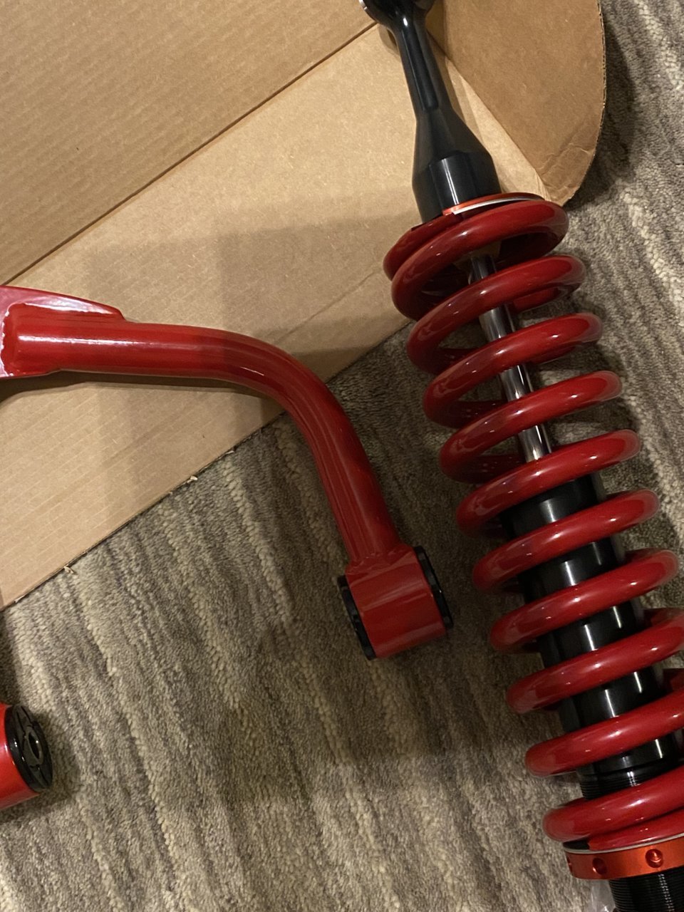

    So, UCAs and COs got here today. Just as a reminder, I ordered after hours Monday night and selected the base level shipping for each. First impressions are good. Each product is packaged nicely, and everything seems to be here. The only minor “complaint” is that there’s 2-3 chips on the bottom of one of the COs. It’s so minor it won’t be a problem though. It’s weird seeing stuff online, and then in person. The shades of red are not as similar as I thought (UCA to COs), but once they’re both under the truck they’ll look a lot more similar. They are both HEAVY and BEEFY as hell. I’m honestly impressed. They both came with stickers (only relevant to the 6 year olds). I’m set to install nest Tuesday, but the shop still needs to confirm a couple of things first, so stay tuned. Here are the pictures in order of me opening them. A banana for size reference. :bananadance:
    E3B8D40C-BB82-4E91-9917-BA366535DF94.jpg 257C19FE-6A9A-4D12-B9D3-6E07BB130249.jpg 1BB54845-40BF-4EF7-86C1-5C64705ED3D1.jpg 8DADE7BA-FEE2-4833-9947-77BD19B23F93.jpg 3186C764-D9F9-43EF-AD02-4B7CE29EF9B1.jpg 43DD5017-CE23-4A52-8F54-5BF2EB14E4EC.jpg 0F4E10BC-F0C3-4F61-AB3D-445F942B69DB.jpg

    How much extra did they charge for the banana?

    About $0.69

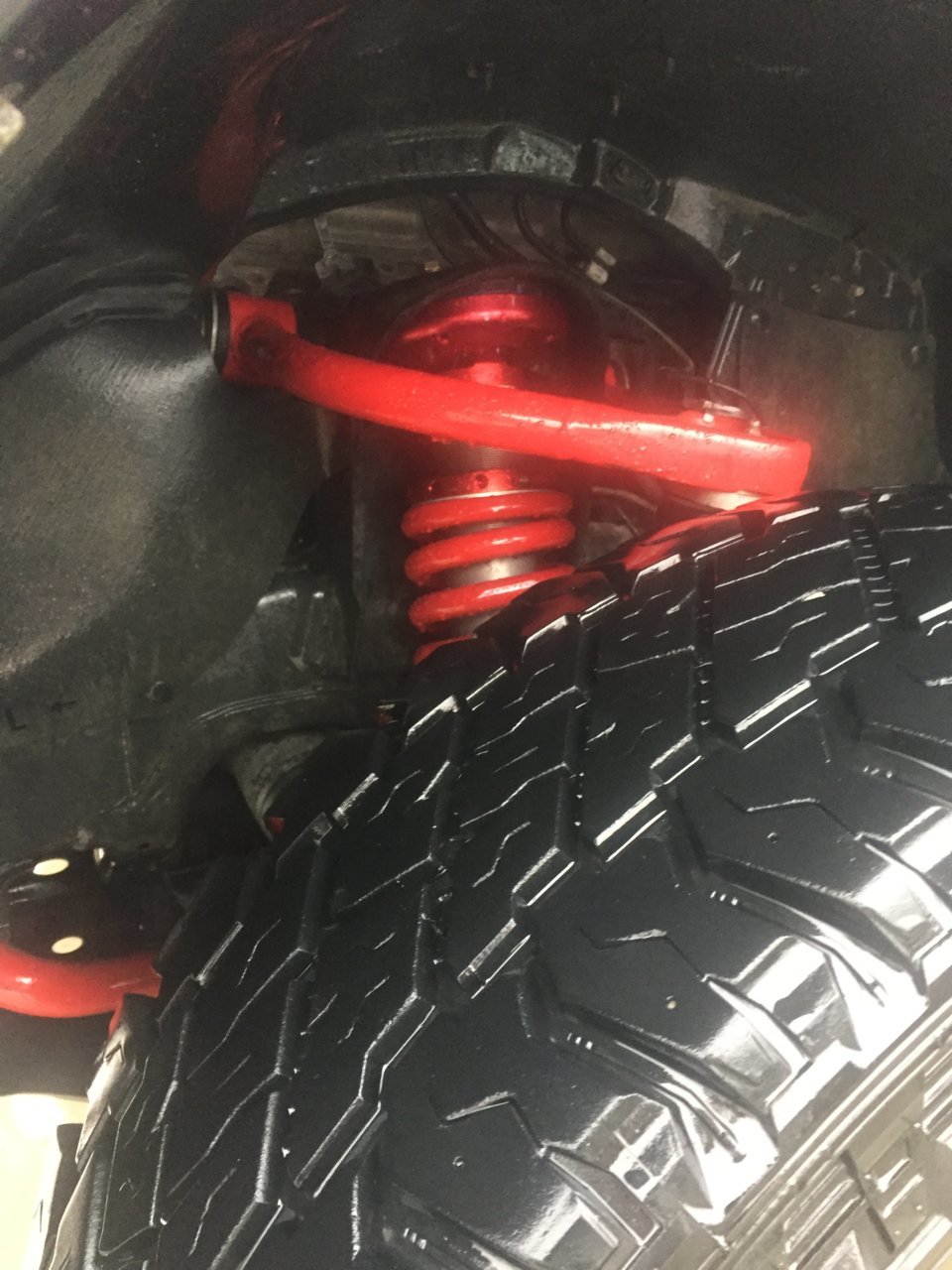

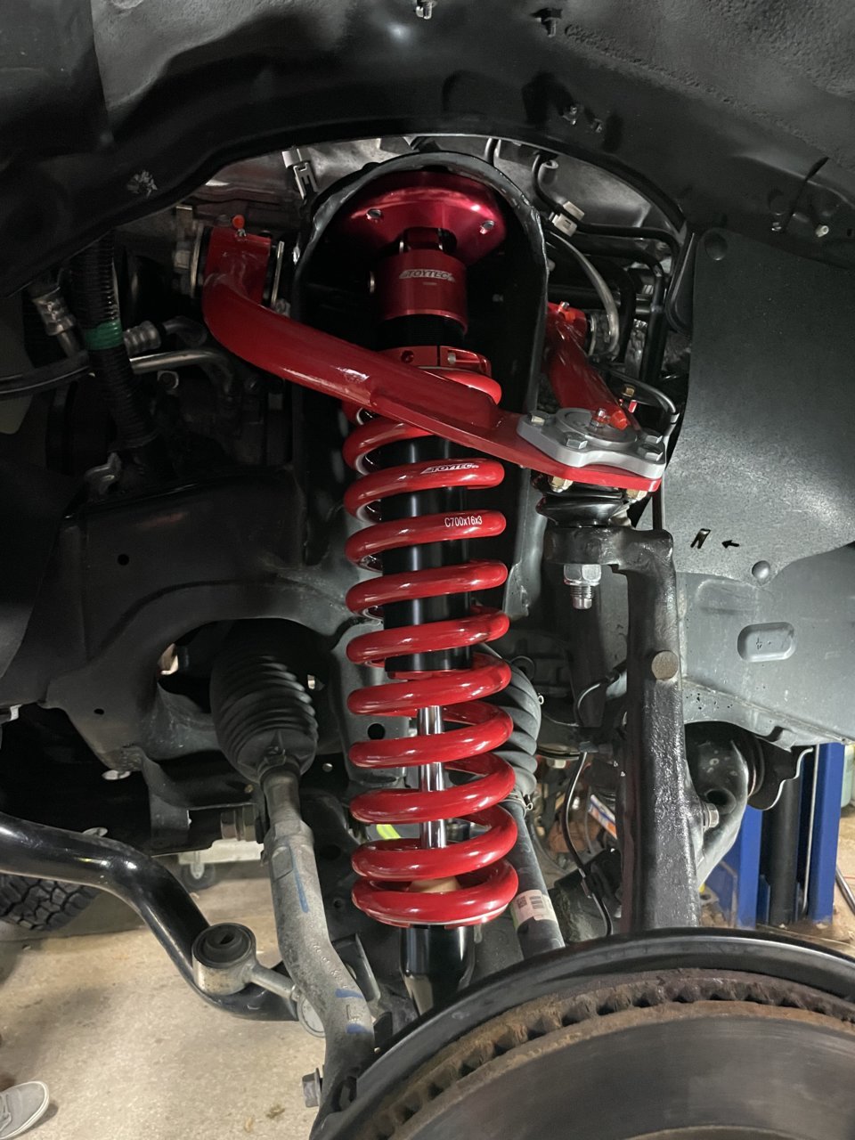

    Parts were installed today. I only drove the 2 miles back home, but it felt great. Seemed a little smoother than stock. I’ll do some more driving tomorrow. The shop installed it from the box, and damn, it looked sick. Probably 3-3.30 inches. I wanted to keep it, but it was taller than the rear, and my CVs looked like dog shit. Had the shop put it down to 2 inches. You don’t see the suspension as much, but my CVs are a lot better. I’ll take it.
    Toytec and JBA: Both companies are 10/10 in terms of quality and customer service, especially JBA. They forgot a red grease cap on of the the ball joints, and JBA helped me out. Got a package shipped out 2 hours later. I think Charles from JBA tech support did an amazing job. He answered all my questions about their UCA, and other truck related questions. From what I’ve heard about him, he knows his stuff…
    Install Shop: Ratchet Brothers really did a good job. They got me in fast, and completed the install fast. They even put up with all my bullshit, so major props to them:thumbsup:.

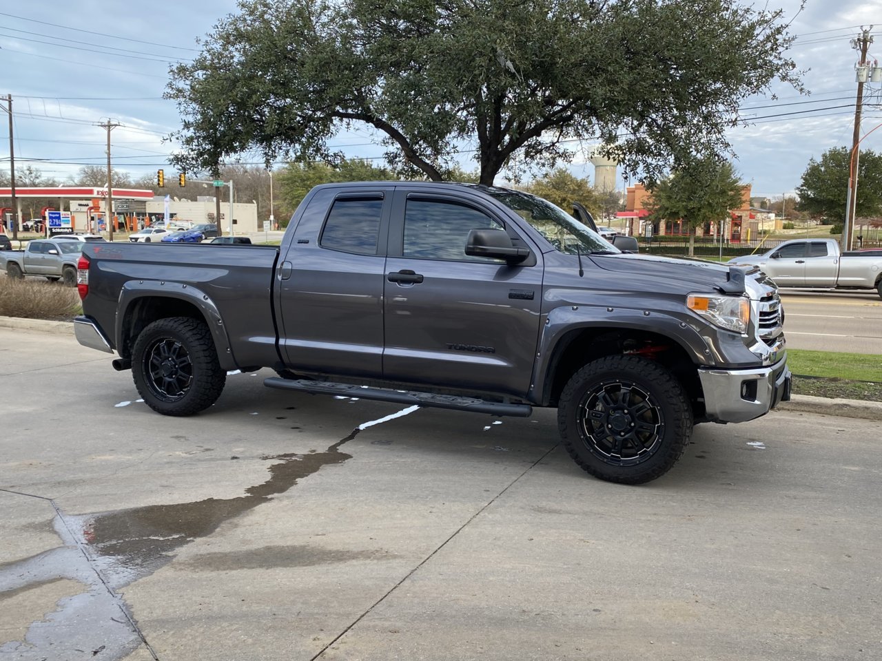

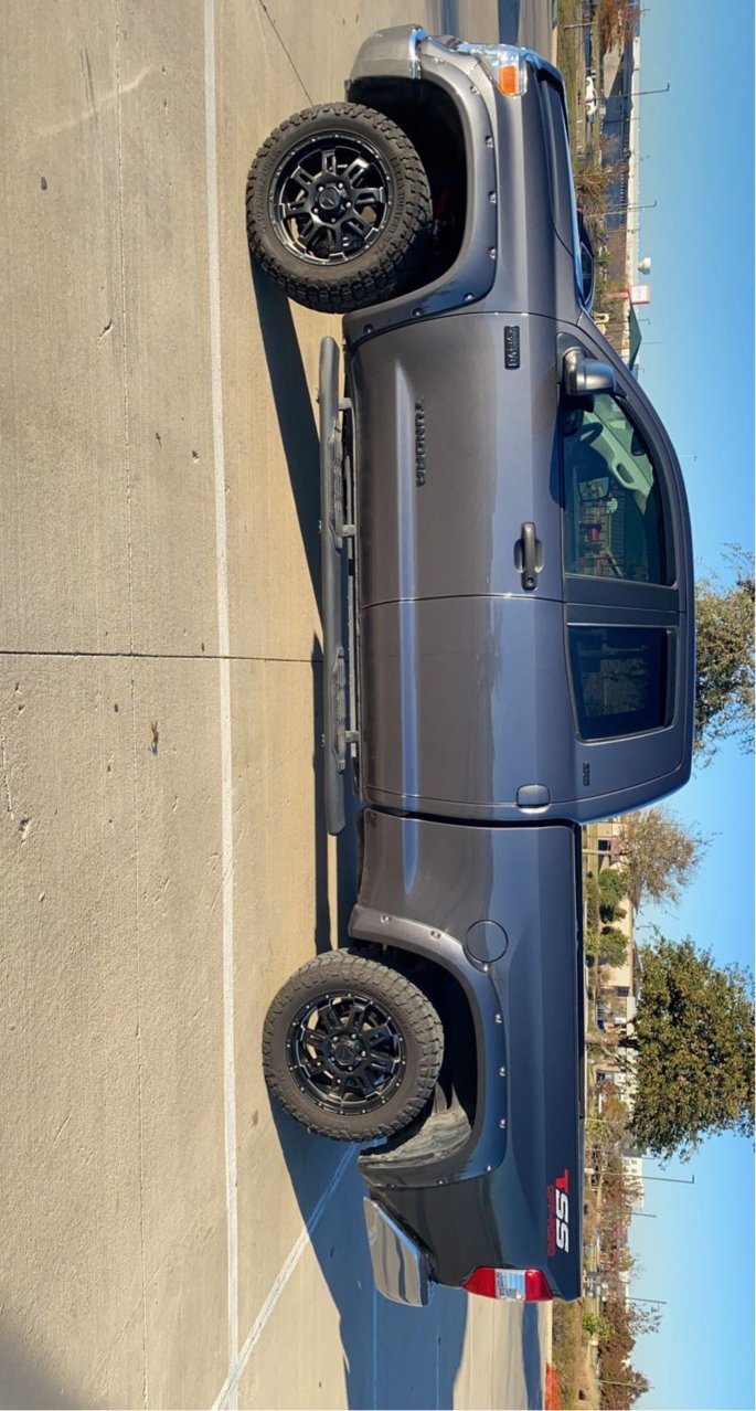

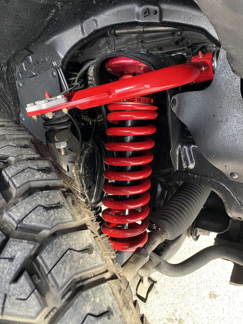

    Finally washed the truck and had some somewhat nice weather to take pictures in. The formatting for a few pictures got weird- my apologies. Lowest setting on 2.5 Toytec Alumas (2 inches up front) and the rear is stock. No diff drop, but I did do front sway bar drop. Wheels: 285/55r20.
    I keep repeating all the setup info because it can be a pain to go back and figure out what’s actually being shown. 0D2985BC-3C92-4E33-8A8B-4F5E11020B36.jpg C4632787-9E06-4E25-9EB1-4ED545A79A9E.jpg 48CD581B-1C03-454E-98CE-CC1CA52BC4B6.jpg 959A10E1-499F-4F29-ABD5-CCBA73A873D4.jpg 1CE89E5B-C29B-43BB-91ED-04C45B57C8A5.jpg

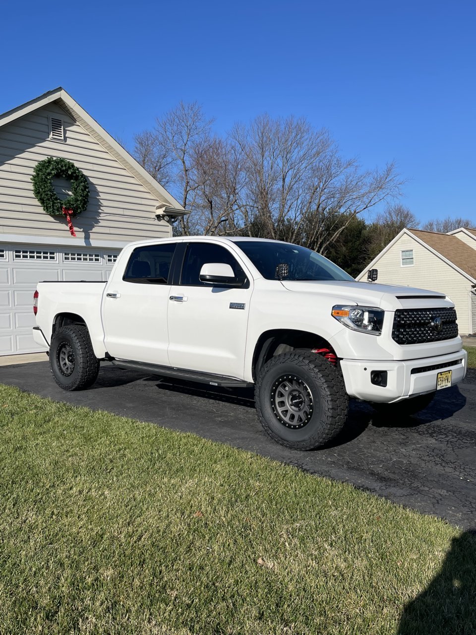

    Just did this same setup on my buddy’s tundra last week.

    I swear I’ve seen that Tundra in a picture before… maybe maybe not. What height/tire size setup is that? Looks like 3 in the front and stock in the rear?
    SoJersey[QUOTED] likes this.

    We just did the work, I’m not sure he has posted any pics anywhere yet.
    Tires are 35x12.5r17
    Lift is what you said. About 3” up front and rear is stock for now.

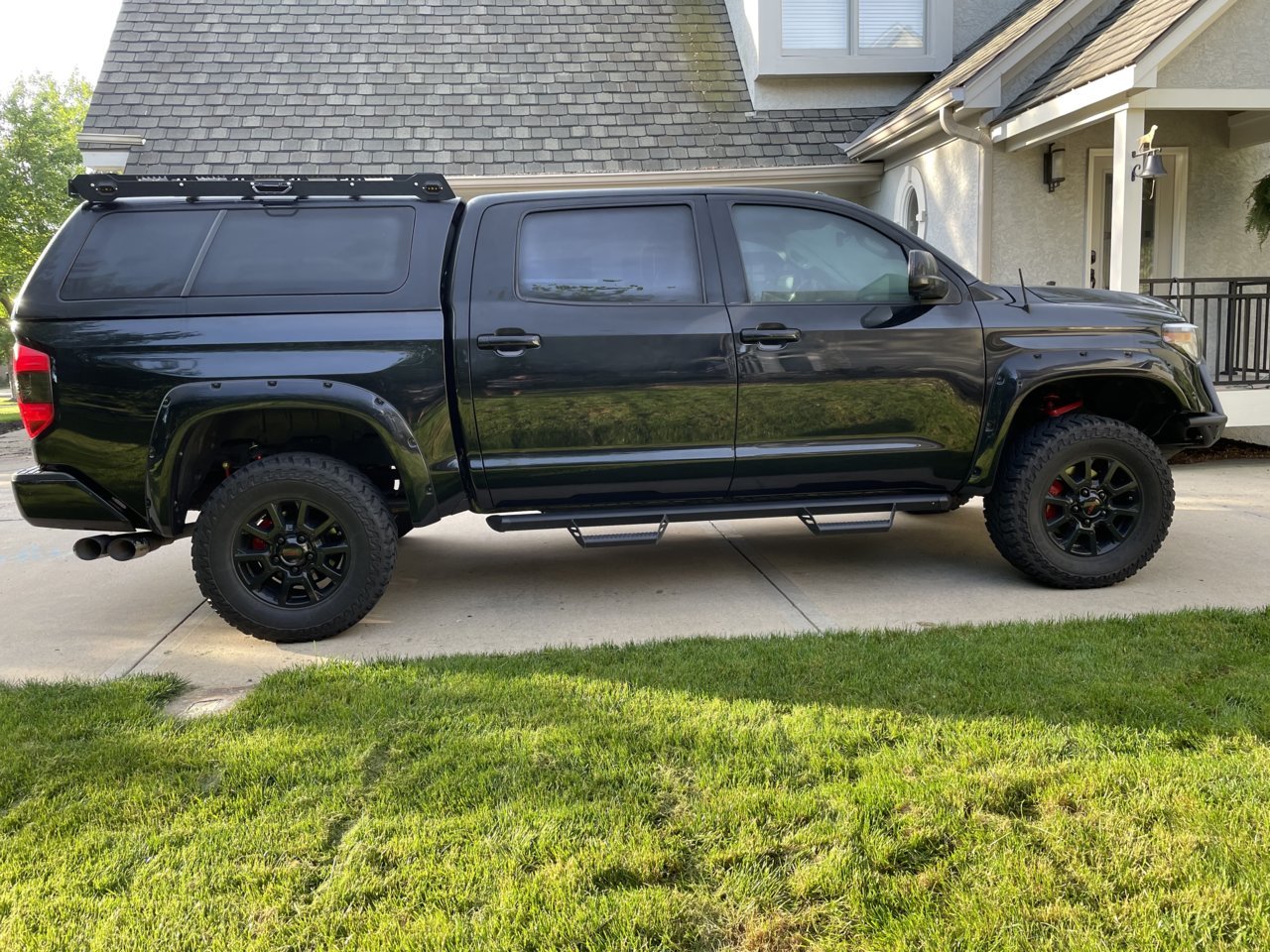

    I have a 3 inch toytec lift in front with shims and a +3 shackle in back with add a leaf plus a powder coated UCA...coachbuilder did for me.

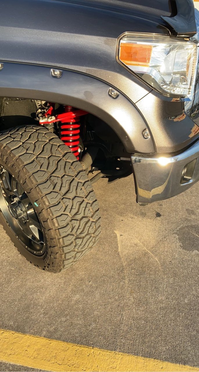

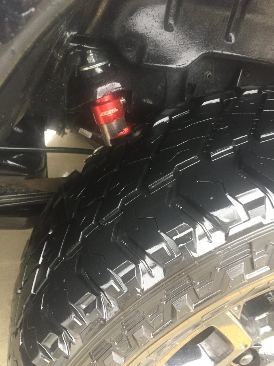

    Solid 8/10. Only issue I’m having with the coilovers is that my tie rod ends are hitting them. I have my coilovers set to 2 inches (lowest), and so I’m not sure if that’s effecting it. Causes for a lot of grinding and popping while turning (on a bumpy surface). Sounds worse than it is- but I’m still not happy about it.
