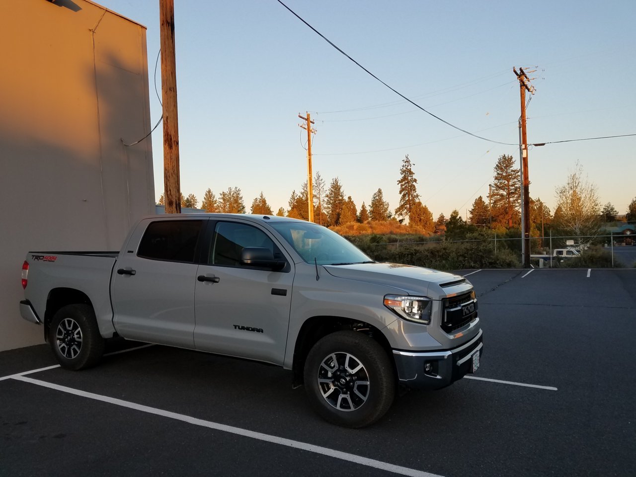

    First real mod and one of the best IMO. Pro grille. I relocated the TSS sensor to the left/center of the pro grille. I trimmed out one of the supports with a dremel to make a nice little hole for the sensor to sit in and glued it down directly onto the backside of the grille. I threw a ziptie on there just in case the sensor were to fall off, didn't want it dangling. Have ~700+ miles so far with zero issues on the TSS features.

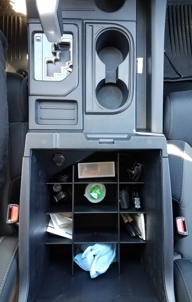

    2) Plasti dipped cup holder chrome and shifter surround. Salex organizer. Had some slight peeling on the shifter surround, planning on hitting this with spray paint soon.

    • Poor mans seat cover (old towel) under car seat

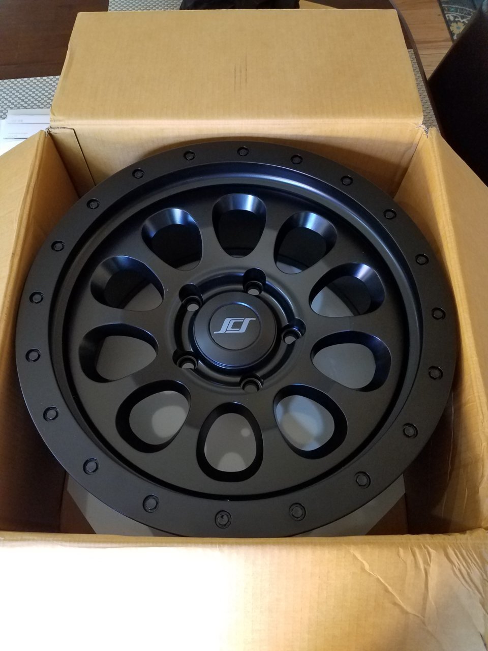

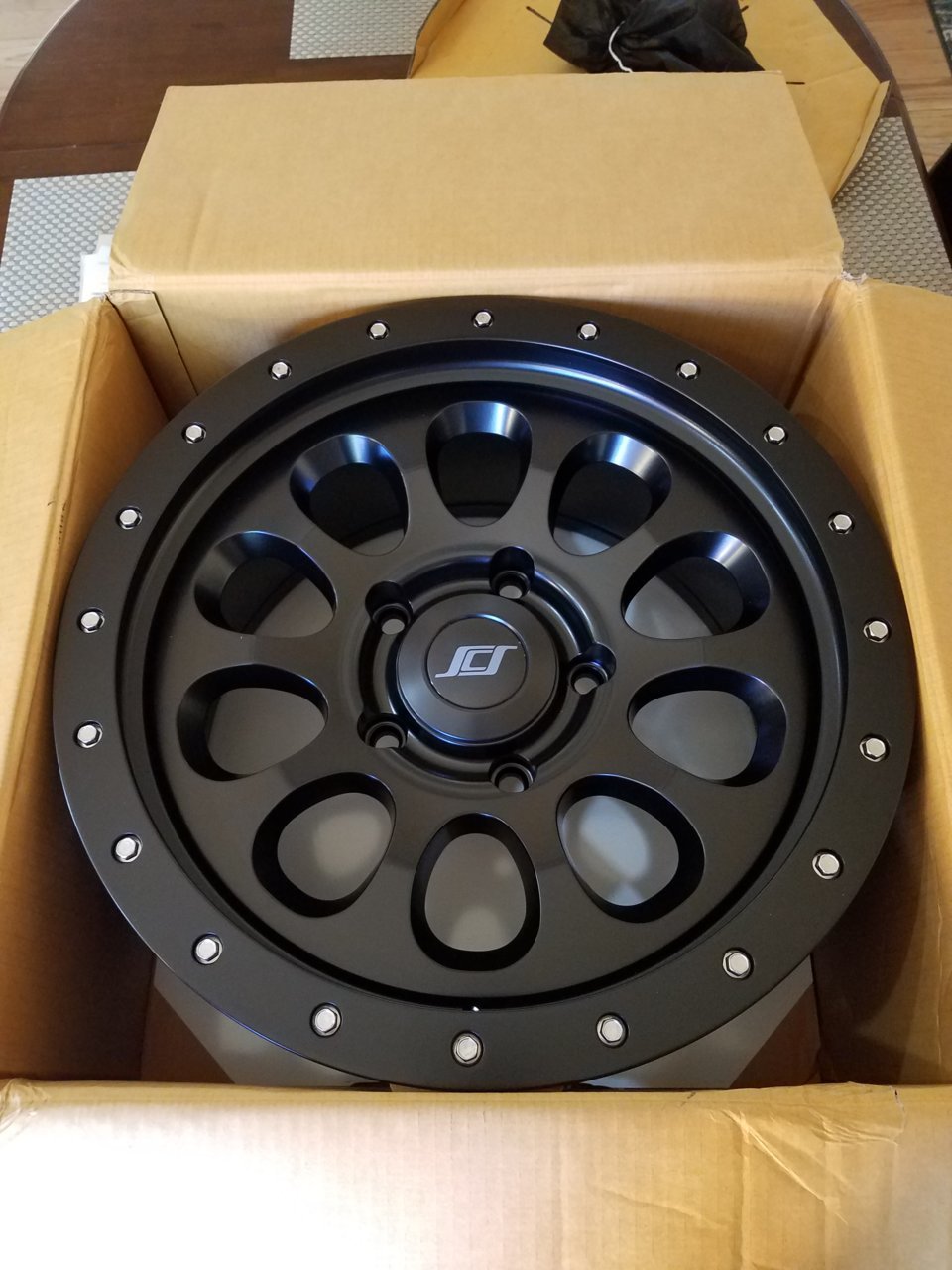

    Quick little wheel upgrade today. Removed the bolts that come with the wheels and replaced them with black ones. Can't wait to get them on.
    Before
    After

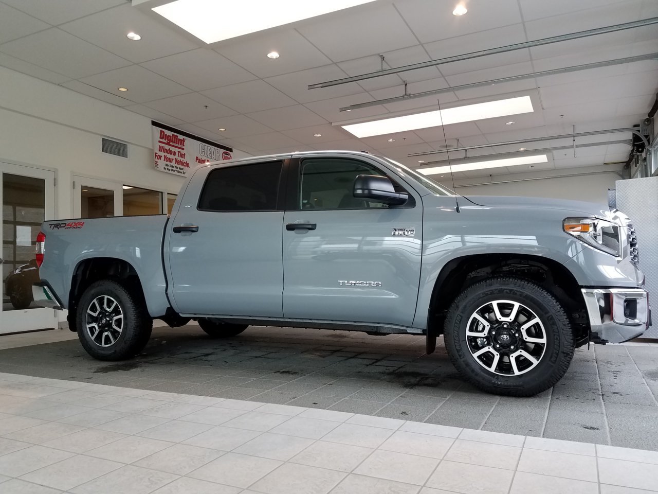

    Got the call from Discount Tire today. Love the way it sits now. @SCSPerformance Matte Black Ray10s 18x9 +25 with Falken Wildpeak A/T3W in 285/65R18. Stock suspension, very slight rubbing on the front mudflap at full lock in reverse.

    Where did you get that black hardware from? Looks great
