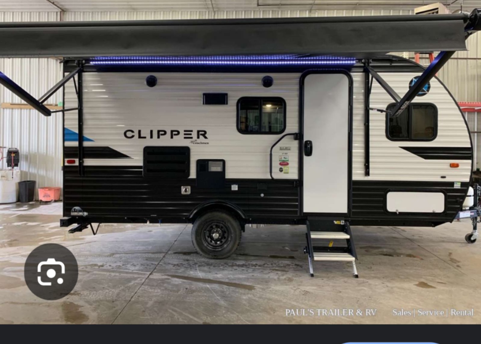

    Is this it?

    Yup!

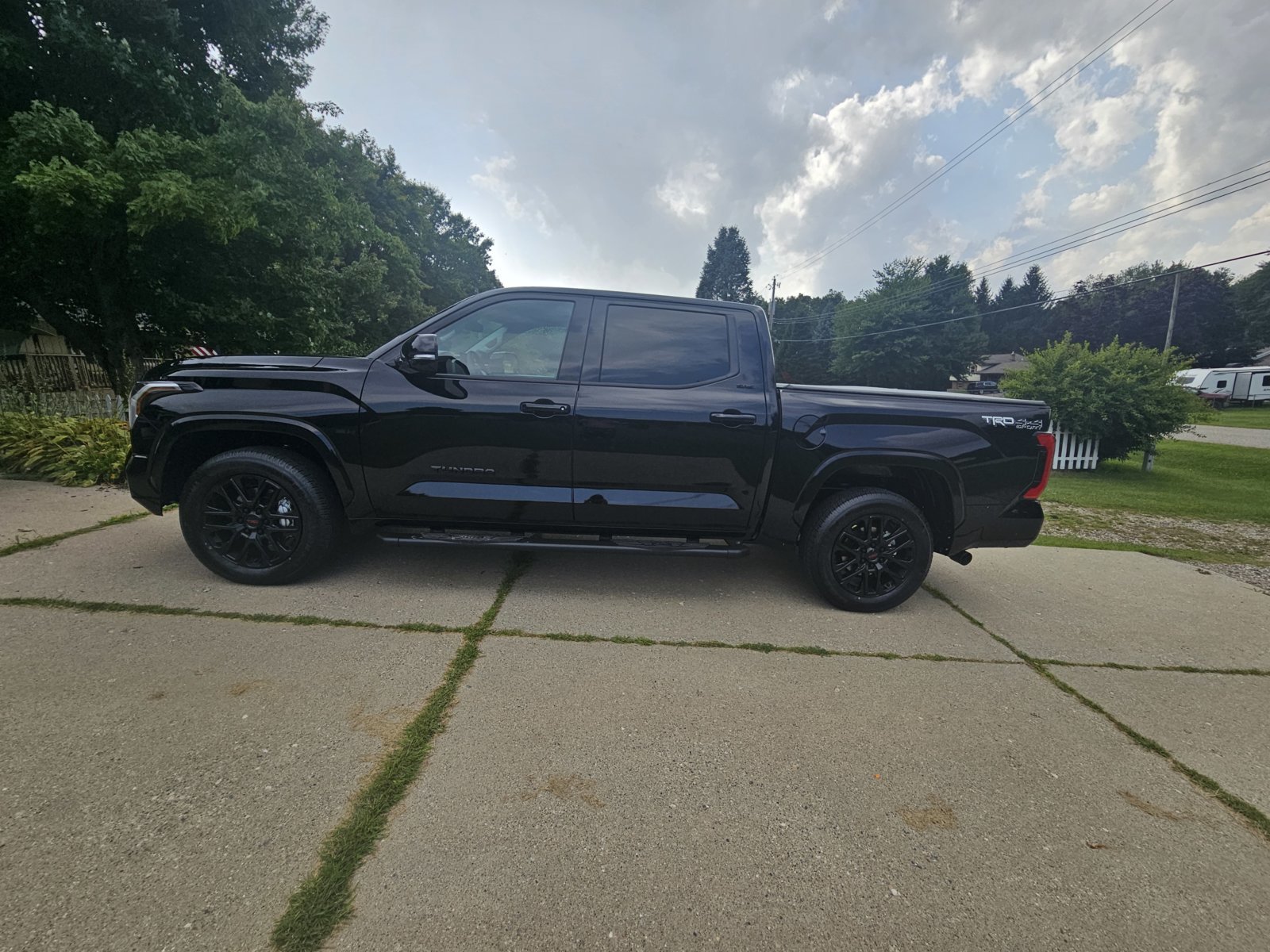

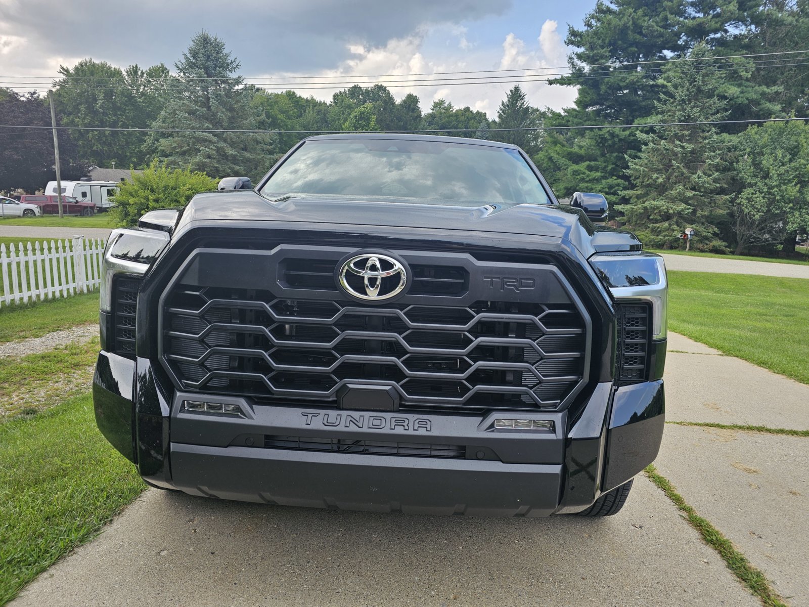

    First TV and the camper we will be towing with the Tundra
    #learnedhowtopostphotos
