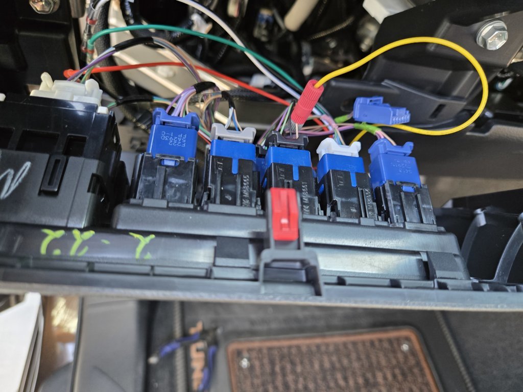

    ...to power the dash lighting for a switch? I'm tapping into my second tan wire and no go. What did you guys do?

    Yes, tan wire

    Glad too see you using posi taps.

    Got it working, turns out that I hadn't tightened down the posi tap enough.

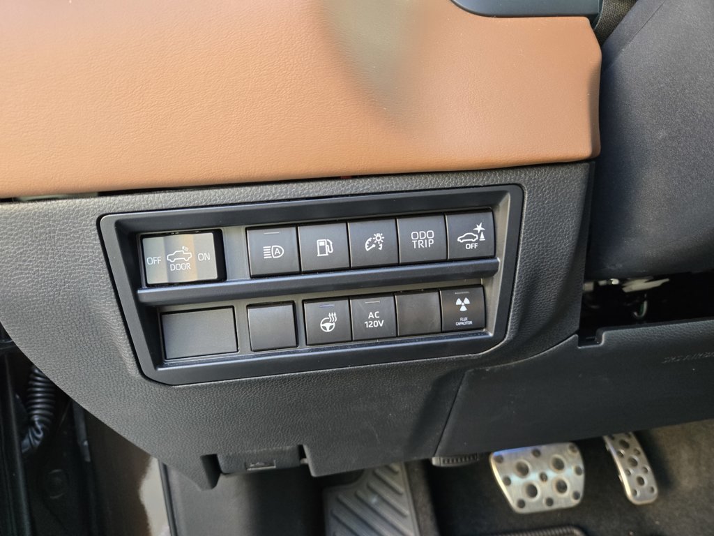

    What's wild is that I have wiring and plugs behind all of my blanks except one. I wonder why? Are they dead?
    The lighting for the switch sucks. It's dark blue LED and doesn't match the others. Has anyone cracked open the switch to swap out the LEDs? I ended up doing that for my Taco and couple of years ago.
