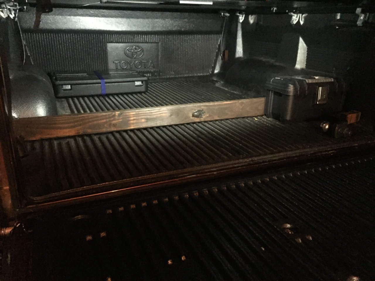

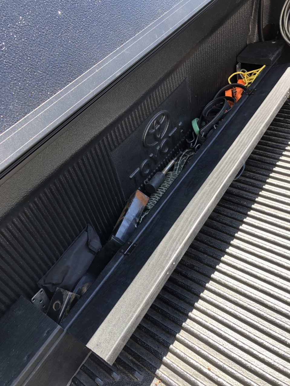

    Added a DIY bak box to my cover.
    Basically two brackets that bolted into the forward most deck rail bolt location, a piece of 3/4” exterior plywood and a 2 1/2” rubber gasket to act as a flexible, yet secure lip to hold everything on the shelf.
