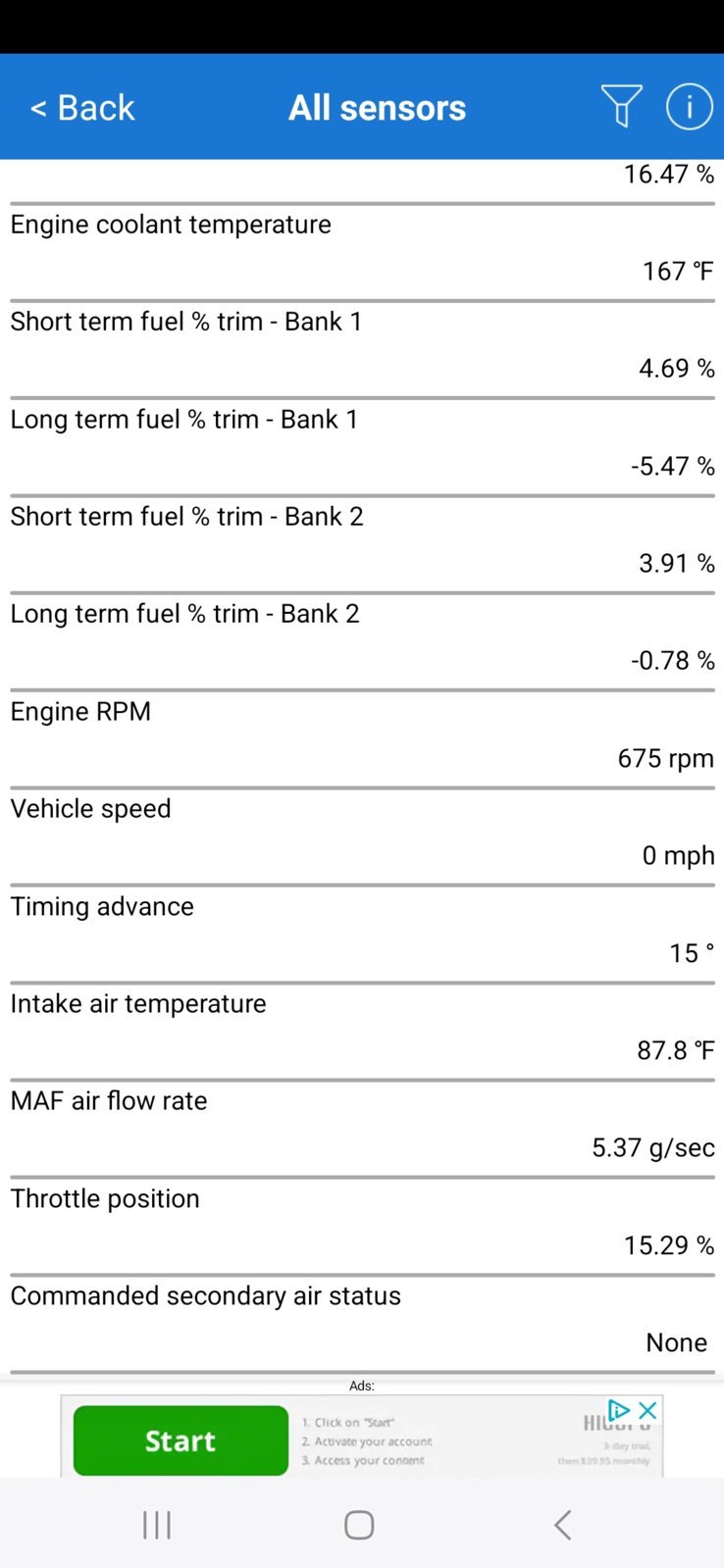

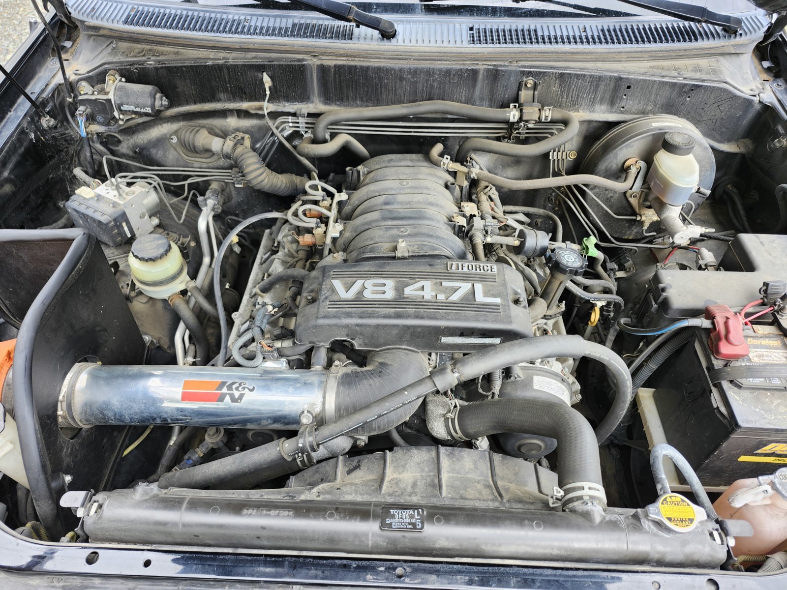

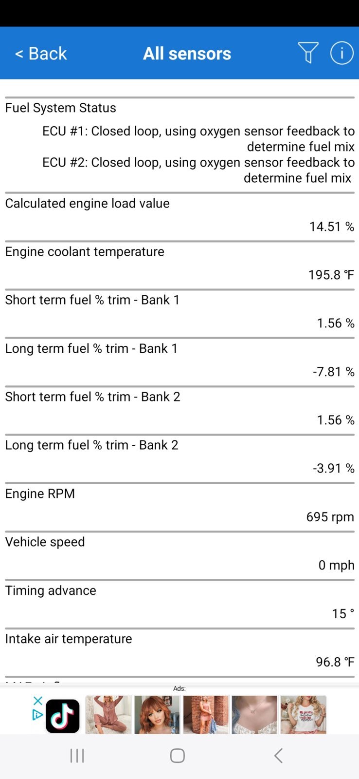

    Just swapped oil last night. Mobil 1 5w30 as always at 5k. Put on a oem filter. I put 6 ounces of seafoam in the crank case at the store and drove it 2 miles to my house before changing the oil. As I did when I bought the truck.
    Started the truck and it bogged hard like jumping from 600 to 1500 over and over a few times so I shut it off. Turned it back on and it ran fine. Drove it a couple miles and noticed the engine is now shuddering. In park, drive with the brake on, reverse slowly or with the brake and in drive up to 40mph. It's not the same shudder I was diagnosing before. It feels like a fuel issue.

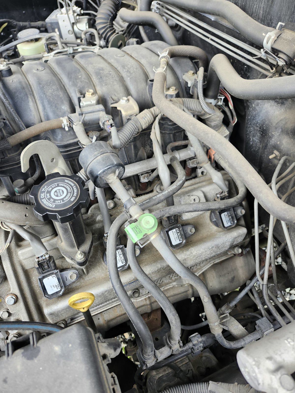

    I cleaned the MAF and Throttle body today and no change. Plugs and coil packs were swapped last summer oem coppers and denso pack.
    Not sure what else to do besides the fuel filter. I've owned the truck almost 2 years and don't know when it was last done. Truck is at 141k and I bought it with 134k.
    I ran the obd2 and nothing came up

    There's no fuel filter in the '05-'06.
    EDIT: Not sure the fuel trim discrepancy is saying anything, so nixing my previous comment.
    Have you disconnected the negative batt cable for 10mins, since you did clean the MAF (hopefully with MAF cleaner, specifically) and the TB (hopefully with TB cleaner, specifically)?
    Check all your vacuum hoses?

    Yeah I've been checking over all lines everything looks fine. Not sure why it bogged on first start after the oil change and am not sure what's causing the rough running. I'm driving to Bremerton Thursday to get my canopy window replaced hope it drives alright, roughly 6 hrs round trip. I've had the motor mounts and everything inspected multiple times while chasing down the last wobble.

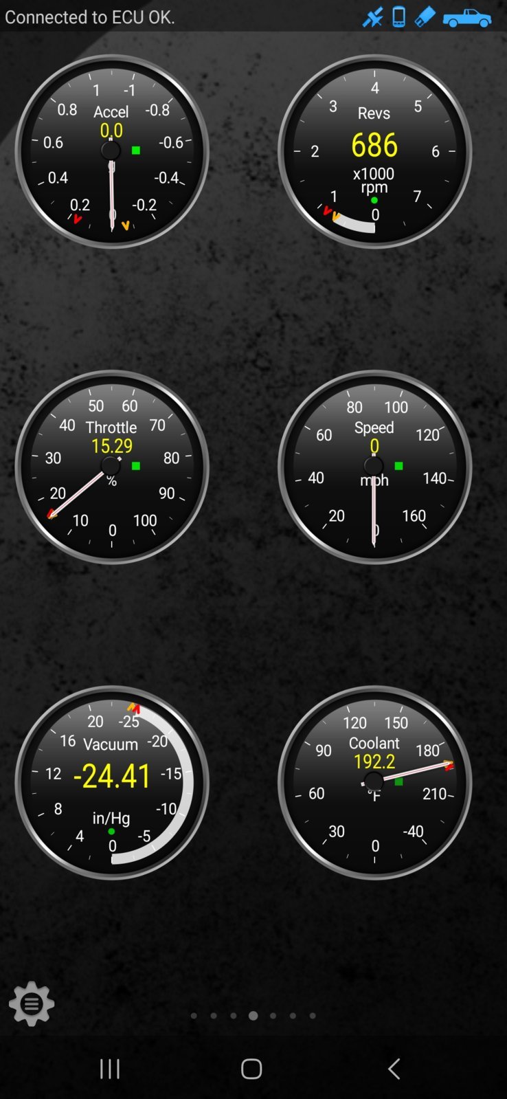

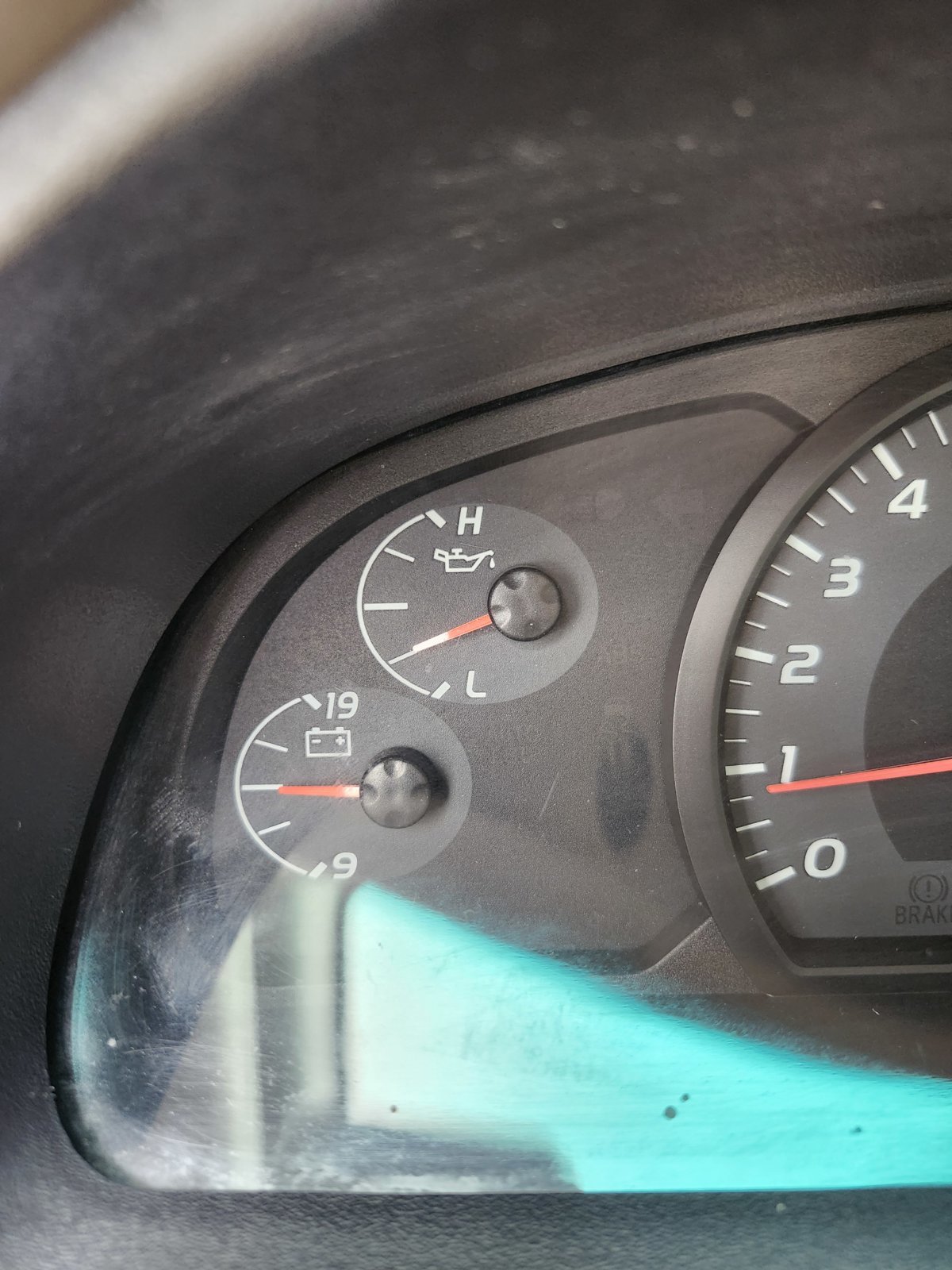

    No oil pressure has always bounced around, at idle it stays at the 1st hash mark and changes depending how I'm driving. I asked about it here and everyone said it was normal. No check engine codes or pending codes nothing on the dash I reset the maintenence light for the oil. I'm gonna disconnect battery now.
    Same with the seafoam I'm just being paranoid.

    Oil pressure is here during idle and bounces between here and the half way mark when driving.

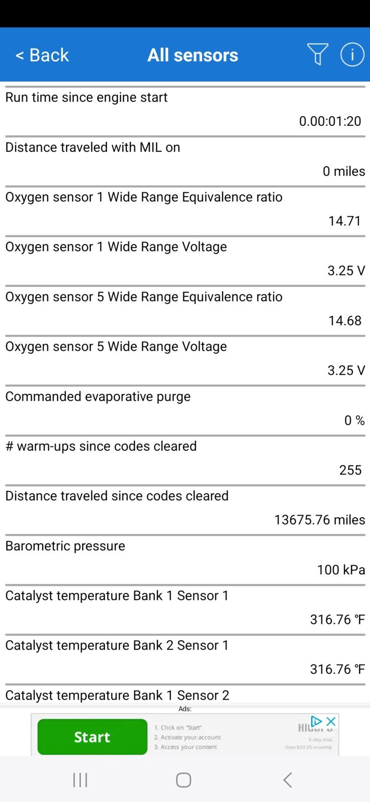

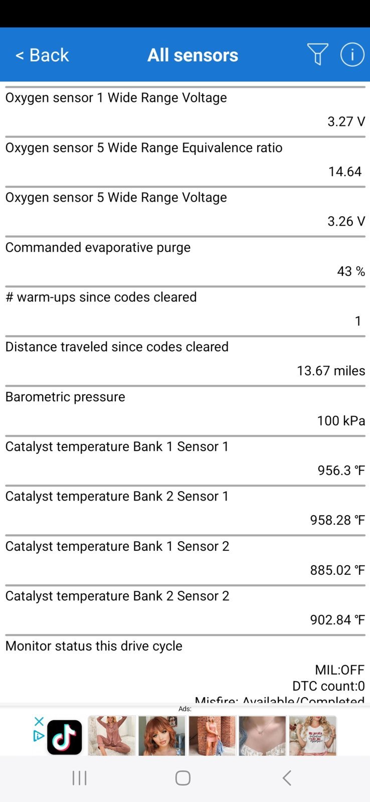

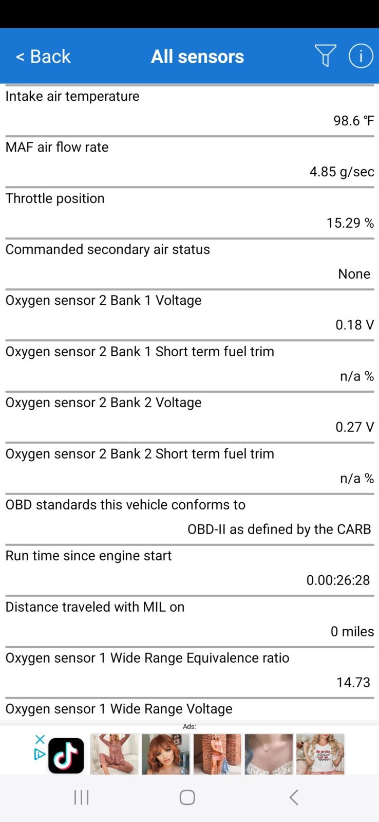

    Just got home after 26 mins and 13 miles. No change. No codes pending or otherwise. Using elm327 code reader. Going to take it to a shop for a ride along this weekend. But i gotta drive it 300 miles to Bremerton Thursday.

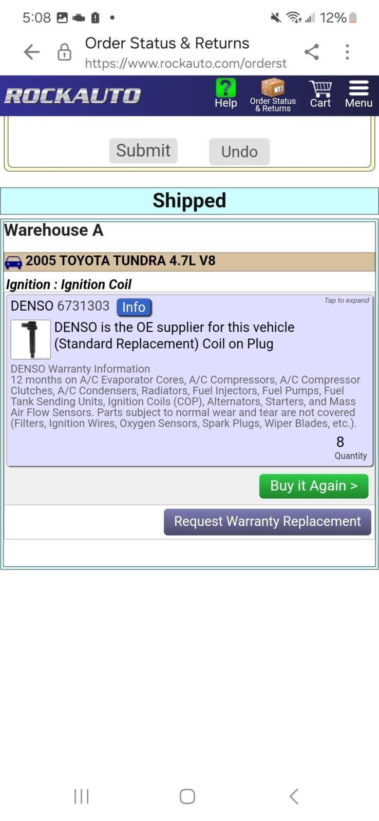

    Where'd the coil packs and sparkplugs come from?
    Amazon/ebay/etc. sell fakes all the time.
    Need a known good source, like a local parts store, summit racing or rock auto.

    They're from rock auto

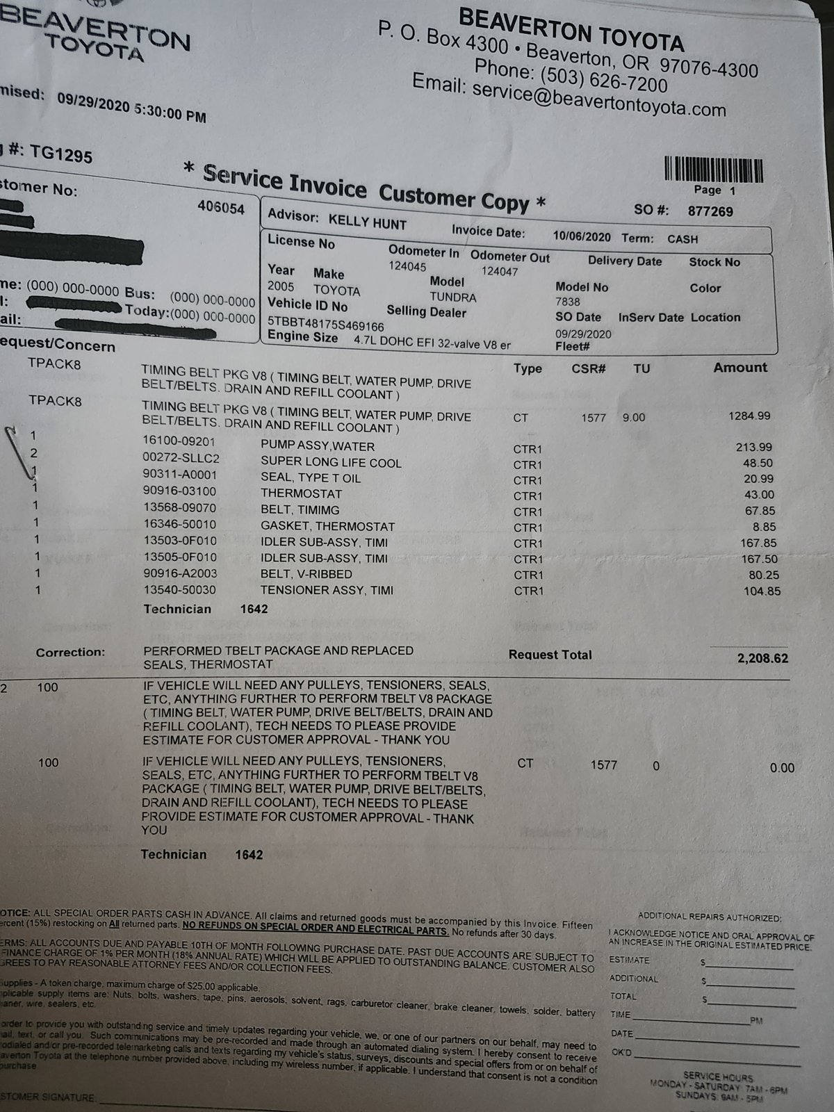

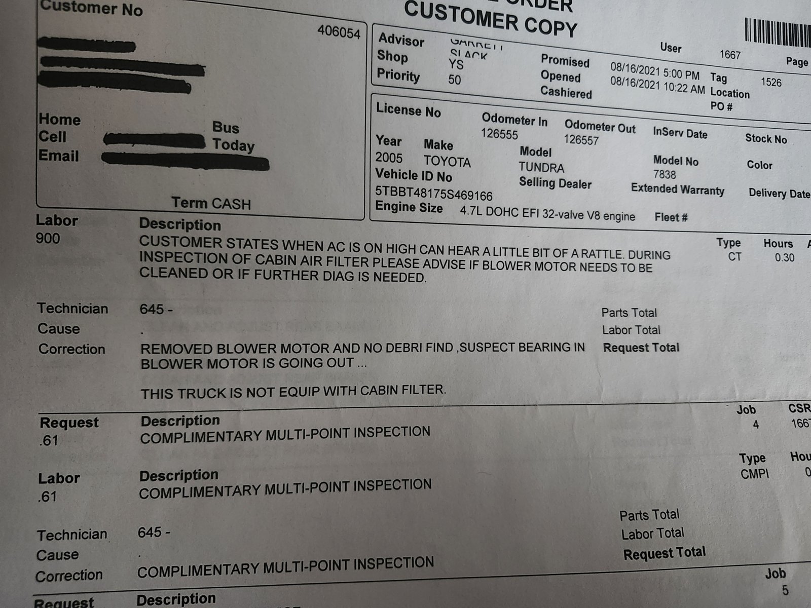

    I am going through the history now. Says check engine light was on in 2022 for air fuel.
    Also what's weird is the paper work says timing belt at 124k but the casing was never updated and says 89k.
    Also found the blower bearing is out and never fixed.
    I looked at this when I bought it but forgot most.
