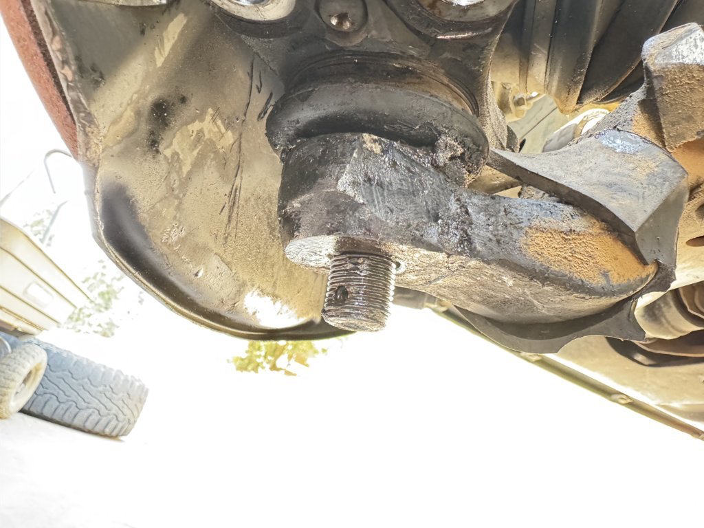

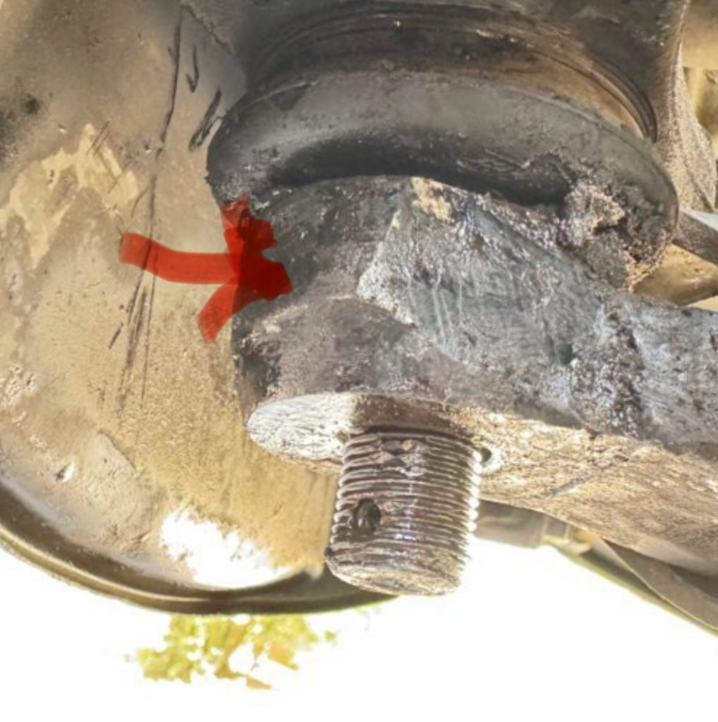

    Doing my LBJ’s. Passenger side done no issues. Driver side is stuck and can’t get it out.
    I’ve been hitting with hammer, bent the extraction tool and not sure what to do next…
    I’m a driveway diy’er with limited tools but a creative mind.

    I take it when you say stuck, you mean the part that sticks thru the LCA won't pop free from the LCA?
    Is the LBJ still bolted to the knuckle? Because it can be a real FPITA if you try to pop the LBJ out of the LCA if the LBJ isn't still bolted to the knuckle.
    Have you tried installing the castle nut on upside down until it's nearly flush with the top of the stud, then putting your OEM bottle jack post up under the castle nut, and jacking the truck to put tension pussing the UBJ upward, and tapping on the side of the LCA with a 3-5lb hammer to shock the mount hole the LBJ passes thru?
    Note you can rent a pitman arm puller from any local auto parts store.

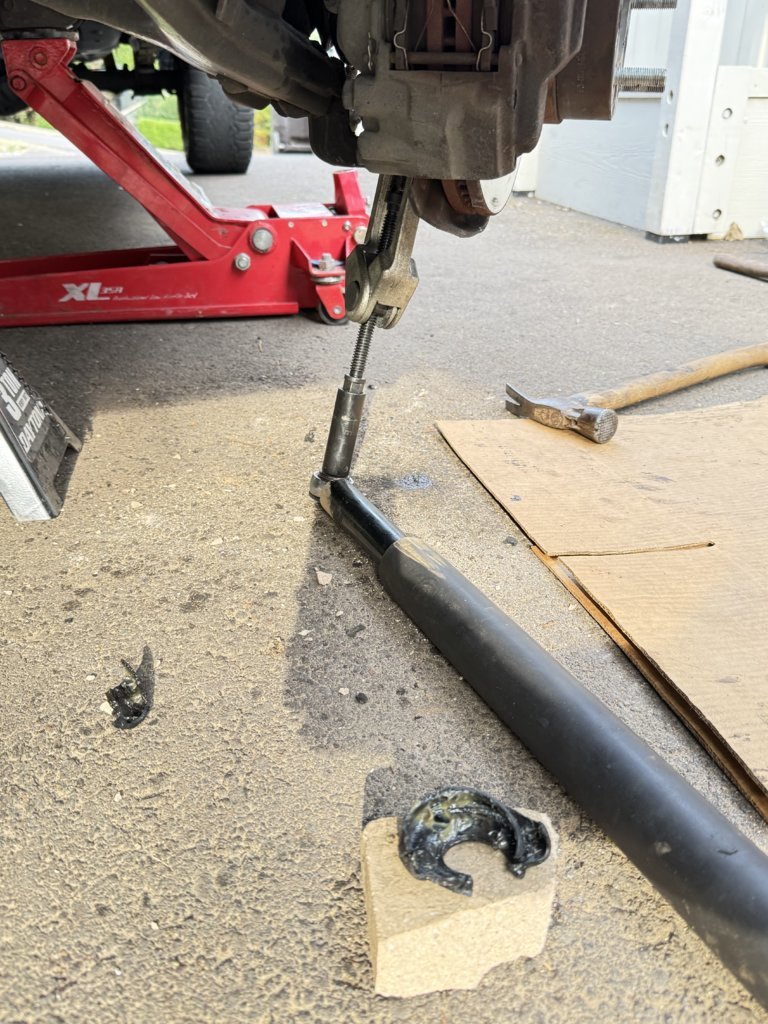

    This tool should help,
    ball joint remover tool
    jerryallday likes this.

    That’s correct. I did disconnect at the knuckle
    I haven’t tried the jack…
  11. Aug 24, 2025 at 3:36 PM
    Stuart503
    Stuart503 [OP] New Member
    Sunday
    #139763
    12
    I have that, trying now…
    can I strike it with hammer from below?

    1. PB Blaster
    2. Use this puller
    3. Don't expect the puller to completely free the taper, rather apply significant pressure and then use the BFH to persuade it.
    4. Beware that the joint will come apart with explosive force.

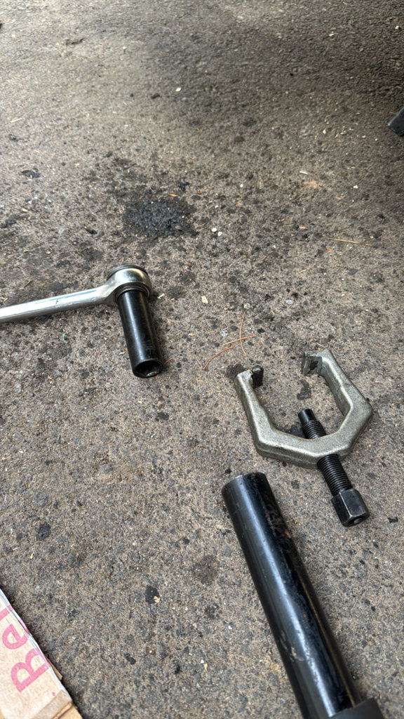

    I tried the ball joint remover. I tried the bottle jack (it just started lifting the truck).
    this thing doesn’t want to come out…
    what is actually catching it? The ball joint moves almost freely so what is keeping it in?

    This is just another recommendation for the jack on the stud, and a heavy downward hammer blow on the lower arm. I did this job a month ago and that is exactly how I did it.
    It helps to if you can find a heavy steel rod, place the end as near to the joint as you can, and hit the other end with your big hammer.
    You don't put so much pressure on the stud with the bottle jack that the truck lifts, its just to tension the lower arm enough that there is somewhere for it to move, raising the lower wishbone up an inch is good enough. The jack isn't pushing out the joint, its the hammer blow that actually does it. When you strike, strike like you mean it with one blow, you aren't taping it out, you are blasting it out.
    In my experience, ball joint remover tools only work on ball joints that don't need them anyway. I've destroyed every one I ever tried without removing the joint.
