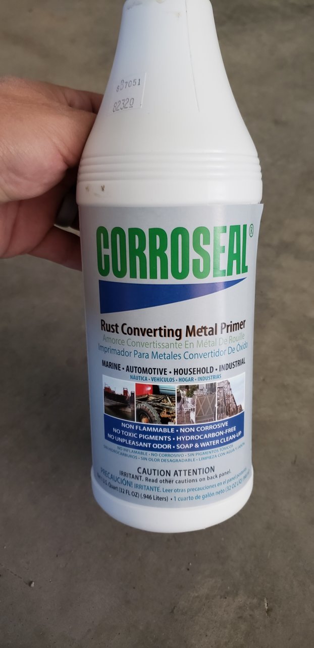

    Corroseal is the Sh1t! I just put that on my rusted 2014 frame i picked up that had been sitting, looked similar to yours. I was blown away, it Neutralizes the rust in 20 mins, and turns it back into a nicely blacked primed frame. worked on bolts, rims, hitch, leaf springs... i was blown away at results. Once it's neutralized, and no major damage was ever done, it'll be fine if you keep it clean, or paint over, or recoat every year if you want. it's easy to brush it on, warning though, it'll stain the crap out of driveway....
