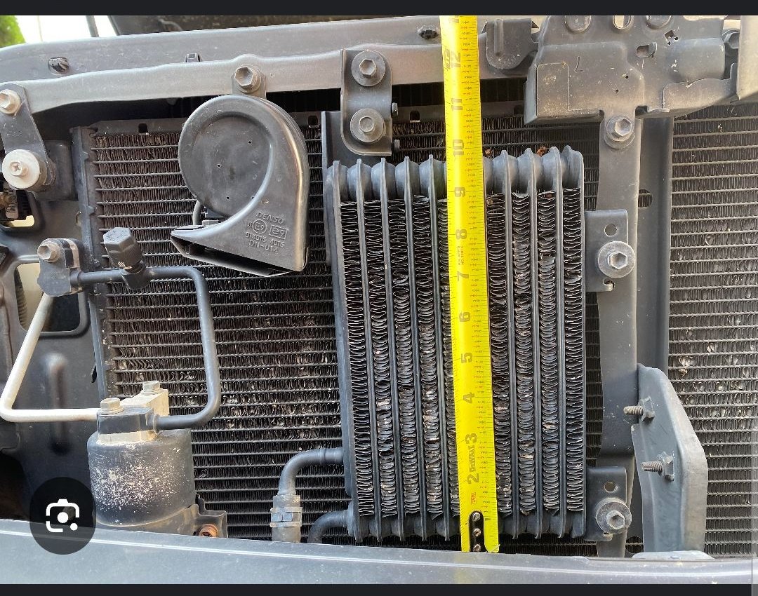

    Folks,
    The '04 Tundra I've posted about in the past had a tree run out in front of it out in rural Virginia. It was not repairable. We recently acquired a 2012 Tundra four-door 4WD short bed 4.6 with the towing package.
    The picture is looking straight down in front of the radiator behind the bumper. Is that the transmission cooler?
    Thanks,

    No. That's the power steering fluid cooler.

    This is what is should look like.

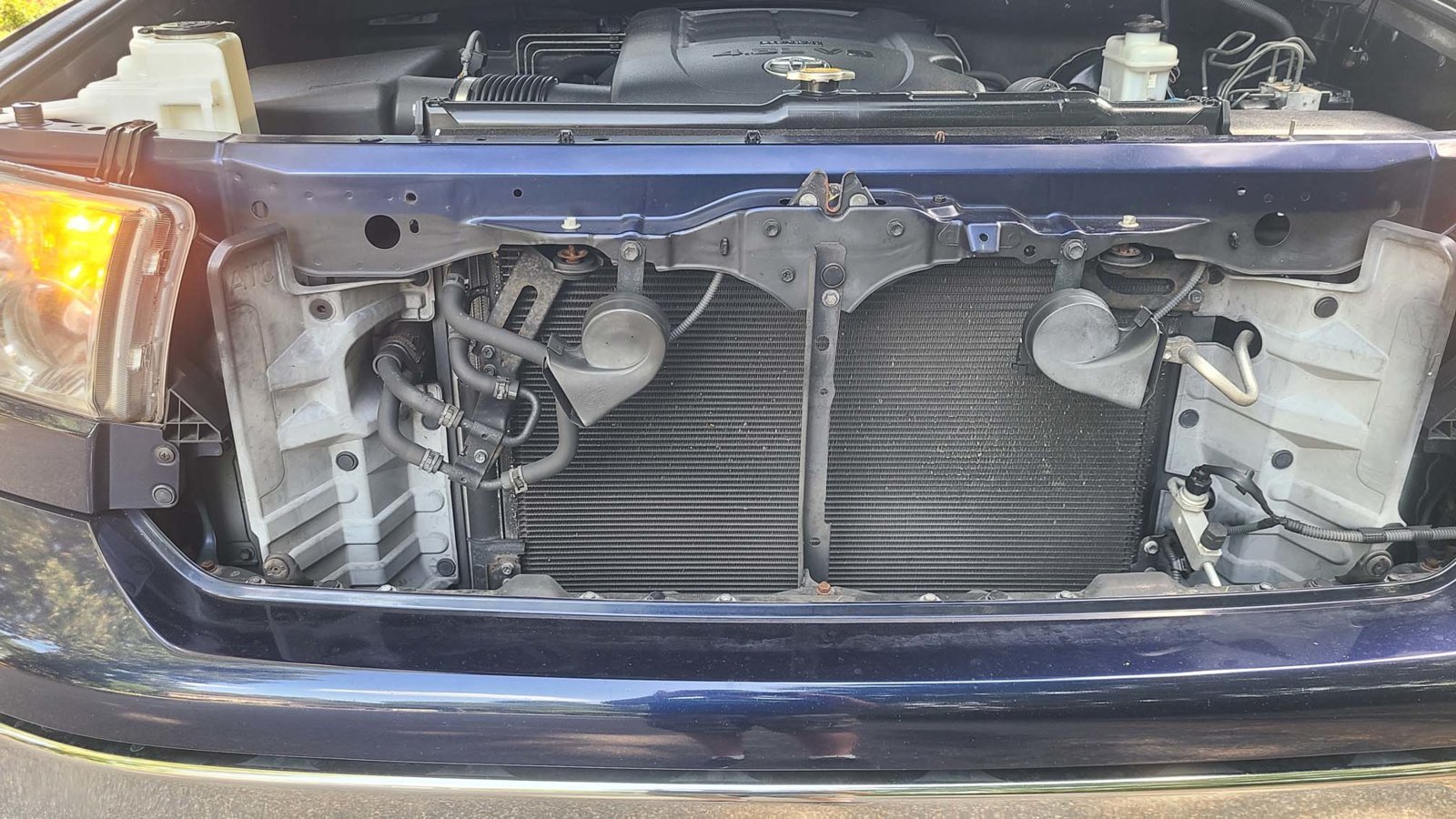

    Here's a pic of the front of the radiator. I see the S line pair Cruiserpilot mentioned.
    Seems like it would be easy to add a separate trans cooler. Is it necessary/beneficial?

    The S lines are your Transmission cooling lines. They are being effectively cooled with the top of your radiator. So you do
    have an effective Toyota transmission cooler right there! The top 4-6" of your radiator are cooling your transmission.

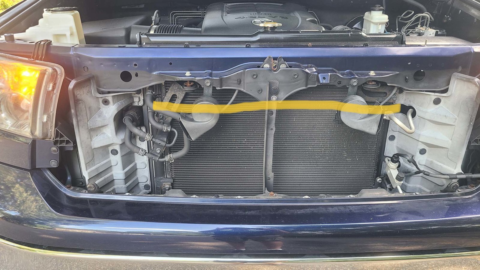

    Many on the way.
    Everything above the yellow line is a traditional oil to air transmission cooler, below is the AC. It’s manufactured as a single component.
