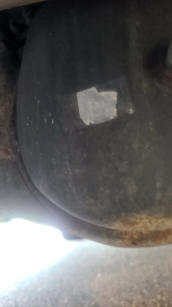

    Gents,
    I'm trying to determine if I have an LSD on my '07 2WD Sequoia. Factory tow package and 17 inch wheel option.
    Is that the remains of the LSD sticker I've seen in other threads? Sorry about the crappy pic.
    Thanks,

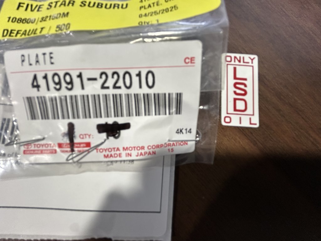

    LSD stickers are typically oriented vertically, above the fill plug IIRC on the Tundra. Not sure on Sequoia.

    I went to the Toyota site, created a login, and downloaded my info a couple of weeks ago. It didn't tell me the square root of eff all. It never mentioned the factory tow package, aluminum 17" wheels, and it even said I had fabric interior. It's leather.
    I can clearly see the outline of whatever that sticker on the diff is. Could someone please pass me the length and width of an intact sticker. I'll assume that's what it is if the measurements match.

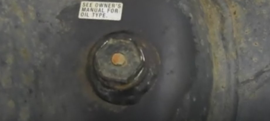

    PS: here is the normal location, shape/size of the LAD sticker I’ve seen for the Tundras: https://www.tundras.com/threads/wha...-gen-tundra-today.2558/page-2360#post-3930678
    Compare the width of the sticker to the width of the drain bolt for reference on size. But if you really want to know, since sometimes rear-ends do blow up and get internals replaced, you’ve been given above two practical ways to figure out, visually, with very little effort, how to know if you have LSD. The video method above is the “classic” way to tell.

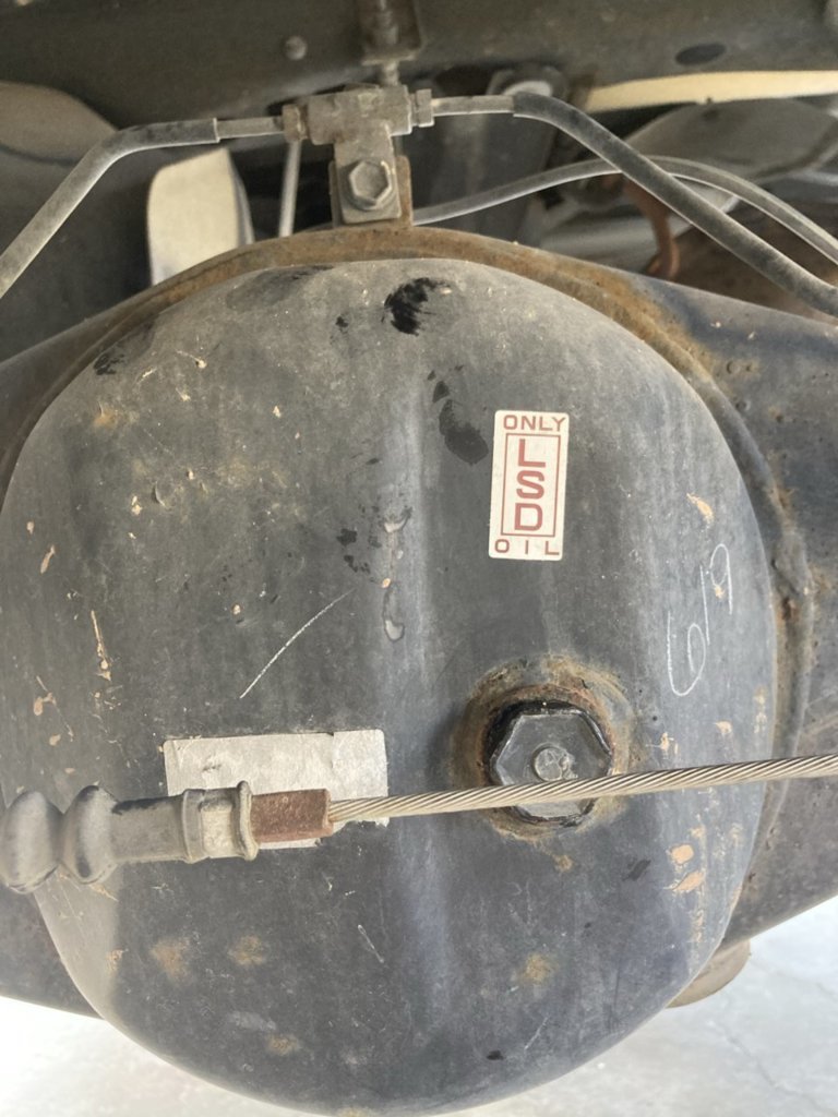

    Every one I’ve ever seen is like this

    What is/was the horizontal sticker behind the parking brake cable?

    Sooooooooooooooooooooooooooooooooooooooooooooooooooo, it is likely the remnants of the sticker I have are not those of an LSD equipped Sequoia. No problemo. It would be nice to know what that sticker was.
