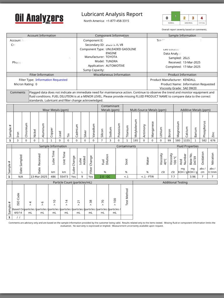

  27. Mar 17, 2025 at 11:03 AM
    #27
    TundraBot
    TundraBot [OP] New Member
    Aug 7, 2020
    #50469
    32
    2020 Black Tundra TRD OffRoad CrewMax
    Toyota tonneau cover (regrettably) N-Fab Podium steps Icon 2.5 IR front coilovers Icon 2.5 piggyback rear struts 1” blocks in rear with front diff drop 18x8.5 +30 offset American Racing rims 35x11.5 Falken Wildpeaks
    Hi everyone, just got the oil analysis results back and it looks good. Only concern is the mileage on the oil sample is really low (486km to be exact). I’ll do another test before my 5 year warranty expires when the mileage is higher, see if that changes anything.
    k0diak8o8 likes this.
  28. Mar 17, 2025 at 12:14 PM
    #28
    birdman076
    birdman076 Bird, bird, bird...bird is the word
    Jun 18, 2017
    #8174
    516
    Chuck
    Montana
    2015 Brown Tundra Crew Max Limited
    Airbox with K&N Filter, 2" lift on 33's, Alpine iLX-F309 head unit, Pull out bed tool boxes, brown with black trim, rims, etc, black leather interior, matching topper. Muffler delete (too loud..) 62k miles!!!
    I concur with this as well. I'm in Montana, we hit -40 here through winter a few times and I use the Tundra to drive down to feed the horses at the end of the property. At those temps it makes all kinds of noise when first fired up...Nothing likes starting in those temps but she runs fine and I always give it the proper time to warm up before driving down to the horses. Anything + temp and it doesn't whine as much (pun intended). As far as block warmers, etc we are off-grid so there isn't a feasible way to run one. Anyone wondering, I just did an oil change two days ago and everything looked normal, no metal in the oil or anything. Other than breaking a shock this year its been an amazing ride.
