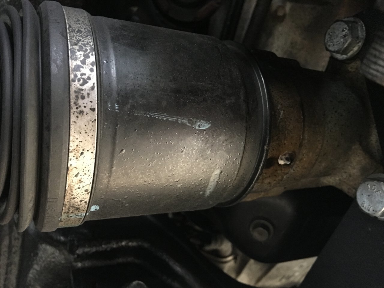

    passenger front diff where drive axle meet.
    What am I to expect? No puddle, however have a drop spot on floor x 2
    On a 6 inch lift. Keeping an on this
    6C48D7C4-0968-48BE-A574-9483524D8A1B.jpg D02CFB47-69A2-4B56-9758-E5D6AB9D0FDF.jpg

    Look higher make sure it’s not cam tower, valve cover or oil pan. Or anything in between.

    like suggested look higher see if anything is leaking down. but looks like probably a axle seal leaking, very likely with 6 inch lift see lots of leaky axle and pinion seal leaks on lifted trucks from all brands

    Used a white glove to swipe the circumference of shaft and dry. No trail leak outside of this area
    Trucks a garage King, and decided to climb under just to go look

    I changed the diff fluids late last year. Could I have overfilled it or as heard, check the breather if clogged?

    very easy. just pull the axle, carefully pry old seal out, find something same diameter as new seal like big socket that you can use to tap it in

    Checked diff-area again tonight and another bead of oil exist, so surgery is more imminent.

    Surgery complete after almost 6 hours. Was taking time.
    Hardest.... meshing the axle back into the diff.
    Just need to top off and am good. I forgot which fluid to use...hhhhmmmm
