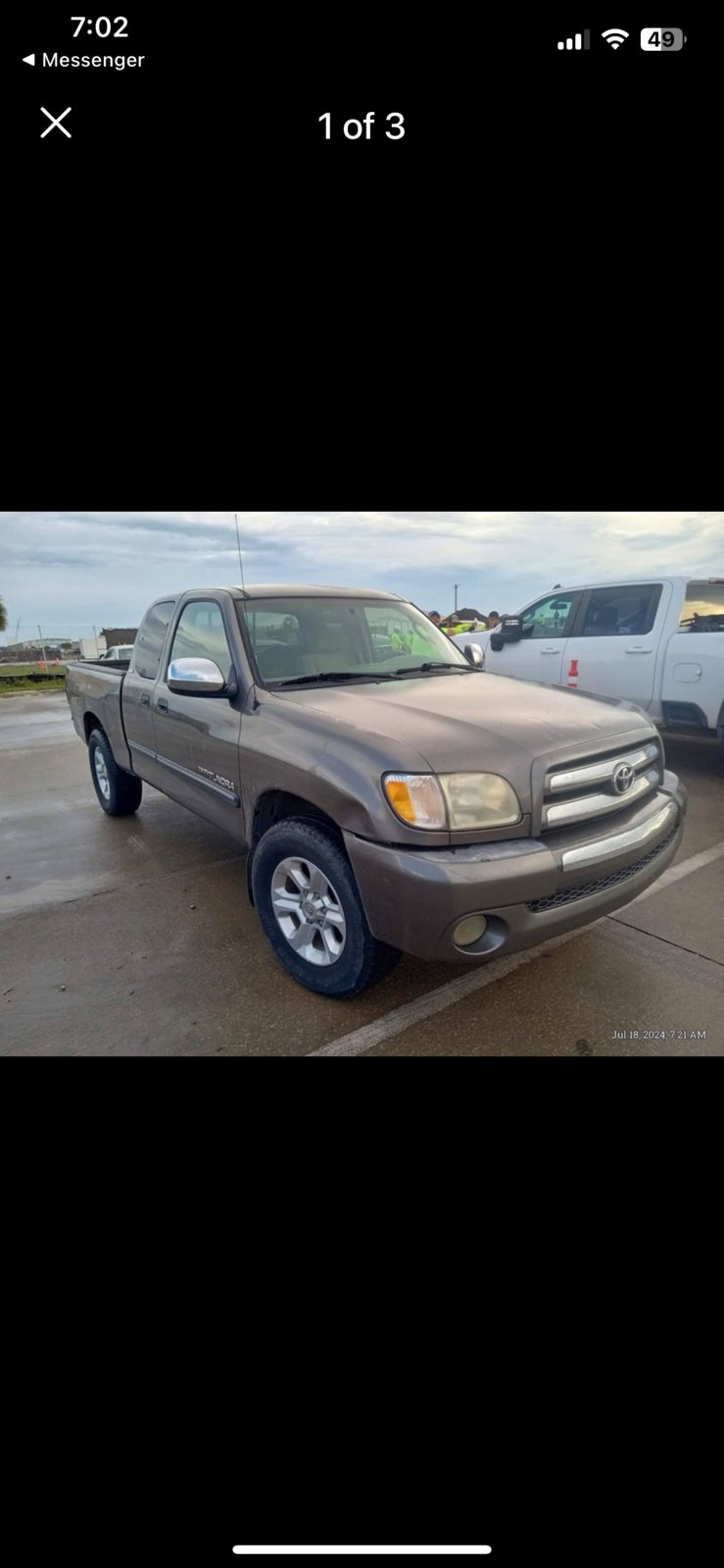

    That's not a double cab. And it does not appear to be a limited either.

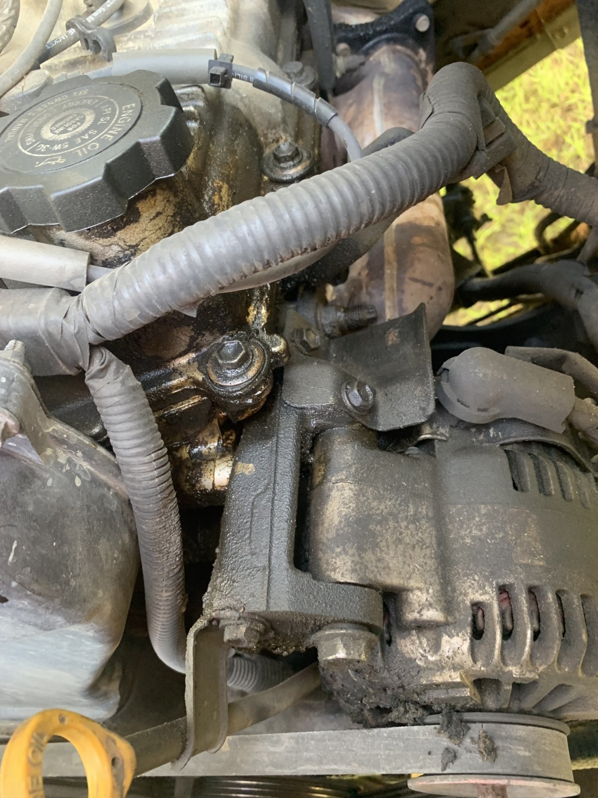

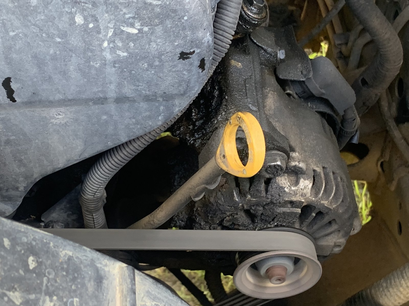

    Test drove the truck loud bc of the exhaust but no smoke. Did have oil (as seen in the picture I am adding) guy said that it is a seal leak and he has a guy that will do the work I just need to buy the part and he advised it’s not an expensive fix.

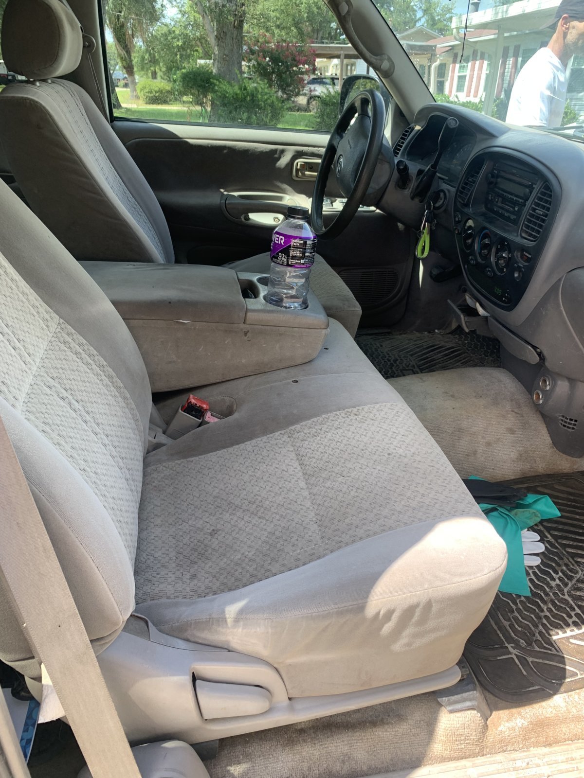

    It was 4 door seats in the back

    Its what is called an Access Cab. It has the rear doors that open up backward like suicide doors. A double cab has a larger backseat area with doors that open normally.

    That oil leak has been happening for a long, long time. I also see the timing belt was replaced last in 2011. That's a 9 year/90k mile item. I bet that truck has had 0 maintenance.

    Hard to read but does the sticker also say 107K? If so, that's 210K miles on that timing belt.

    Valve cover gasket Is what he said needs to be replaced my bad I think I put in the wrong thing

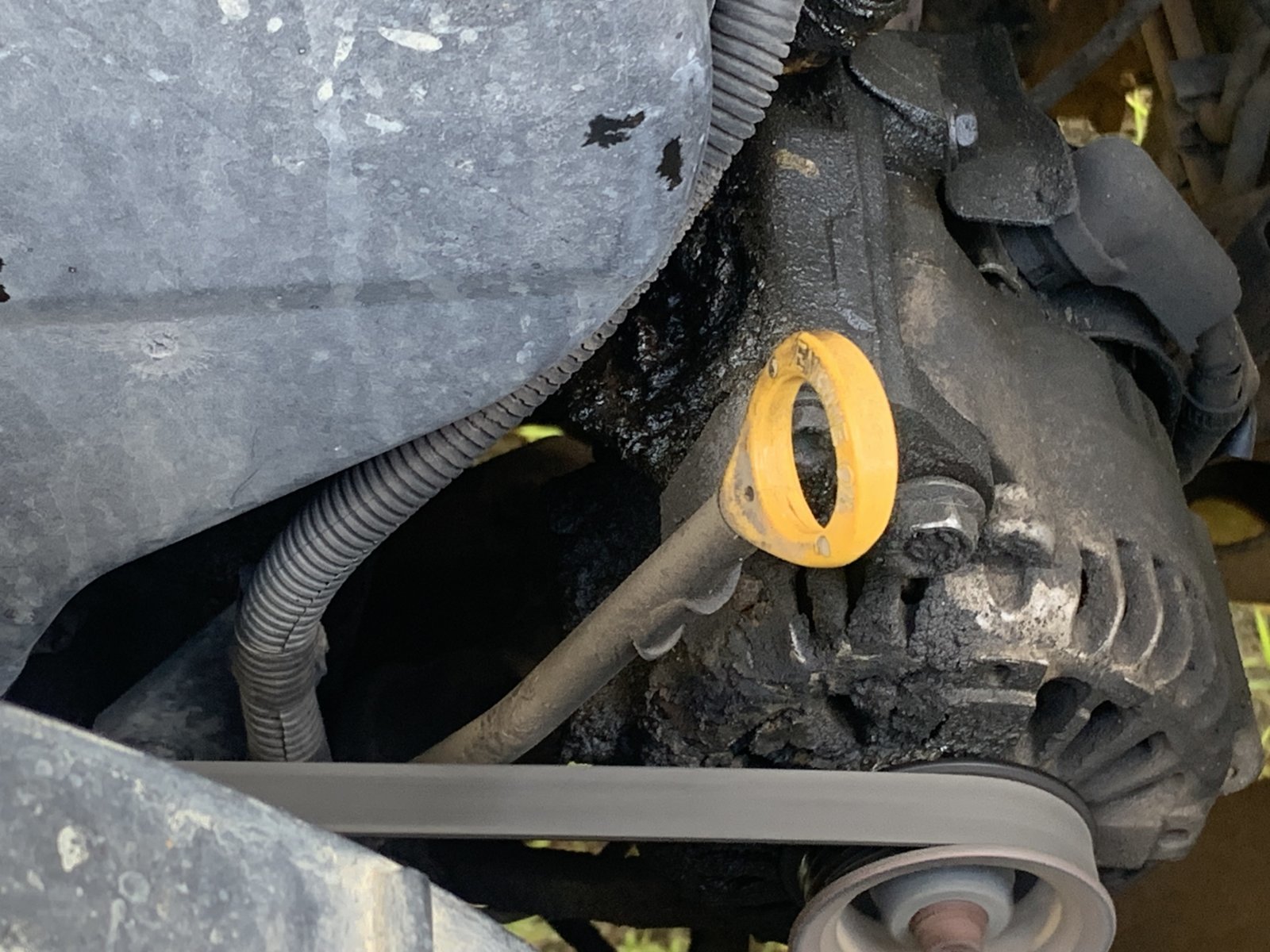

    Pass pass pass, you'll wind up spending 3k to get it fixed. That could be a rear main seal or almost anything with the amount of oil under that thing. If you were really serious take the VIN to Toyota and see if it fell under the frame recall, if so was anything done? My 03 Sequoia was under the recall but didn't qualify because it didn't have any rust that were all the way through, just surface rust. They treated it and gave it another 10 year warranty on the frame.

    Looked like a valve cover leak

    Yep like people say, that's a reasonable price, but you wouldn't be buying a "turn-key" truck. You'd be putting a few thousand into it. If you understand that, it's likely a great deal. If you only have a couple thousand to spend, and think you're getting a steal on a truck you'll be able to just drive as-is - no way.
    And yes, Access Cab, SR5. Not double cab, not limited.

    Valve cover leak on both sides. Looks like it could have been overfilled with oil given how high the oil residue is. I would expect to find a lot of other issues on that one. Personally, I would pass.

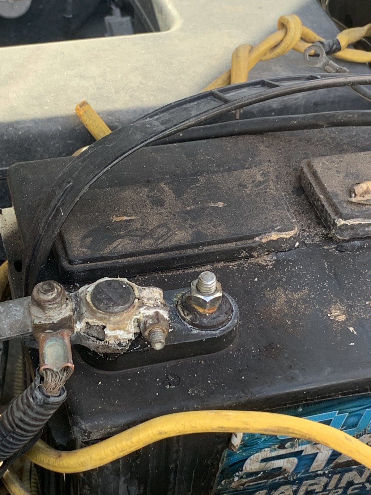

    Is that residential romex wiring under the hood?

    Yes, yes it is. Good eye.

    Sparky approved?

    Let's be real, that positive bat cable and terminal are in dire need of replacement.
