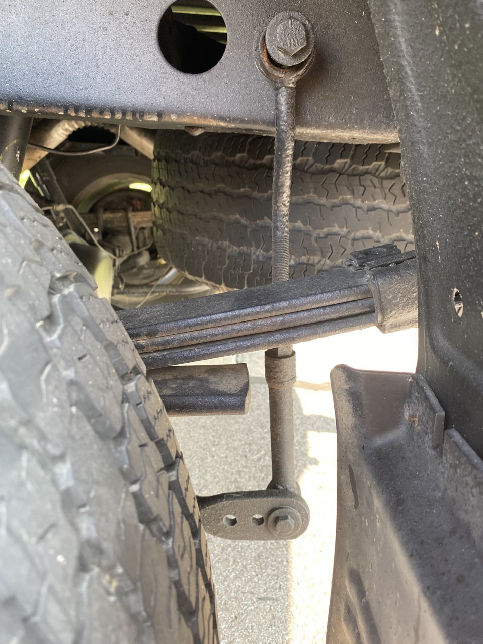

    Was driving and sounded like the whole rear end was coming out !
    found a missing bushing causing hall the racket but can’t seem to find parts.
    Is this some type of towing add on??

    There's a TRD rear sway bar which I thought was a dealer add-on, but I don't think that's it. Nothing from the factory I recall.

    2010 DC 5.7 2wd

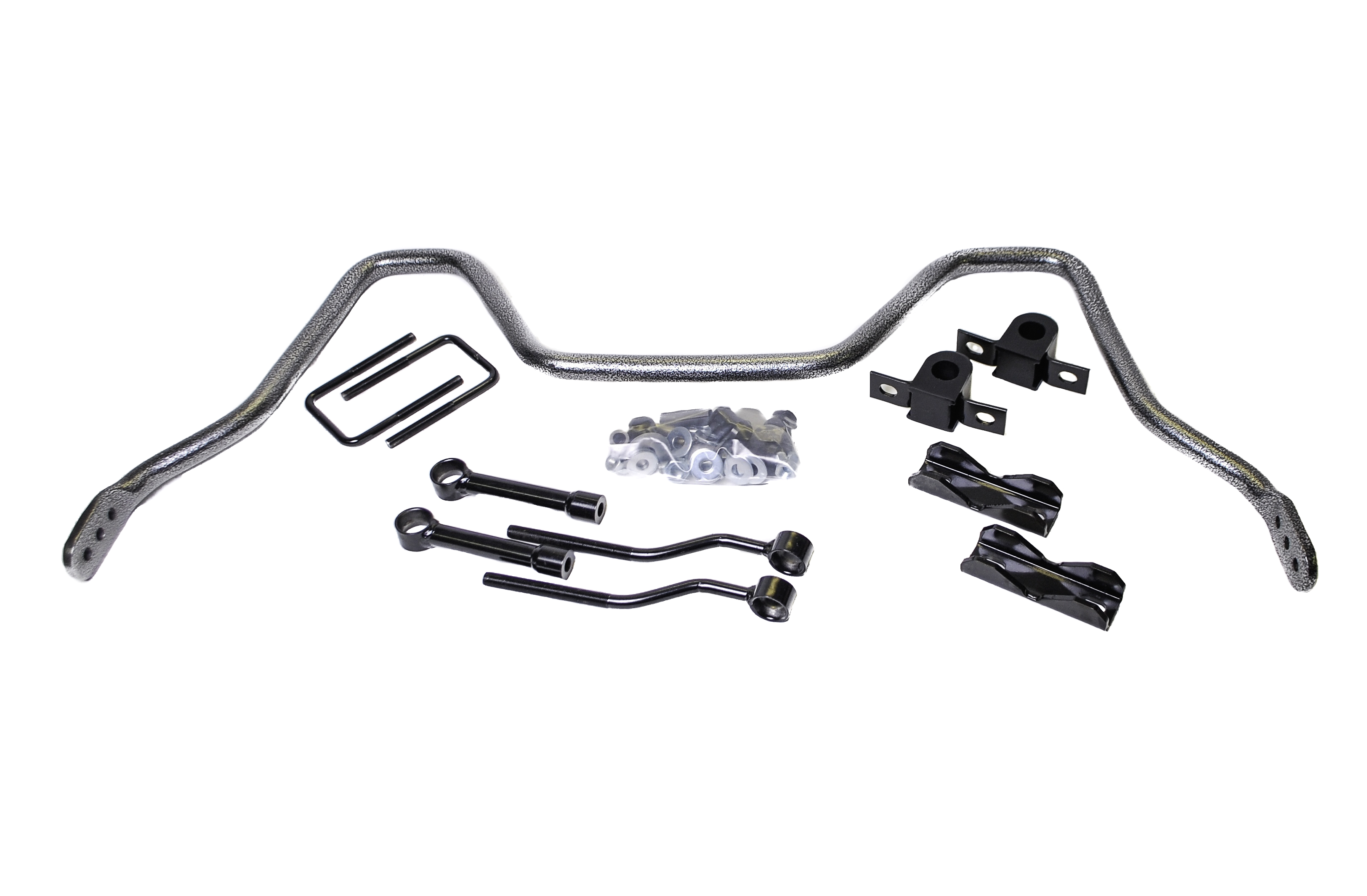

    Im guessing hellwig? The gen 2 model has adjustable mounts like that one

    That's probably a Hellwig rear swaybar.

    The bushings in them are rather generic. Take on into your LAPS and see if they have a fit for it.

    Yes, that is identical to my Hellwig rear sway bar I installed 5 years ago. When first installing, I accidentally mixed up the bushings and couldn't get them out. I contacted Hellwig and they sent me replacement bushings, I think for free or I just paid shipping. It would be worth reaching out to Hellwig to get replacements.

    If the bolts actually come out I’ll try to get bushings from them …if not I’ll scrap it.

    You could also pull the bushing from the other side and try to find a match. I would replace all of them in the sway bar setup if it were me.

    That’s my plan. Will see what the MFR says and let everyone know.

    Hellwig is fantastic! They’re sending out a bushing kit for no charge.
