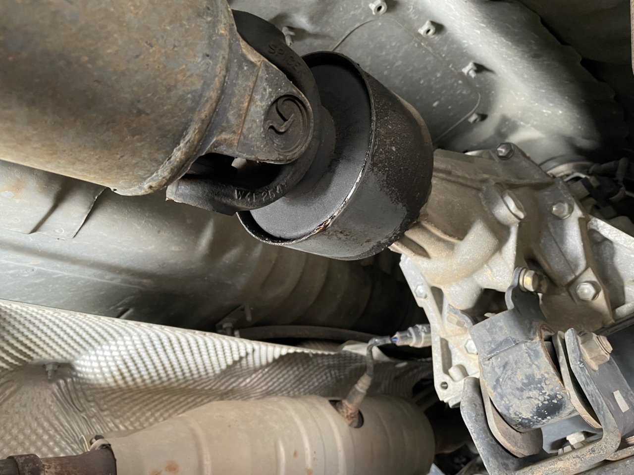

    When under my 2005 2WD DC today, I noticed a small leak at the union of the drive shaft to the transmission. I don't know what this is called. Might you know what the leak is coming from? Thanks.

    Transmission output shaft seal is what you'd be looking to replace.
    The driveshaft has a slip yoke that both slides onto the transmission output shaft and into the output seal.

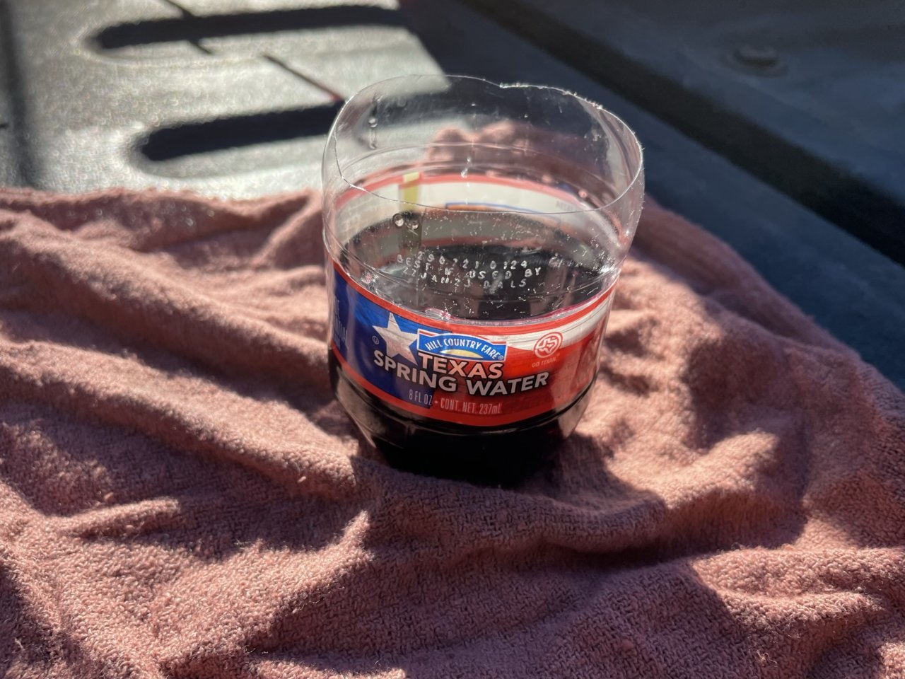

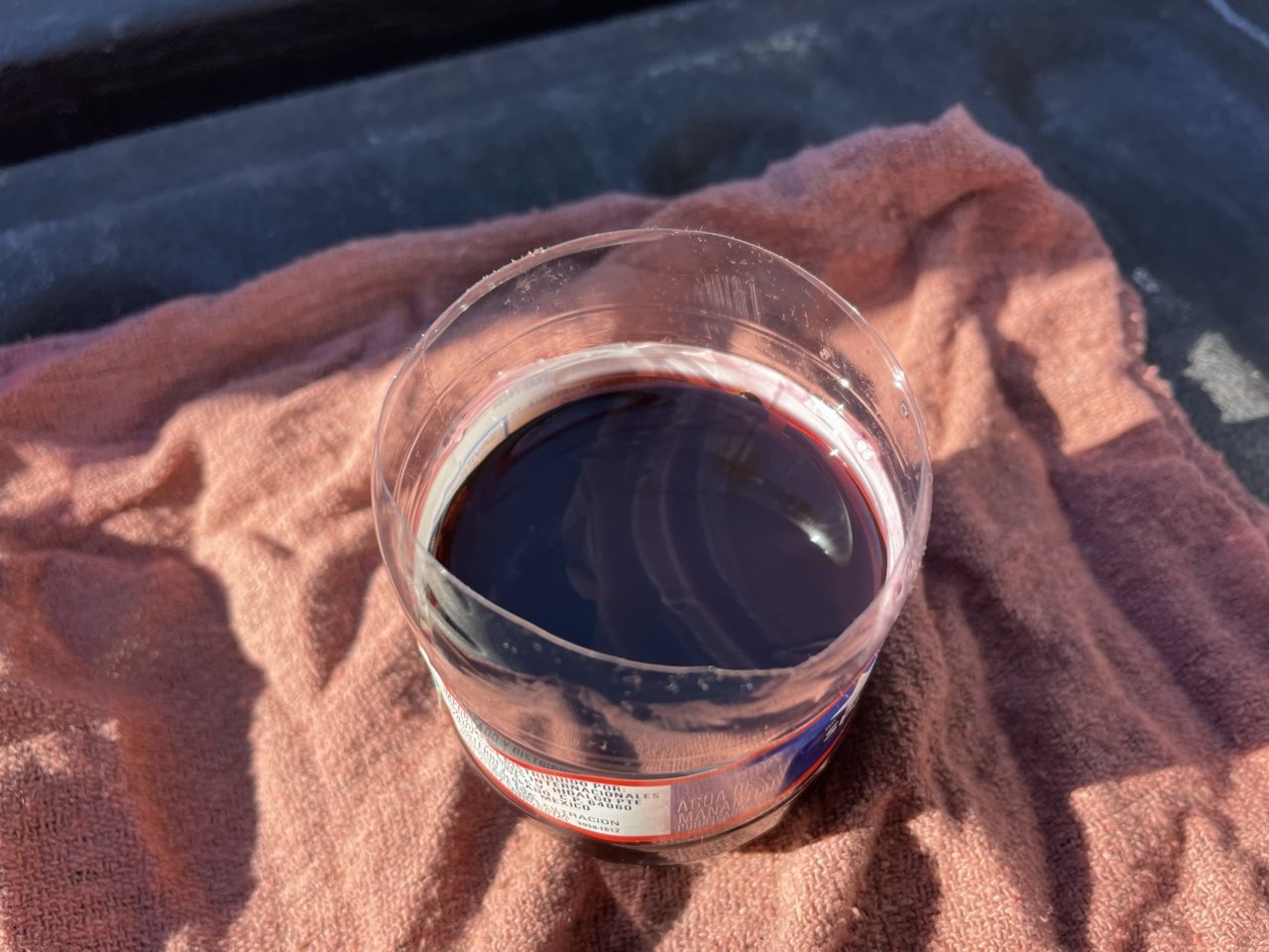

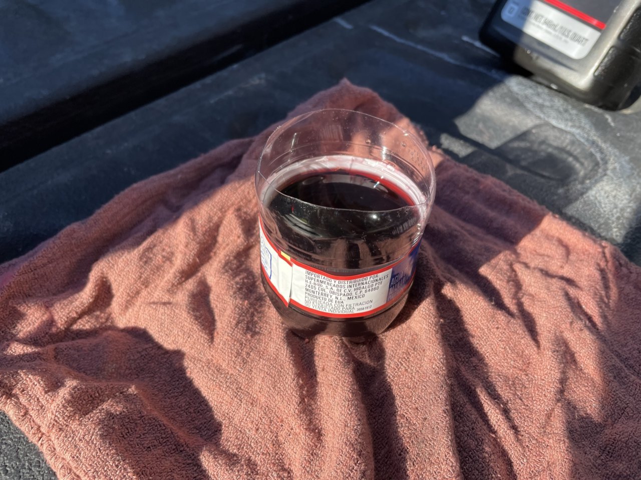

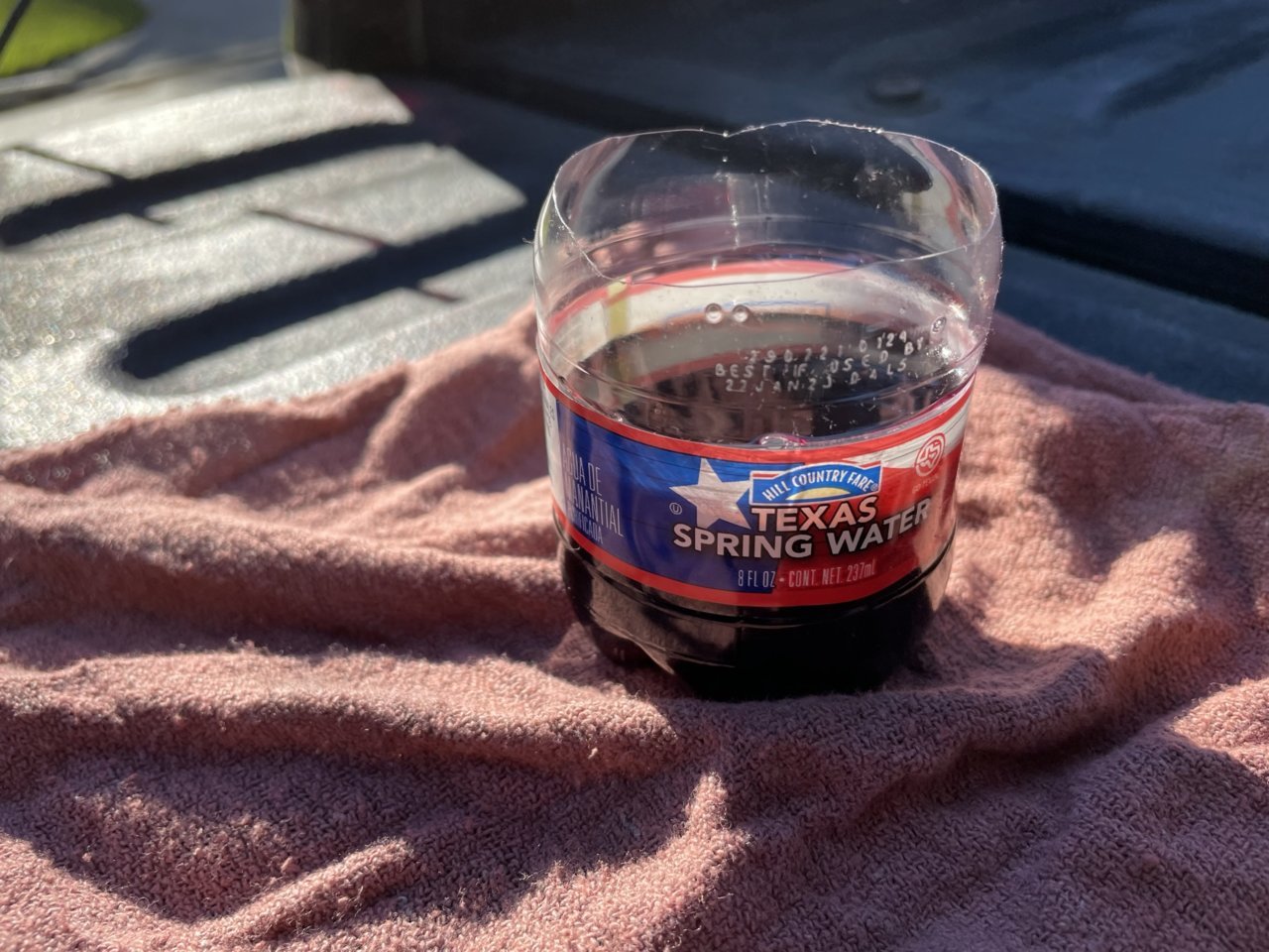

    For those interested, here is how the story unfolded. I checked in with NAPA and Advance Auto Parts and neither carried Toyota ATF WS. First learning. I purchased 12 quarts from the local Toyota dealership which was 9 quarts too much. Second learning. I took it to a local shop who drained 3 quarts and added 3 quarts. I was a little miffed that only 3 quarts were replaced but that seems to be the recommended amount. The filter was left alone. The truck was shifting fine before and is still shifting fine. I need to get a few extra tools and maybe a buddy if I am going to fill the sealed transmission at home. I have seen one guy do so on YouTube and it looks tricky. I think that the old transmission fluid didn't appear to be extra dark.
    Here's my big takeaway. I talked with a local independent shop who suggested leaving the transmission as is. I called the dealership out of curiosity and he said not to do so because the sealed transmission is good for the life of vehicle.
    I am glad that I went with my gut and with the advice from this forum. Thanks to all.

    Appreciate the follow-up. The fluid does look a little dark, but I prefer to water-paint it onto some white card stock to get a real key on how it is.
