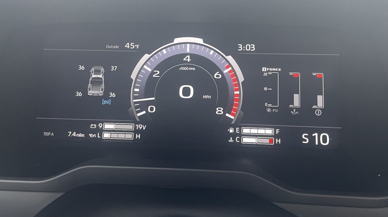

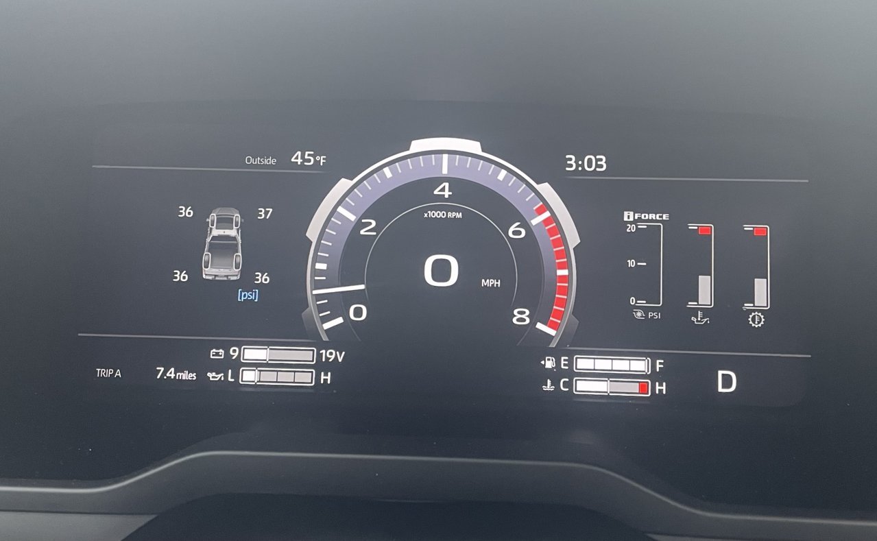

    I’m not sure if it’s different in the non-digital cluster but when I pop mine into sport via the shifter my digital display shows the gear where it would normally show “D”. On the highway it always goes right to 8 and I can toggle up or down. Yes it is hard to get it into 10th unless you’re really moving. I’m surprised the non digital display doesn’t show the same thing.

    Here’s it when I click shifter over and toggle through gears

    Interesting looks like us non hybrid peasants got the shaft.
    Thanks for finally posting pics as well

    Ha, I’m a non hybrid peasant too. The digital dash was ONE of the reasons I went with the Platinum over a Limited

    Oh didn't think you could get dash unless it was hybrid, interesting, will keep a lookout to swap in the dash then from the upper value trims, reprogram your mileage in and hopefully plug and play, it was this way for the 4th gen ram

    A lot of wrong info in this thread.
    The S on the shifter is not “Sport”. Toyota calls it S mode for “sequential”.
    The select top gear is S mode is shown on both the digital display and the standard instrument cluster.
    Whatever gear you select will remain until you change it. However, the transmission still shifts through all the gears normally up to the selected top gear. So if you choose S4, it will shift 1-2-3-4-3-2-1 normally just like if you were in D but won’t go into 5th.
    There’s no way to display the current gear. You have to count or memorize what RPM at what speed is what gear.
