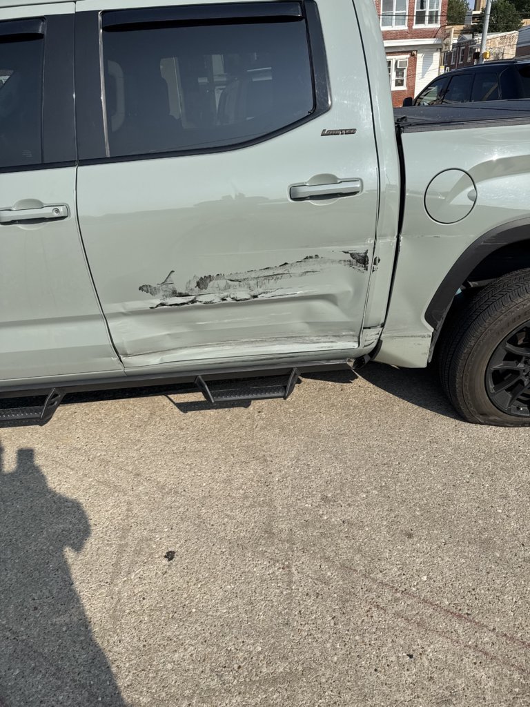

  8. Aug 31, 2025 at 5:56 AM
    JDAZ
    JDAZ New Member
    Sep 3, 2024
    #122318
    143
    John
    NJ
    2022 Lunar Rock TRD Limited
    Chrome Delete, TRD Pro Grill with BD light bar & OEM switch Beatsonic Amp Undercover armor flex cover
    This is how I found out what panels were what.
    Getting fixed now to the tune of 14k. I guess aluminum is tough to fix which is good as I wanted new metal.
    Rear doors- steel (replacing)
    Front doors - aluminum (very small dent)
    Rear fender panels - aluminum (replacing)
    Cab- steel (replacing the “D” ring)
    Hood- aluminum
    Tailgate- steel
