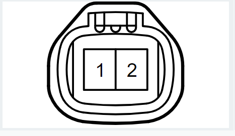

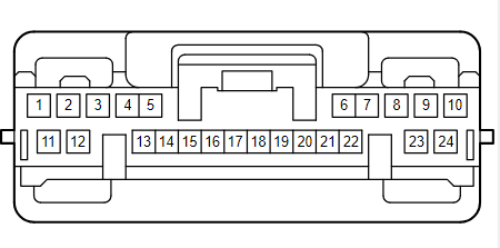

    You're not the first person who find the back window switch weird. Toyota really confused people moving it from the dash to overhead console. But the switch works same way. It's really how you interpret it. You're pushing the switch in to pull window down. And pulling switch out to pull window up. Just like the window switches on your door panels, just mounted up side down.
    I'm curious now though if you can remove the wiring harness connector on the overhead console switch and then depinning the connector and swapping it. Basically swap terminal pin 21 and 22. Or taking the connector off at the motor and swapping pins there.
    Connector on overhead console switch.
    Connector on motor:
