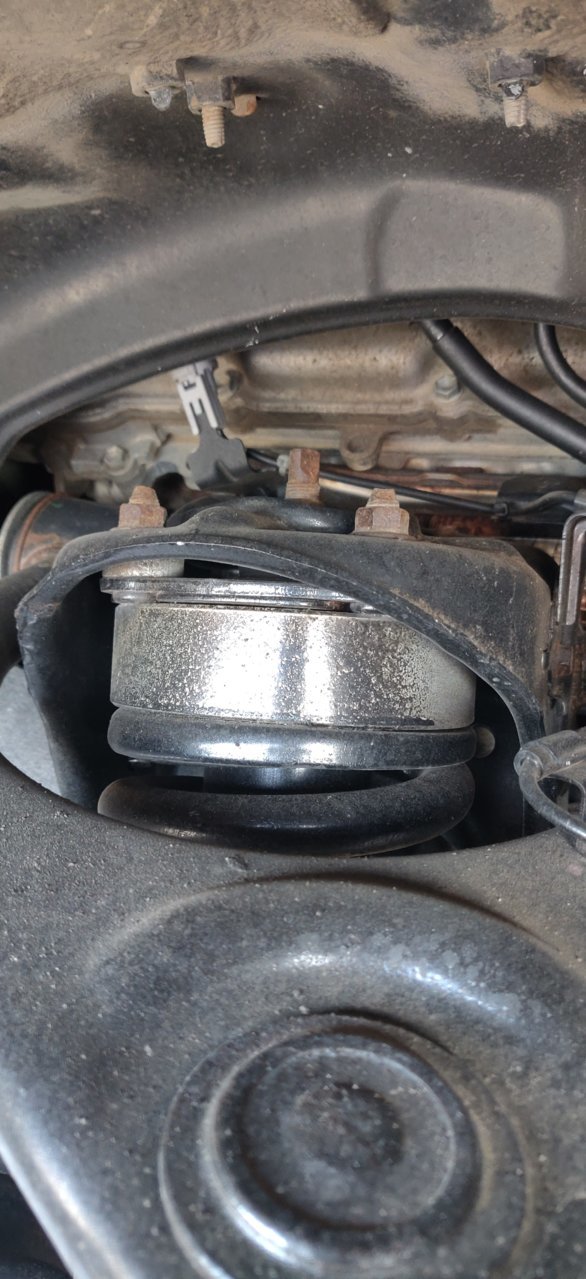

    Well title pretty much says it...

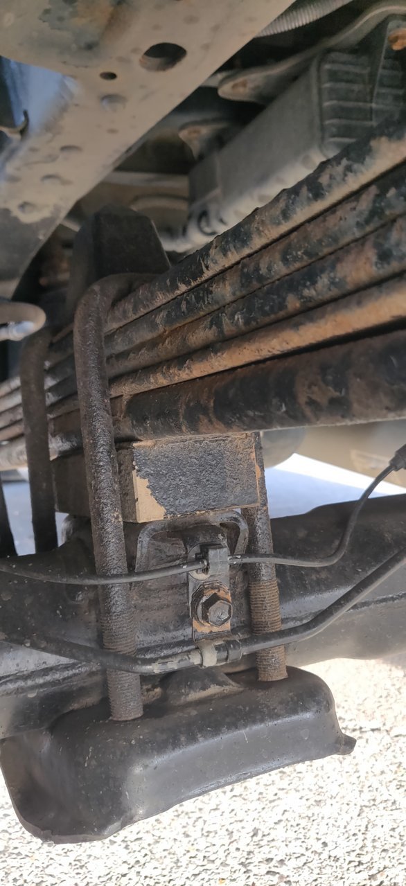

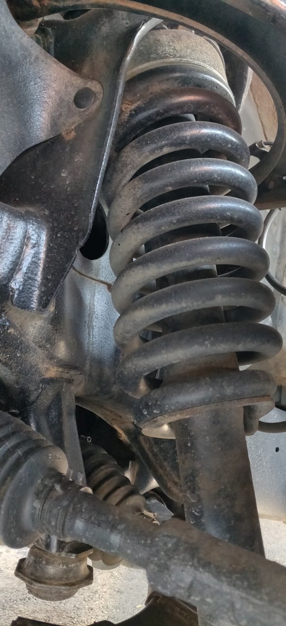

    I'm suspecting the silver hockey pucks and blocks under the leaf springs are a cheap solution to lift the truck?
    I bought it this way.
    Not knowing much about tundras I didn't spot it.

    Looks like it.

    Yep common spacer lift. Swap out for coil overs / shackles if you want a better ride.

    yup...spacer lift front and rear

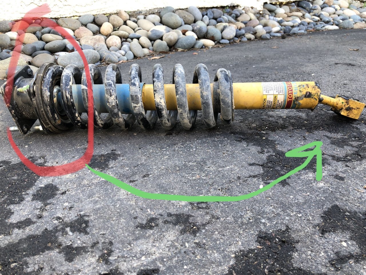

    Here’s my cause (red) and effect (green) picture.AF0759F4-C031-4274-9787-7C1786C4F6D1.jpg
    Your spacer looks a bit different, but same idea.

    Damn, back story on that? What were you doing when it happened?

    I don’t want to hijack this thread too badly, but it happened while running hard with far more capable trucks for a few hours. My truck was 8 mos old at the time.

    Did you have bump stop extensions installed when this happened?

    It was a 3/1 leveling kit (Nitro?) so these things had been added to rear (else stock):98D581D0-FFC3-4687-B863-3758A9374124.jpg
