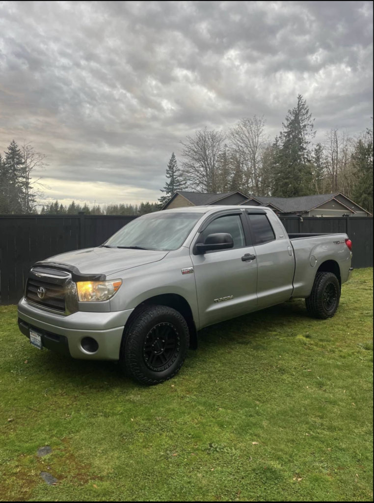

    I recently purchased my first truck and I think I got a pretty good deal. The truck is clean and runs well and it came with TRD stickers on the bed but I know you can just buy them online and slap them on so I was curious if there is anyway to tell if it’s a true TRD by features it has? Any help would be much appreciated. Thanks in advance for any help provided.

    TRD Offroad models got stickers, Bilstein shocks and some beefier / extra skids for like the transfer case and gas tank. You can enter your VIN on the Toyota site and see what it came with from the factory. TRD packages are factory installed, not add ons.

    I'm not sure if I would really care. Both of my Tundra's have the off-road package. With age means the shocks either will need replacing soon or have already been replaced. The skid plate on my '07 is nothing special. Besides I'll never take it off road where it'll need the protection. Some of the off road packages did have nicer wheels and grill but the package didn't include that in 2007. BTW nice looking truck. You just need to think about replacing those headlights. Once they start to fade/ scratch they make the truck look dated.
