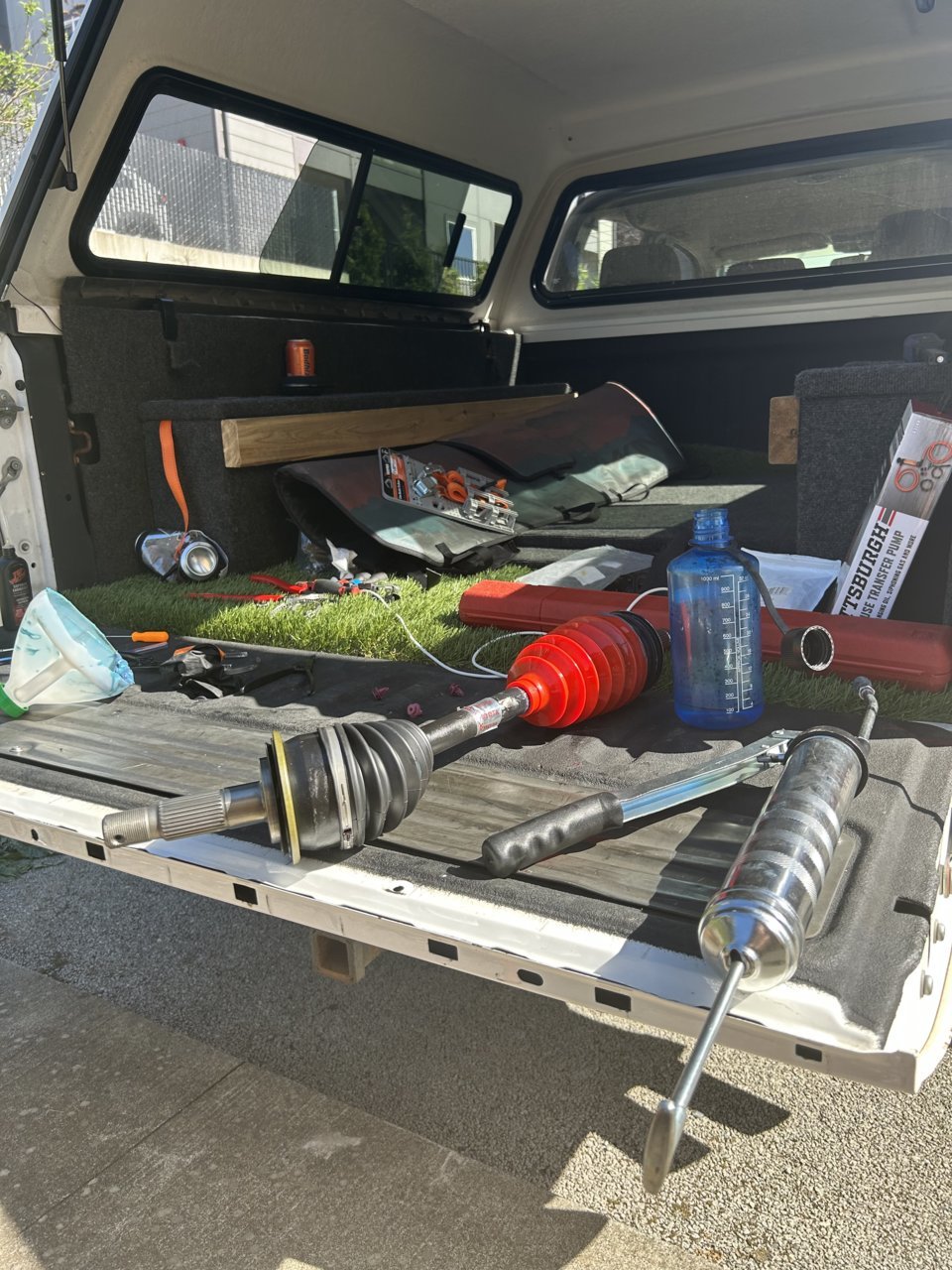

    Just installed the ECGS bushing and can boot on this reman axle. It really doesn’t want to move anymore. Wondering if any of you guys with the ecgs noticed a difference.

    That looks fine to me. You heard and felt it pop past the circlip? That's what keeps it from coming out.

    i didn’t really hear anything, I was lightly tapping but it definitely won’t pull out rn. Looks like the silver ring is still visible as if it needs 1/8 - 1/4 in more. Tried rotating ,tapping the flange and tapping the end in straight.

    It won't seal flat against the diff housing like your aftermarket CV is doing. On your top picture, I see the dust seal that stays on your CV in that small gap. When the truck is on it's own weight, the gap might appear smaller.
    As long as it's in there straight, past the snap ring, it can't come out easily.

    gotcha, alrighty I’ll put it together. Thanks dude I appreciate the quick reply I feel much better about it.

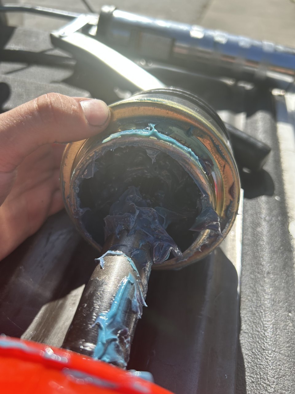

    Isn't the grease supposed to be a really runny consistency?

    No, it’s like peanut butter, I had to use a paint stir stick to slop it into the CVS

    Interesting. I've never done one on a Tundra, but when I've done axles on cars the lube could be poured in/out of the boot. Thicker than gear oil, but not as thick as conventional grease.

    It’s just like regular old grease on every one I’ve done. Never seen any liquid. That’s probably a bad sign?

    Only time I’ve ran into grease like thag is water contamination

    There was a video on YouTube someone posted recently showing something related to rebuild or install of axles, I think it was an OEM axle re-boot kit reinstall. Really really good video from a mech who clearly knew his Toyota. He was given two packets of grease for his, one was the consistency of gear oil and the other the consistency of thick syrup. Was scratching my head also, I hadn’t seen anything that loose either.
