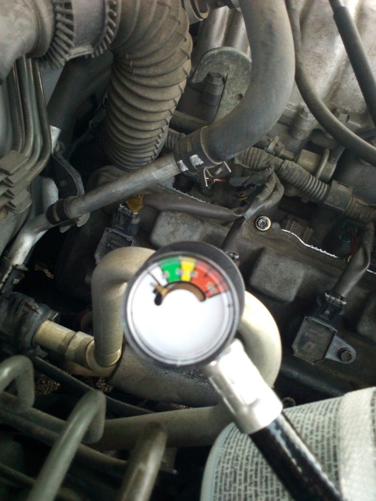

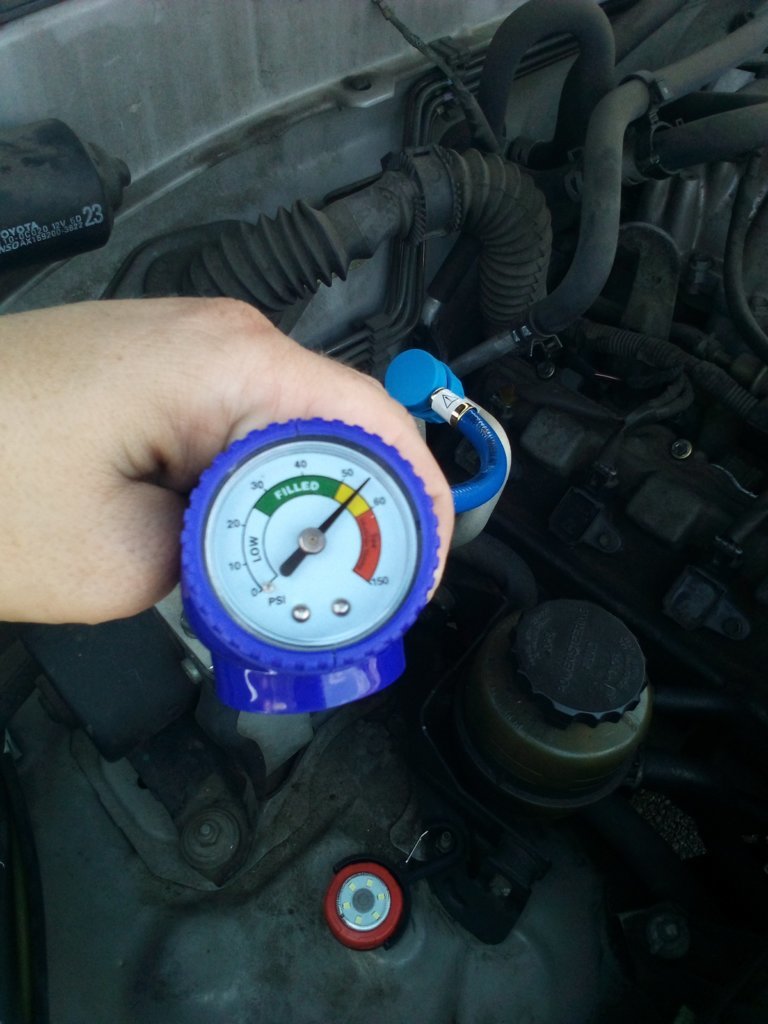

    For one, I live in the south where it gets very humid, which seems to compound how hot it feels. I know the truck is 20 years old so I don’t expect it to be perfect, but even when I’m at operating temp it still feels as if the AC is lacking. I have already cleaned the coils out underneath the glovebox and it helped slightly, though it was very hard to even get all the gunk/trash out through the little hole and there’s probably still gunk in there.
    I thought maybe my system was low on refrigerant so I purchased two different brands of refrigerant. (* reason being for buying two- I wanted to see how the pressure gauges compared to each other, and wouldn’t you believe it, they both read the exact opposite of each other)*
    I don’t know what to make of these 2 readings. One says it’s past full, the other says it’s so low it won’t register. I took the readings with the car on and AC at full blast
    Im a little scared to fill it with refrigerant at this point. I had the system recharged 5 years ago in a friends garage (done with “professional equipment “)

    Unless you have proper training and equipment, I would advise you to take it to a specialist AC repair shop.

    The second pic, you're taking that reading with the AC running, right? Honestly, it's much easier to do more harm than good unless you know what you are doing with these. Those LAPS AC refill cans often contain a lot of crap that do not help your AC at all. Do some research on local AC places and have them at least diagnose it.

    Both pictures are with the car running and ac on full blast. The reason I bought 2 different gauges is because in my mind I thought “ I bet if I buy 2 different brands of gauges I’ll get 2 different readings, so I’ll just take the average from the 2 to get a more accurate reading “
    Well I never excepted one to say it was empty, and the other to say it’s past full….

    Never use the cheap gauges supplied with the refrigerant in a can, they never read correctly. Always uses quality gauge.
    Definitely take it to a reputable shop if you feel it’s not blowing cold enough. They can discharge the system and refill it with refrigerant with added UV marker dye. You then come back in a week or two and they’ll point out the leaks in a system.
    You can then go from there how you want to proceed. Live with it, pay to get O-rings and and schrader valves replaced as an example or figure out how to do it yourself although you’ll need a garage to discharge it so you can work on it then refill it.

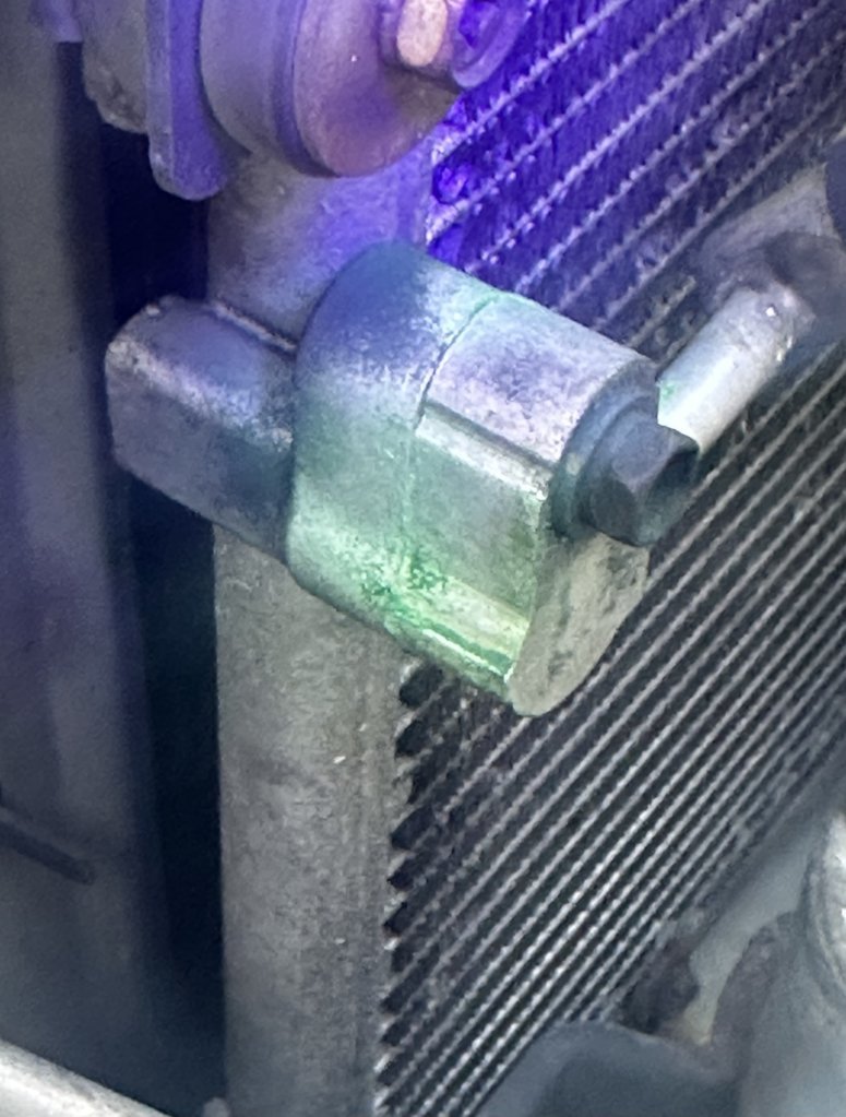

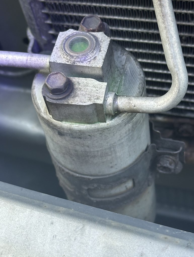

    An example of my leaks (green) when using a UV flashlight (purple).
