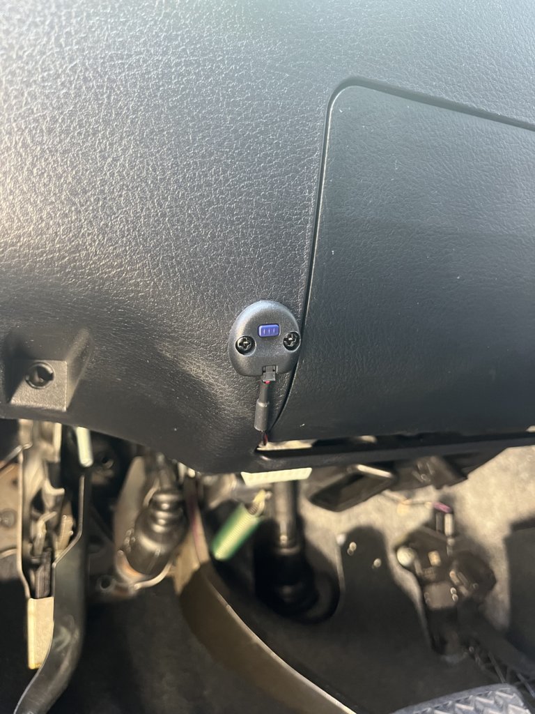

    What could this be? Should I disconnect it?

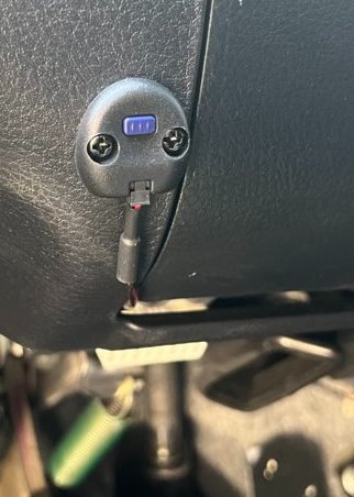

    Karr Security System Valet button is what Google images thinks it is.

    It’s the dealerships handiwork. They just preemptively install them I guess as soon as trucks hit the lot.

    I hate these kinds of aftermarket alarms. I always recommend removing them when I see them on fresh used cars at the shop. They damage the interior panels and when they fail (which is often) they cause loads of problems. Luckily they're super easy to remove. A bunch of wire taps, a ground and typically 1-2 wires they hardwire into
