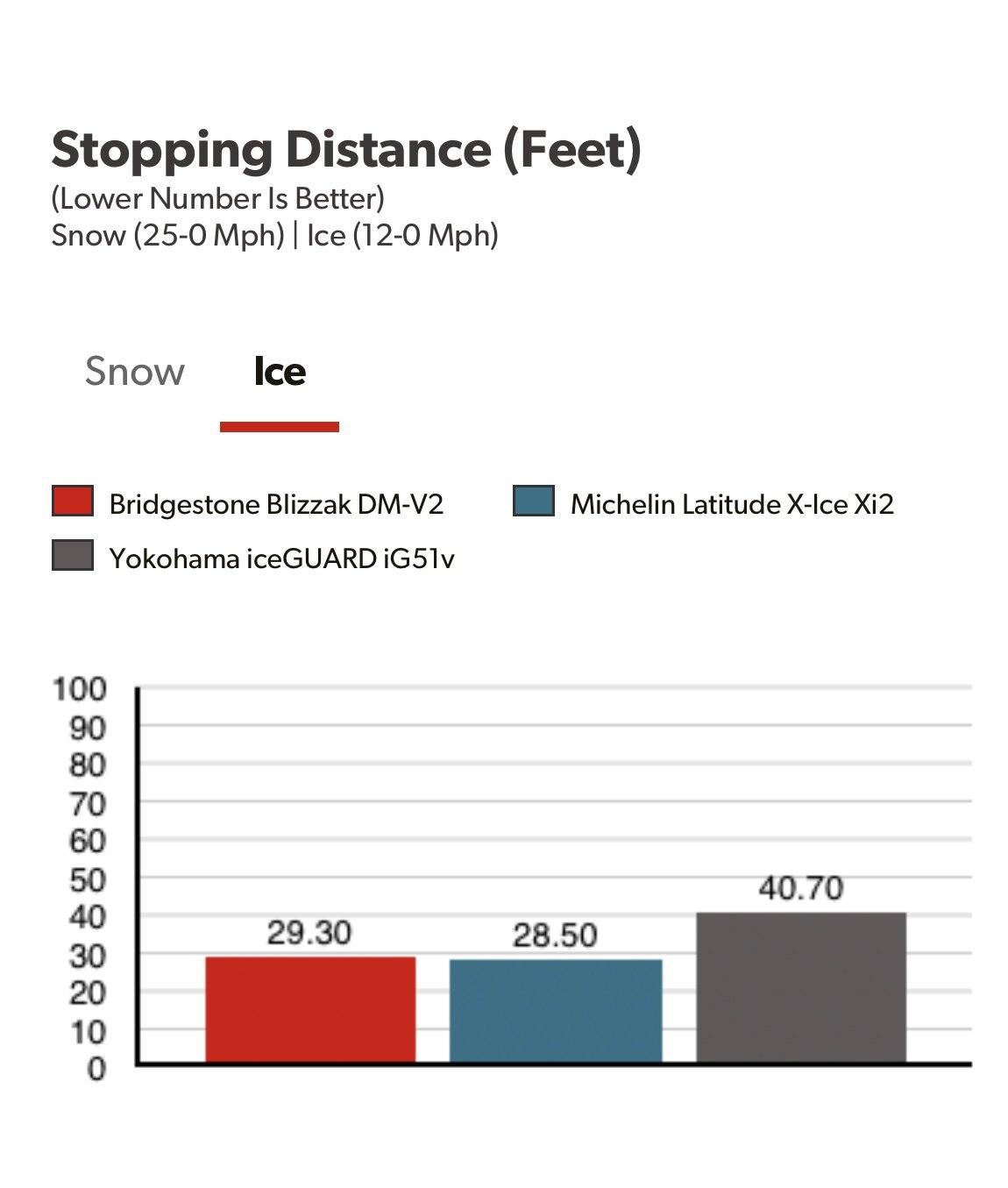

    First of all, KO2’s are extremely meh in snow. if you were going to run a single tire year round KO2’s would not be my choice. Duratracs or AT3W are a better winter all terrain
    Second, Blizzaks or other winter tires are fantastic. I have run them on my former GX460, just bought a set for my current LX570 and run Michelins X-Ice on my Chevy Bolt. The Bolt is fwd and gets around great with the X-Ice here in the mountains of Utah.
    Find a used set of Tundra wheels with Blizzaks. The ones I just bought for my LX570 were 4 Tundra wheels with some low mile Blizzaks for $400.
    Got my Chevy Bolt X-Ice with 3000 miles for $200 and then bought steel wheels off eBay for $250

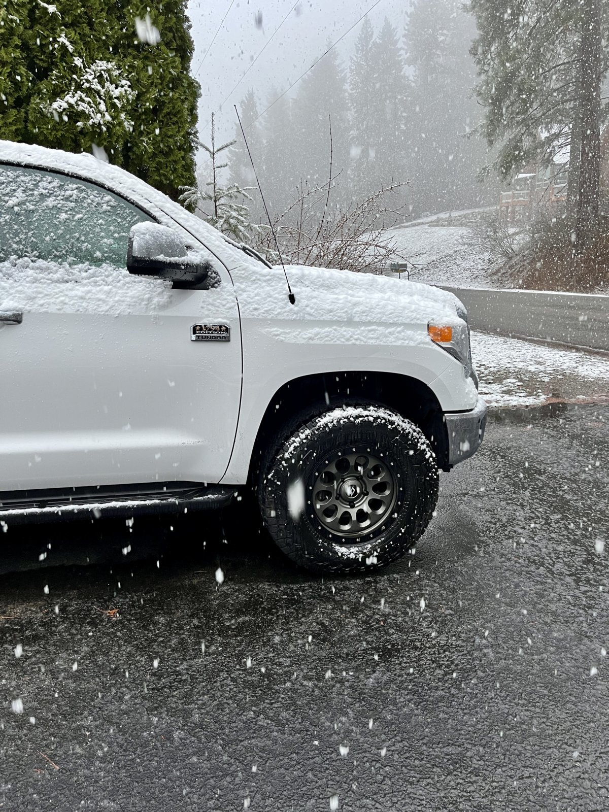

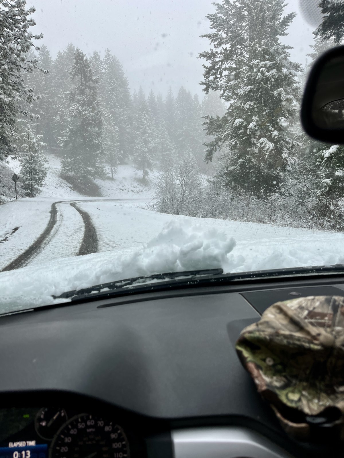

    I’m heading up into the snow this morning on my new A/T4Ws, I’ll give you a report :thumbsup: Took my X-Ice tires off too soon :)

    What kind of snow do you think we get here in UT? They dont call it the greatest snow on earth for no reason.
    Like I said, pick up a set of used wheels and blizzaks for cheap. $400 is not much money and its not like you don't get that back. The miles you drive on the Blizzaks are miles you are not driving on your other tires.
    Additionally, winter tires have benefits off of snow too. Their winter oriented compound improves traction in cold weather.
    Lastly, 4wd and LSD is only helping you move. They dont help you stop and turn. My mother in law insists her AWD Altima on all-seasons is fine for driving around here in UT but then we find out she slid half way though a red light into an intersection and almost got t-boned by a truck with our kids in the car.

    Wildpeaks did fine in the snow
    WHOO-HOOO!
