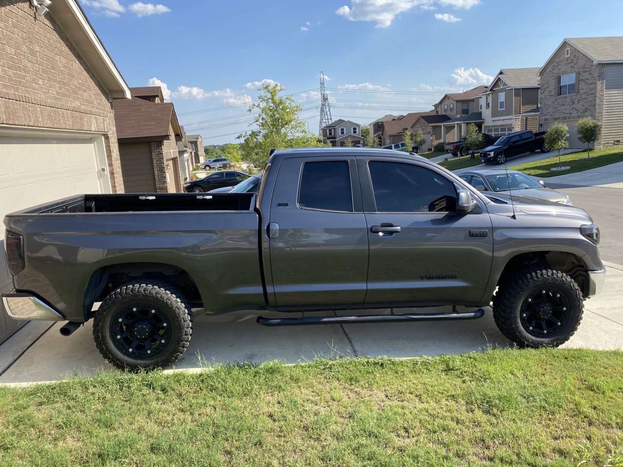

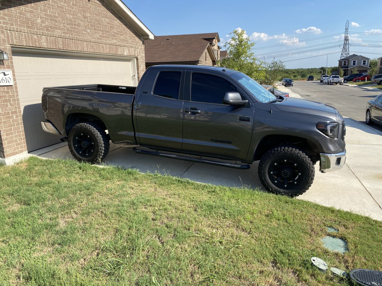

    Hey Everyone,
    I currently have a 15 RWD DC. I want to start overlanding and going off-road. Nothing super extreme but I would like to go on trails and some rough terrain.
    I also what to add a bedrack and tent.
    I currently have Bilstein 6112 and 5160 with Icon UCa and coachbuilder shackles on order.
    Im currently running 18inch rims with BF Mud-Terrian KO3 275/70R18
    Would this setup be enough or would I need 4x4?
    I attached pics of how it currently sits. Stock suspension with 3 inch spacers

    Just know the limits of your truck. Maybe think about a rear locker? And a couple traction boards.

    Not required. You can easily go down most trails and forest roads in 2wd. Anything more severe the tundra isn’t made for anyway. You won’t be rock crawling in a tundra. If you find something that’s difficult, you could consider an lsd or locker.

    Yes you need 4wd, it’s always better to have and not need it then need it and not have it. There’s a reason some trails say “4wd only”, there’s shit a 2wd just cannot do no matter how good of a driver you claim to be. Yes tundras have limitations because of IFS, length and width and no lockers but just 4wd will take you much farther than 2wd.

    You’ll be fine on rough roads. If it’s a lot of mud- avoid.
    Bring some recovery tools with u

    @Jalzate44 ok well in that case you can still do trails with 2wd just air down and have some recovery gear, know your limits and the trucks limits and you’ll be fine in a 2wd.

    As others have said, you just need to learn (and be aware of) the limits of your truck. Only one way to do that. With good tires and appropriate trail selection i bet your truck would be quite capable.
    I'd highly recommend some traction boards (such as MaxTrax). I've never had to use mine for my own truck, but have used them multiple times to get people out of deep soft sand with little effort.
    Also, good tow points / straps / soft shackles and preferably a buddy to help yank you out if you get stuck would be high on my list as well.

    Honestly stock suspension will do just fine with what you plan to do, if you want to upgrade do it right the first time. I went with Kings and I love em, well worth the money
