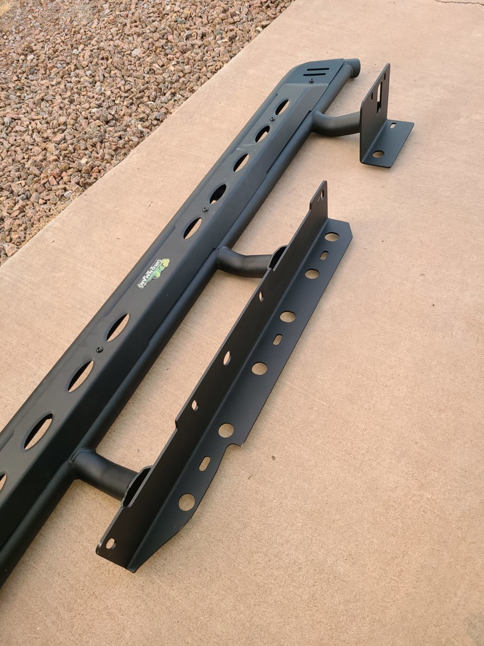

    Don't cut into those. They should be 100% bolt-on. Unless they sent you the wrong ones. Do you have a picture of the sliders? There are no holes to accommodate those?

  7. Nov 8, 2021 at 5:27 AM
    wexttxco
    wexttxco [OP] New Member
    Sep 8, 2021
    #67778
    591
    21 SR5 DC 4x4
    Fox 2.5 RR, 35x12.5r18 x3 on method 701, armor, front bumper
    That's how they seemed to bolt up but I'll flip it around and try the other one.

    Looks like they should bolt right on, have you tried it on both sides? And they still don't line-up?

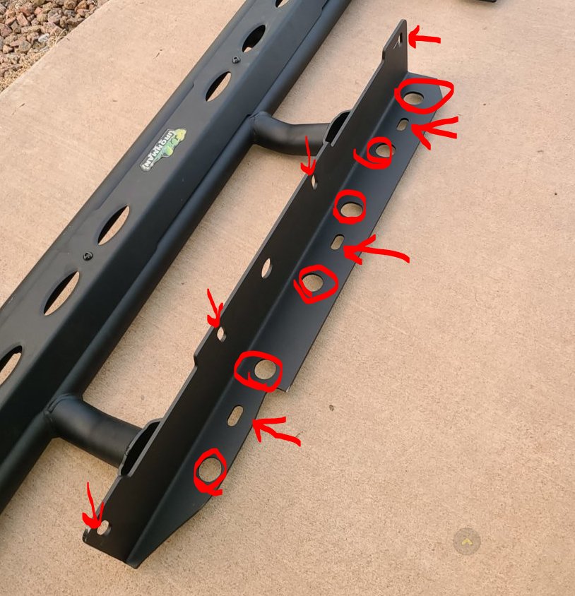

    Those rivets go in the circled holes. You're bolts will go where the arrows are.

    Different brand, but just as @AzureNightmare said above. See the rivets sit in those large holes.

    Thanks for the info fellas, one moment and I'll swap them around and see what it looks like

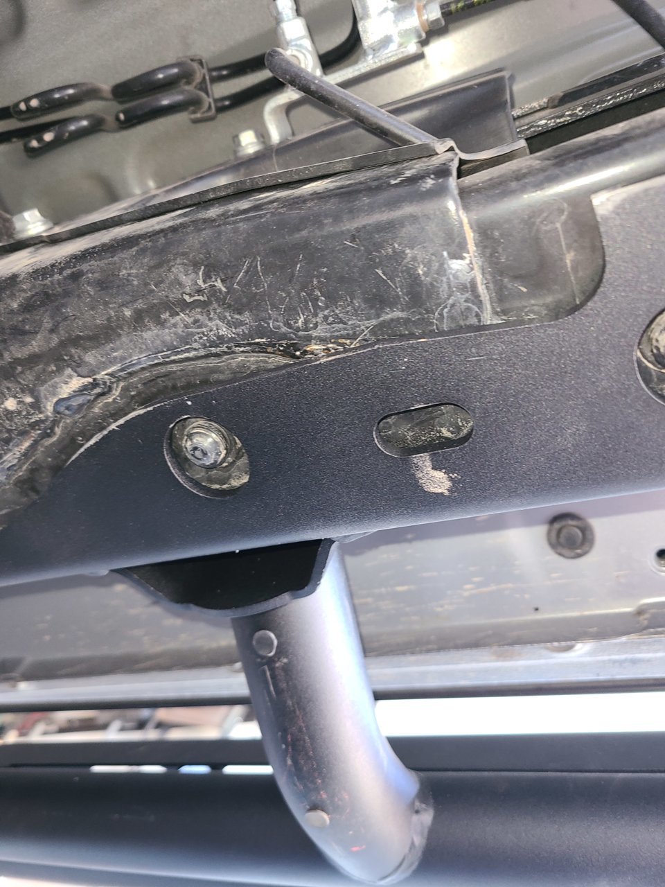

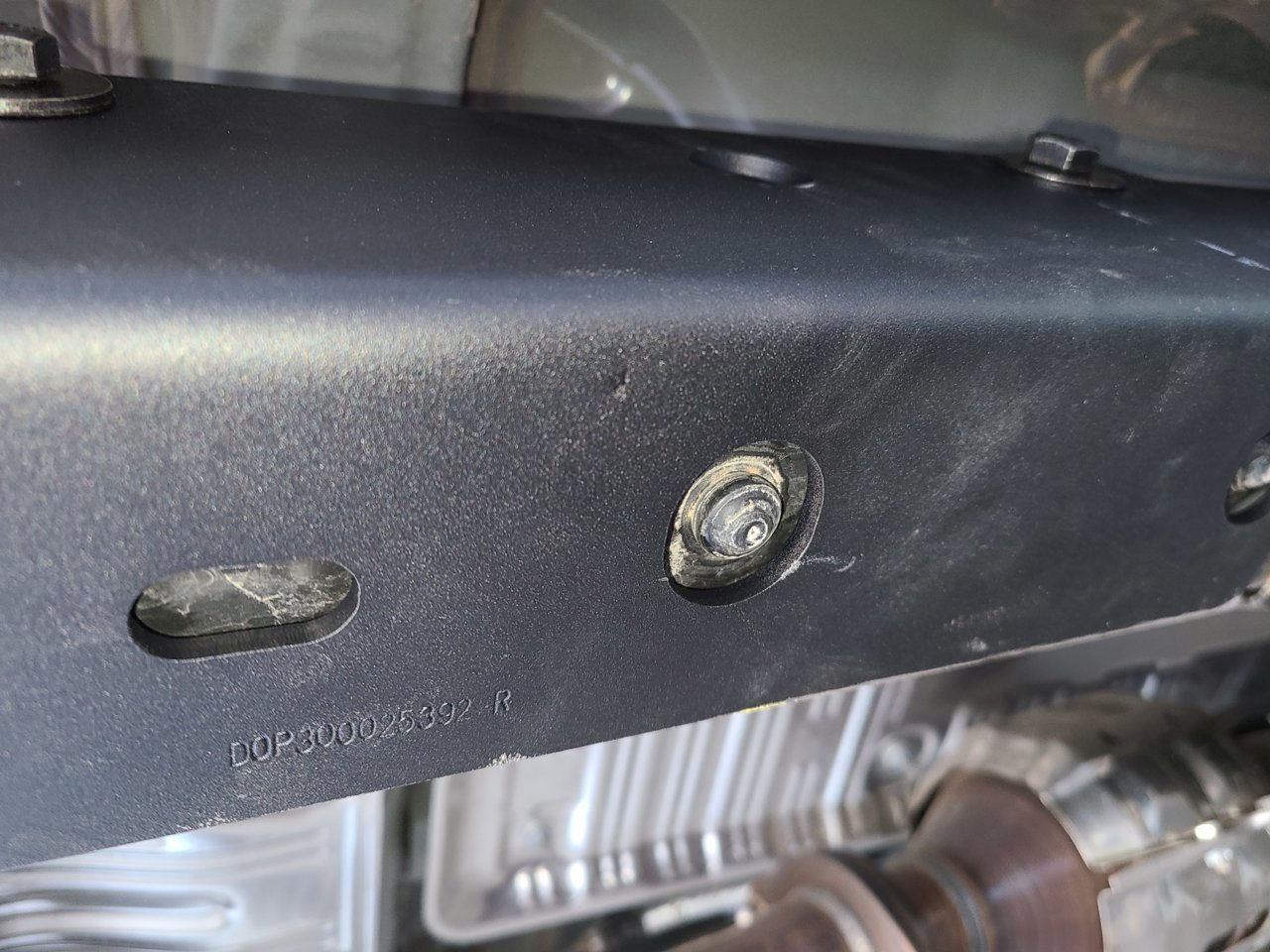

    Got them held in place.
    Turns out you have to drill into the frame at 6 spots. In spite of what the description says. Assholes. Screenshot_20211108-092650_Firefox~2.jpg

    Not only do you have to drill, the contour isn't even right so I have to grind the sliders if I even want to drill.

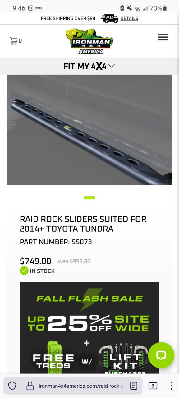

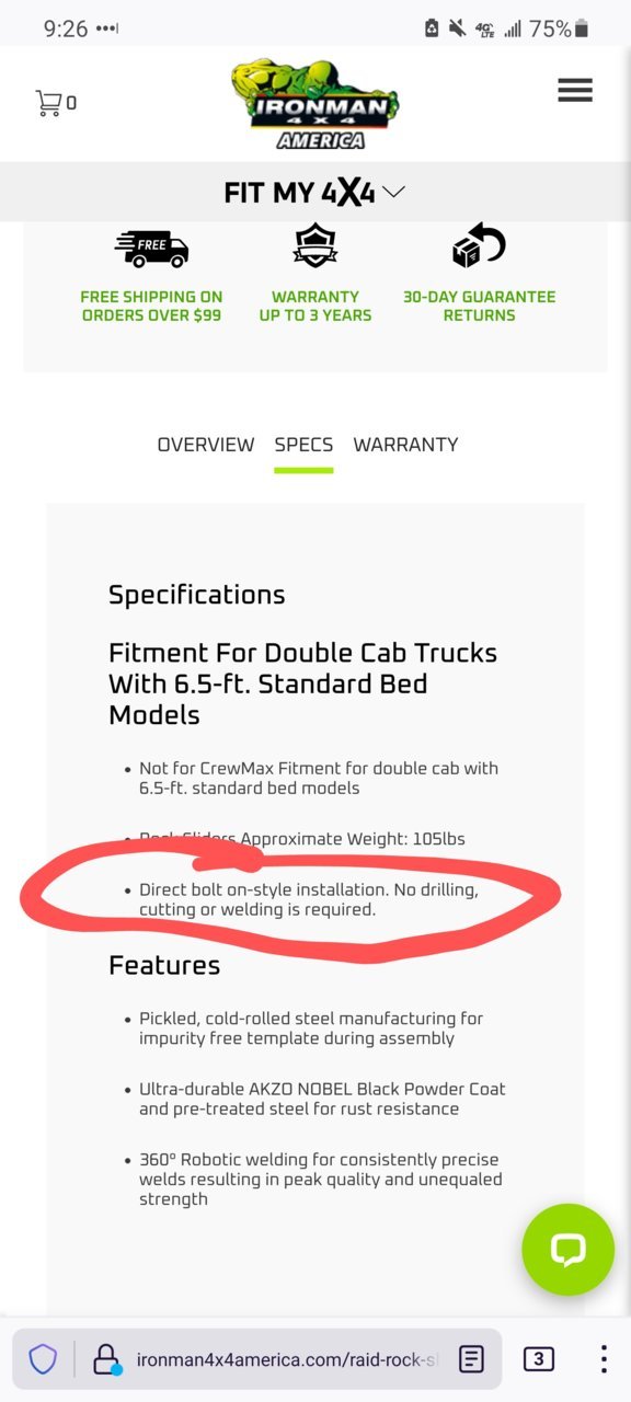

    Screenshot_20211108-094635_Firefox.jpg only states 2014+ here. They screwed this up. 2 days before my trip with no time to fuck around with it because they were "bolt on"

    There are no holes on the bottom, so any upwards pressure on the sliders would try to peel away from the frame and shear the bolts unfortunately. No holes on the bottom work.

    Most holes and bolts match up. Bolting to the frame from the sides sides zero holes on the bottom in the frame (4 were supposed to bolt to the bottom of the frame).

    However, any sliders (other brands) all are 2014+

    The low price, lack of pics, and no instructions makes me suspect if these would hold up as a slider in the first place. You cannot tell how they attach or how many supports they have on the website. Also, you cannot see how the supports attach to the plate you are mounting to your frame in any pictures. I'm not sure I would trust these to protect from anything.

    Seems like it may be a bit of sleazy marketing. They "bolt on" just fine, but won't actually function as a slider without drilling.
