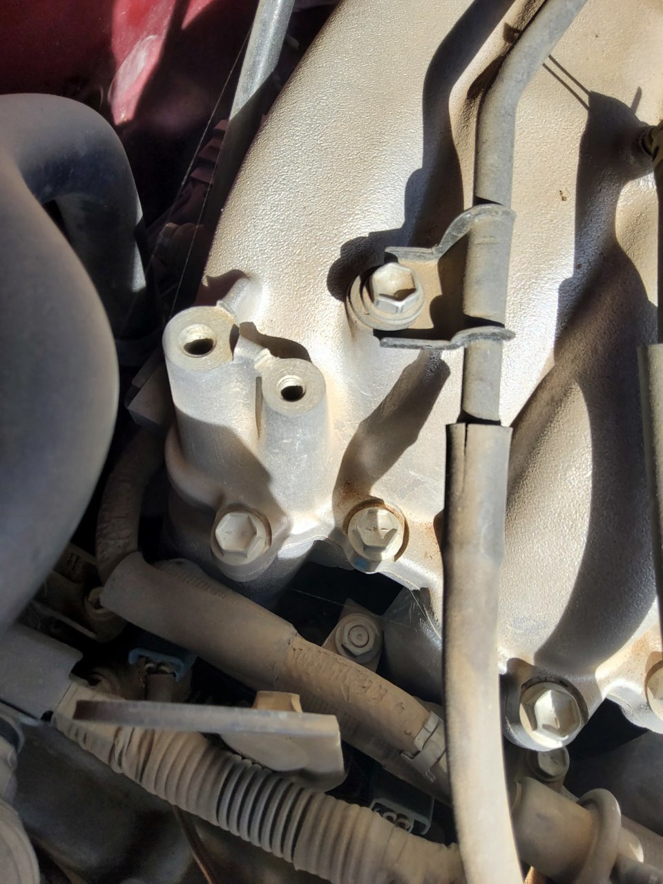

  18. Oct 8, 2021 at 9:20 AM
    bmf4069
    bmf4069 [OP] Michelob Ultra coinesour
    Sep 1, 2018
    #18880
    9,548
    Beau
    TX
    02 AC sr5 4wd v8

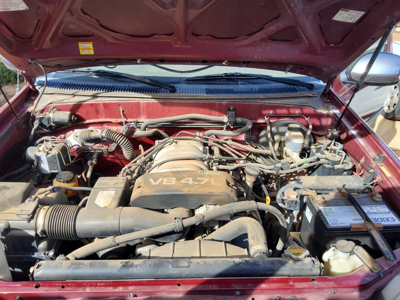

    Truck sits for a week at a time, though it's gonna be a DD now. It's been progressively getting worse. It's definitely not rhythmic, and it does go up and down, but not much. The tach doesn't even register it.
    There's no fuel around the injectors or fuel smell.
    I'm leaning towards this. I popped the hood when I got home a while ago and snapped some pics.
    I did notice oil around my PCV valve, even though I cleaned my VCs when I did that gasket job. It's sitting at a funny angle too. I can also hear what sounds like a vacuum leak from under the intake, but iirc there's no lines under there, and I torqued it down to spec when I put it back on.
    Also, we were talking about clean engine bays the other day. Yeah.....

    A can of carb cleaner should help track down a vacuum leak. Spray around where you hear the hissing, if it is a vacuum leak the rpms will increase when the leak pulls in the carb spray.

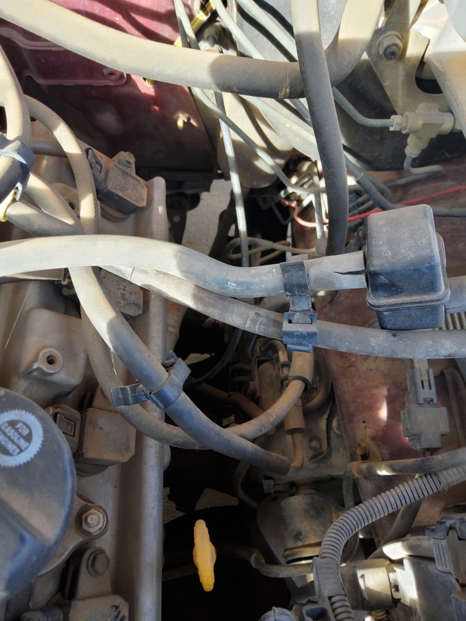

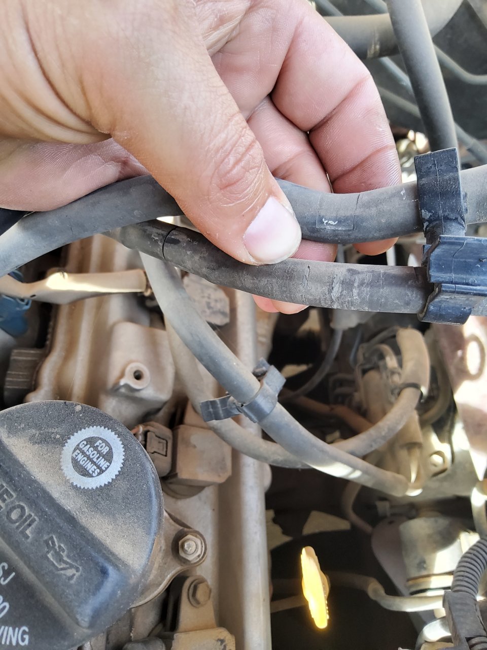

  23. Oct 15, 2021 at 10:25 AM
    bmf4069
    Sep 1, 2018
    #18880
    9,548
    Beau
    TX
    02 AC sr5 4wd v8

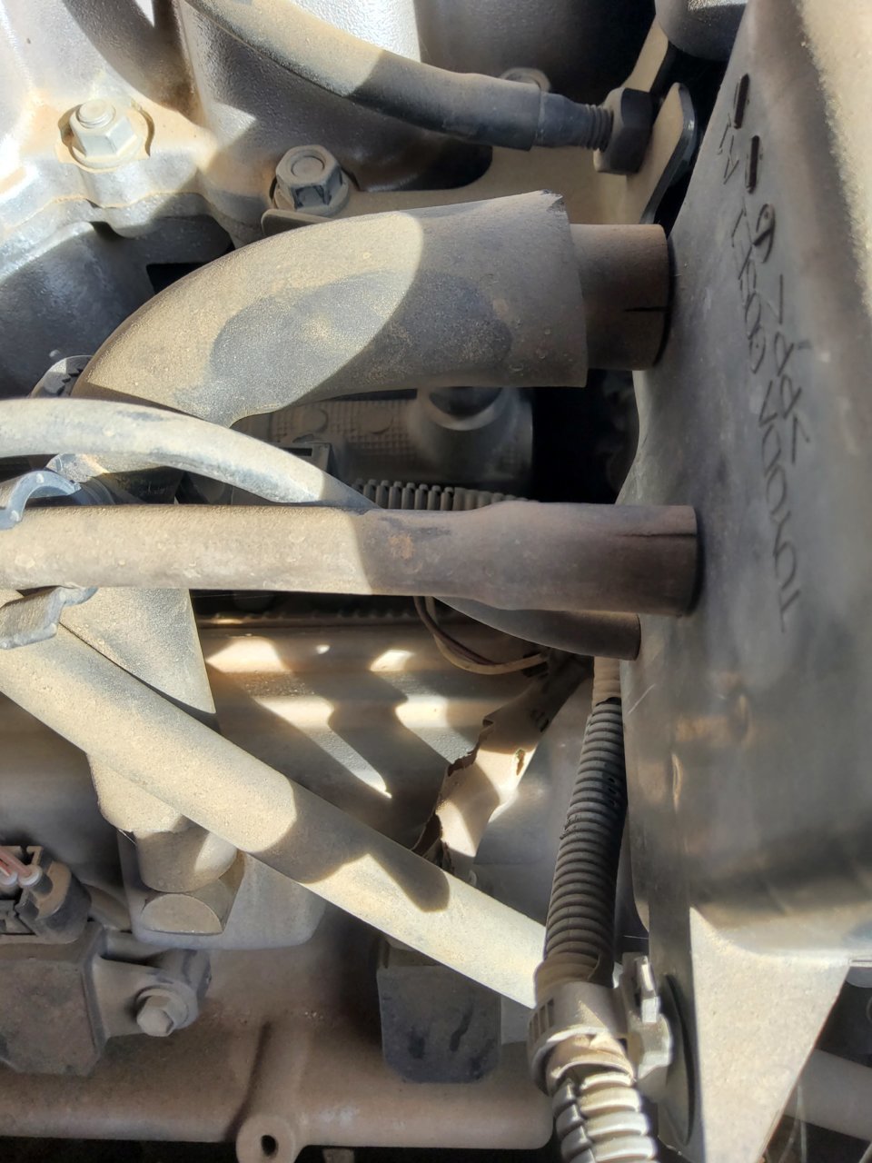

    New vacuum hoses ordered thanks to @Tundra2. Ordered the kit he recommended that has an assortment of sizes in various lengths.
    FrenchToasty and Sirfive like this.

    Didja try to suck&blow any of the ports on that evap box thing?
    bmf4069[OP] likes this.

    a little grease should seal to get it running right if its just cracked hoses. Maybe the evap thing had some settling that fouled a seal or stuck a valve. I dont know, i do my best to try to remove as much emmision equipment as possible.
