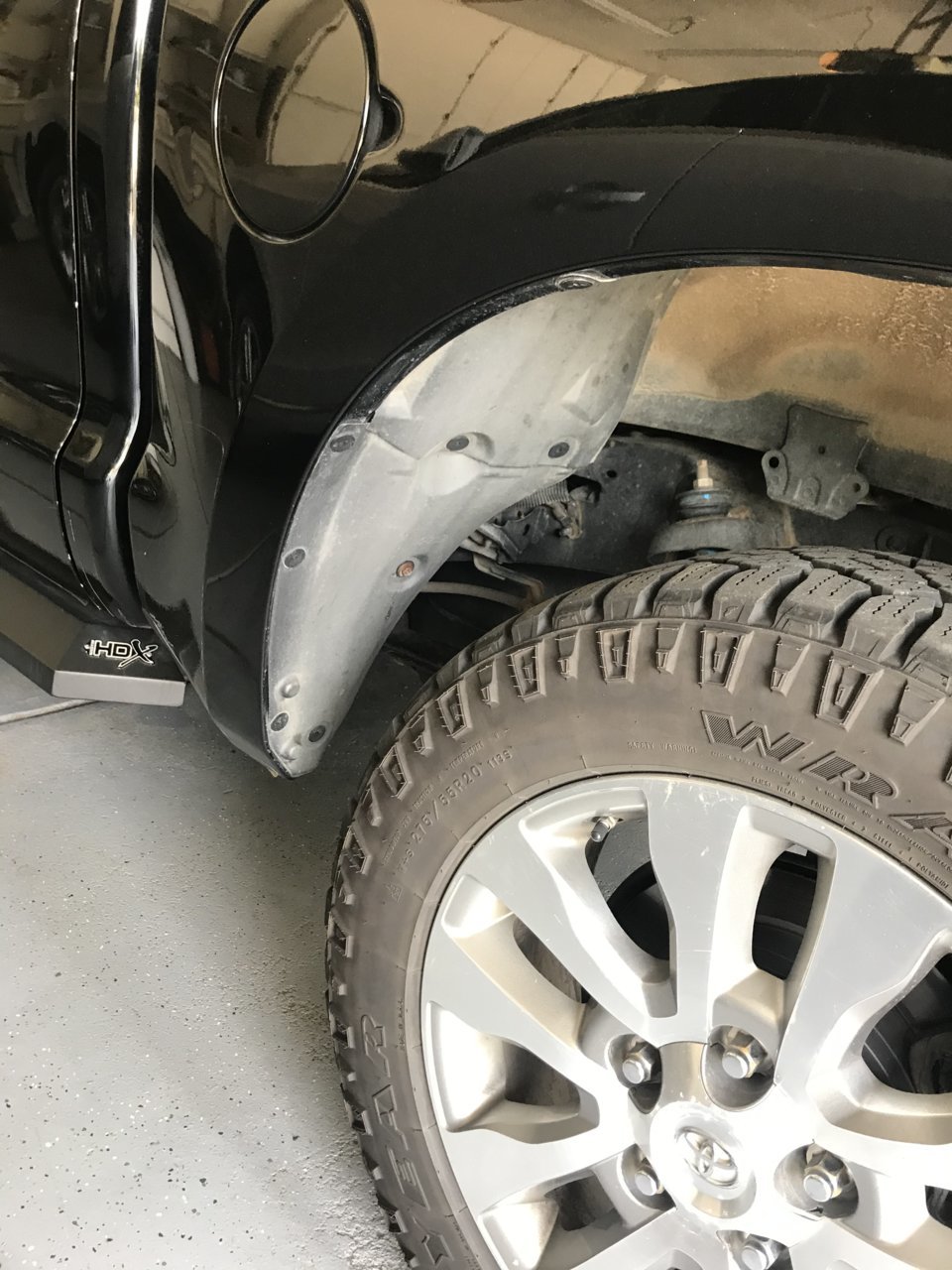

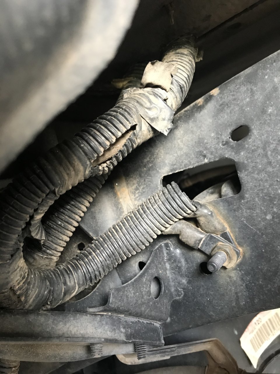

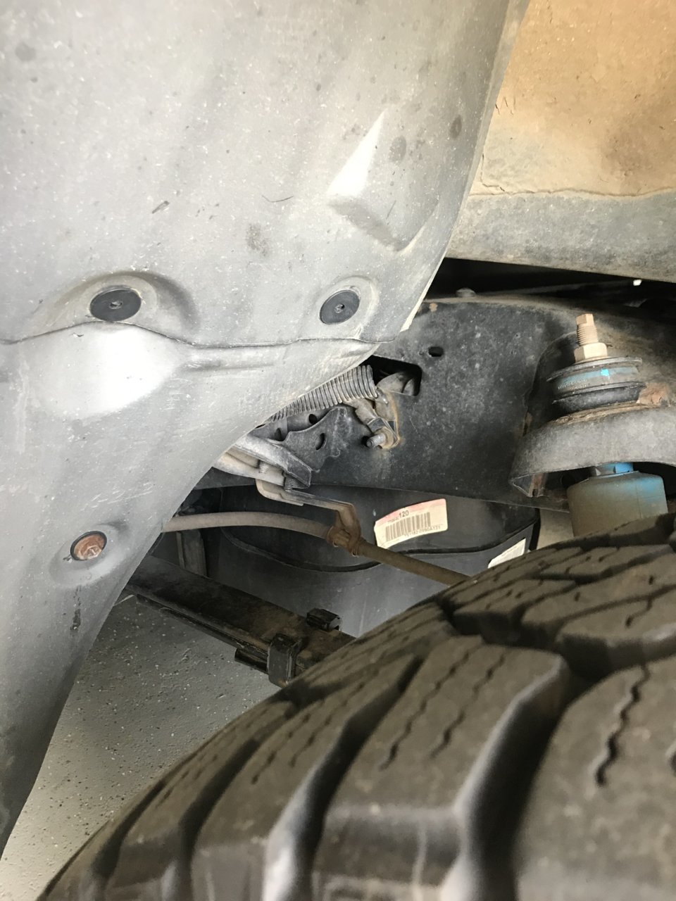

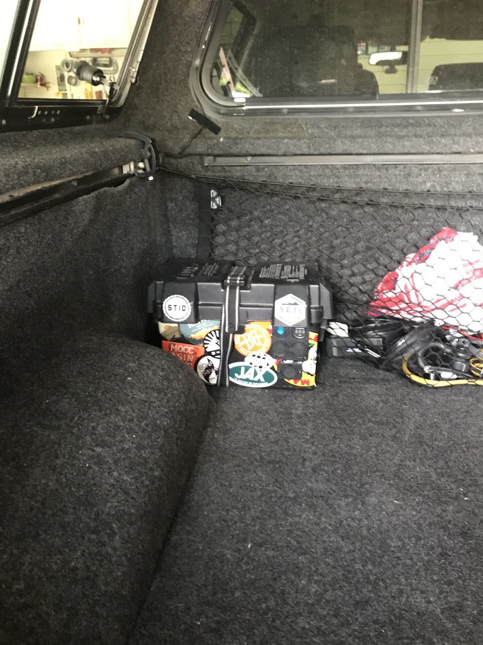

    My second battery is grounded to the frame, no issues. It exits my battery box through the middle center of the box, otherwise I’d take a pic. It was super simple to reach my sander in there, mount the negative cables, then spray paint...16DF5B42-A89F-487A-A465-C9B143030EC2.jpg22E6611A-3ADA-4970-AF5A-865F4CE9A528.jpg 1CC11BFC-C04B-49EF-B7E5-3F7637337F85.jpg35273554-1CF8-4F7D-959F-8FA0B3FD63FF.jpg

    that's what i needed. so you sanded, mounted the ground then painted over everything?

    Exactly, it was a 20 min affair, I added a few coats of paint over the following days. Think I prolly threw a coat of sandable spray primer as a first coat. Used matte black paint which eventually blends in to a perfect match w/ frame
