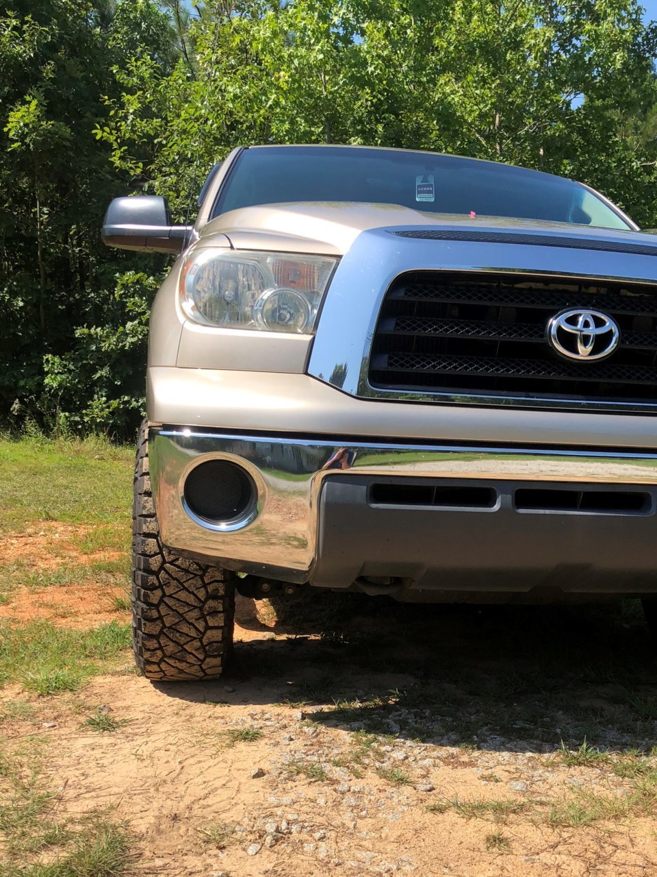

    Welcome, and you want to stick around +25mm offset. I have a 2nd gen 2008 with a 2" spacer and 275/70/18, which are about an inch shorter than what you are going with and a little narrower. Here is a picture for reference with height and how it sticks out. The +25mm is around the sweet spot.

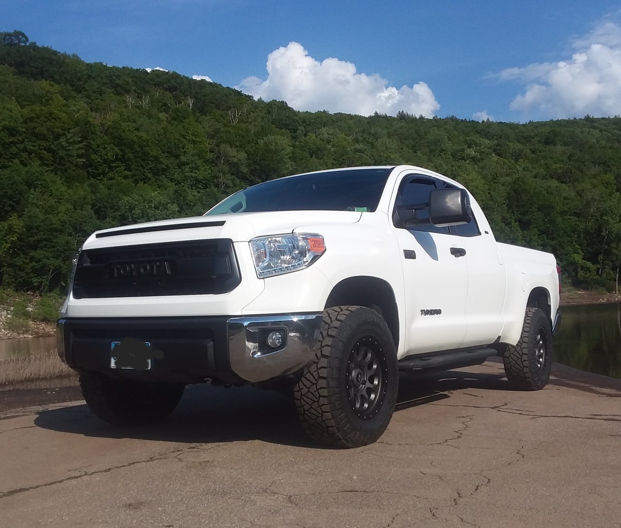

    Welcome from CT. I'm running 285/70r18's on Scs ray 10's that are +25 offset and I believe 6" back spacing. Bilstein 6112's set at 1.9" with a driver side shim. Hope this helps you out. 20180621_205120.jpg

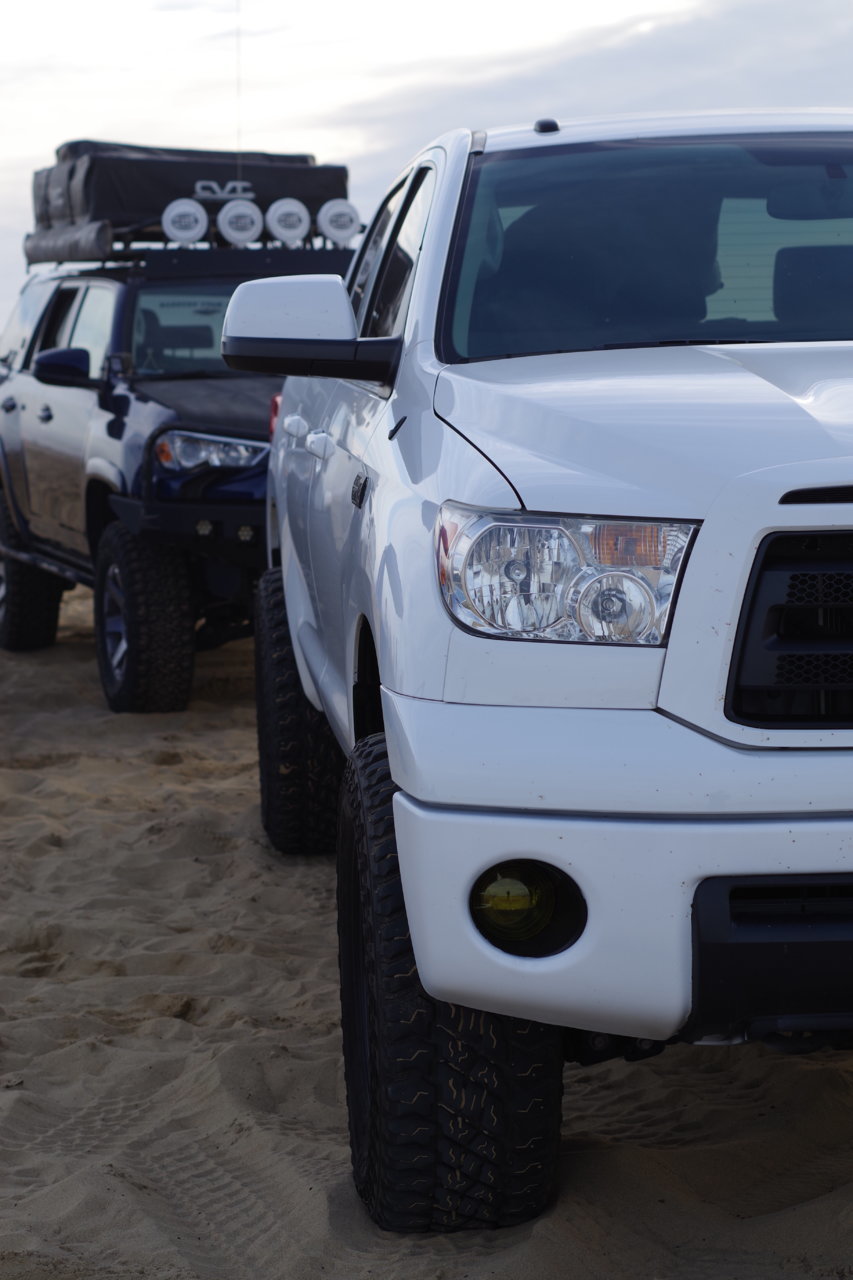

    5EA9C0CF-EC6C-4F69-8D47-2A72F03A0407.jpg 7DDFBD03-4BDB-4E60-9A7D-B242E5458755.jpg 295/70/18
    18x9 +12 offset
    Lifted 2.75 in the front.
    Had to do the fender liner mod to keep from rubbing.
