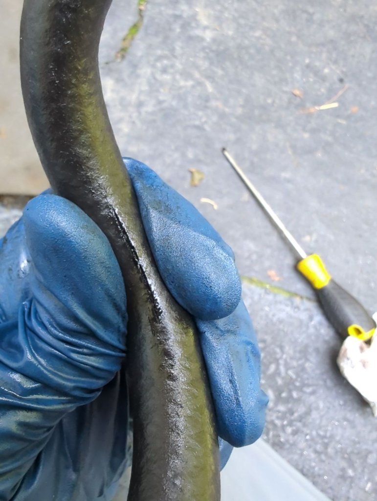

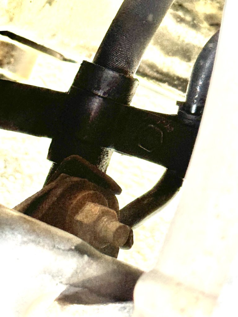

    About 4 months ago noticed PS fluid was low so I topped off reservoir. Seemed to be holding level until yesterday when I noticed it was low again. I added an ounce of AT-205 and about 6 or 7 ounces of PS fluid. Noticed the lines and the rack were wet so I took it to the car wash and washed off the rack and the hoses. After I got home I put it up on ramps. The pump and rack are dry as a bone but the high pressure hose had a drop of fluid where it’s clamped to the frame near the passenger side motor mount. Anyone ever seen a leak here?

    I replaced the rubber hoses on the low pressure side three years ago. Leak seems to be high pressure hose.

    Mine appears to be only the high pressure hose. The Rock has a Gates hose 365851 for 125 which looks good. I think I’ll try that.
