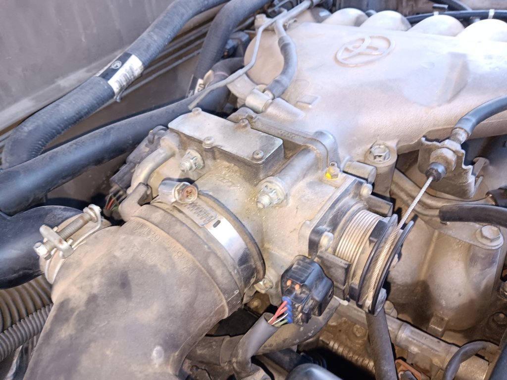

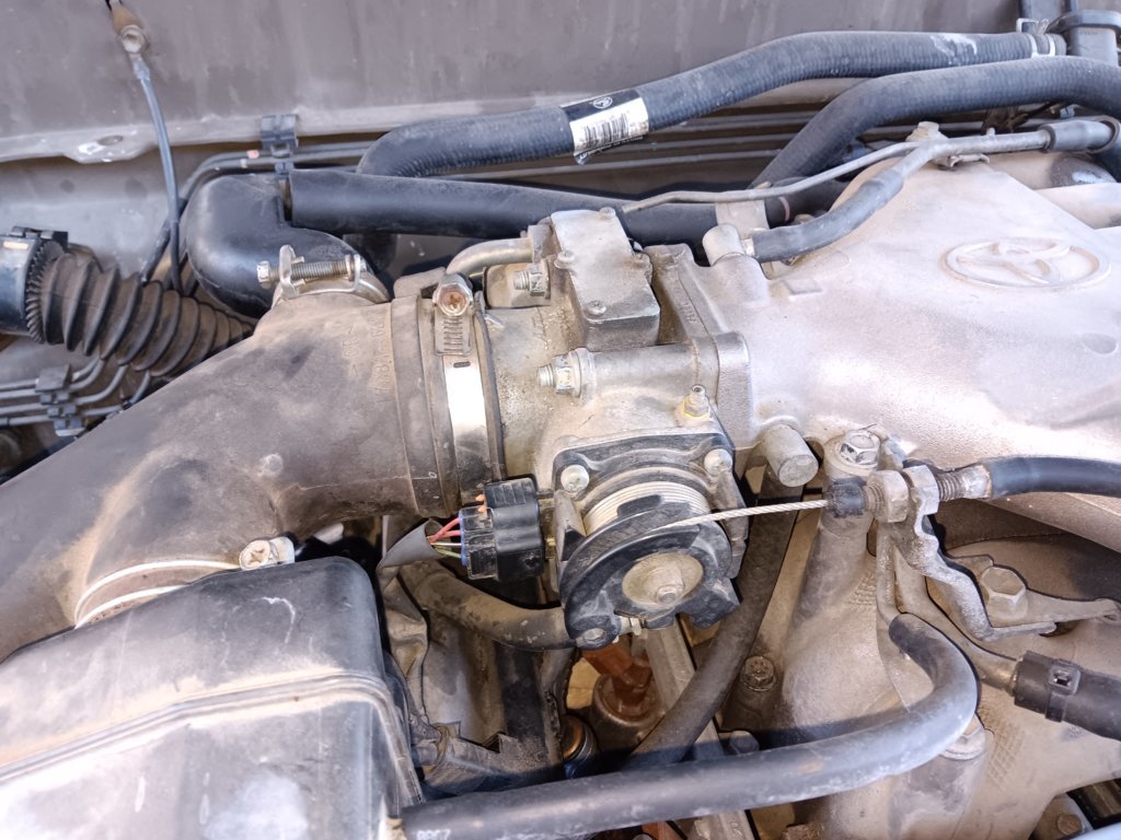

    Can you send a good pic of what the throttle body looks like on your truck? I have a hunch.
    The throttle bodies on the pre-VVTi V8 trucks (00-04) have this weird system where they are "drive by wire" for the first 2/3 of the accelerator pedal's travel. Even though there is a cable going to the throttle body, there is no physical connection between the pedal and the throttle valve until you reach that 2/3rds of the travel. Then it mechanically kicks in. I'm not sure why toyota did this- but I'm guessing for idle control via the throttle body, and cruise control. I wonder if the issue that we've both experienced is related to this system.
    With the truck off, if you push the accelerator pedal with your hand, does it get harder to push around 2/3 of the way down? This could be indicative that it's got a similar system.

    I appreciate the explanation. It sounds like that's worth a try. Perhaps I got an aftermarket filter that slowly got more clogged.

    Yes, it's almost entirely non-resistant or slack until about 2/3 of the way down. It reminds me of taking up slack on a trigger.

    Hmm. It does look like both the V8 and V6 have a similar system on the throttle body.
