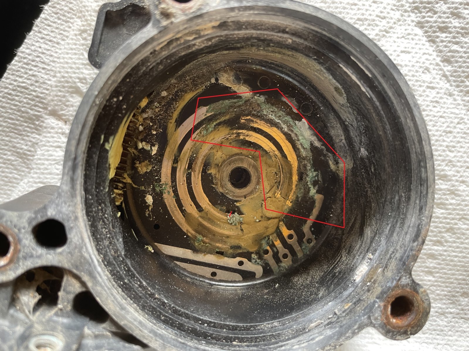

    I had both 4hi and 4lo lights flashing at all times with no other noises or problems related. I couldn't hear the actuator working when pushing any buttons either.
    I went straight to cleaning removing and cleaning the transfer case actuator and it was more corroded than the video. I was able to clean the metal contact strips with sand paper and steel wool and then apply dielectric grease on everything. And this fixed both flashing lights!001.jpg

    FWIW there's a small hose attached to the actuator that looks like a vacuum line, but it's not...rather it's a vent hose. If it's loose or craked or missing altogether that's the pathway by which all that schmutz gets inside.

    Make sure the vent tube is intact and not cracked to shit. That thing cracking/falling off is the #1 cause of crap getting inside to corrode stuff. That, and people who can't RTFM to understand they need to engage 4WD every so often (Toyota reco's 10mi/month, IIRC).
